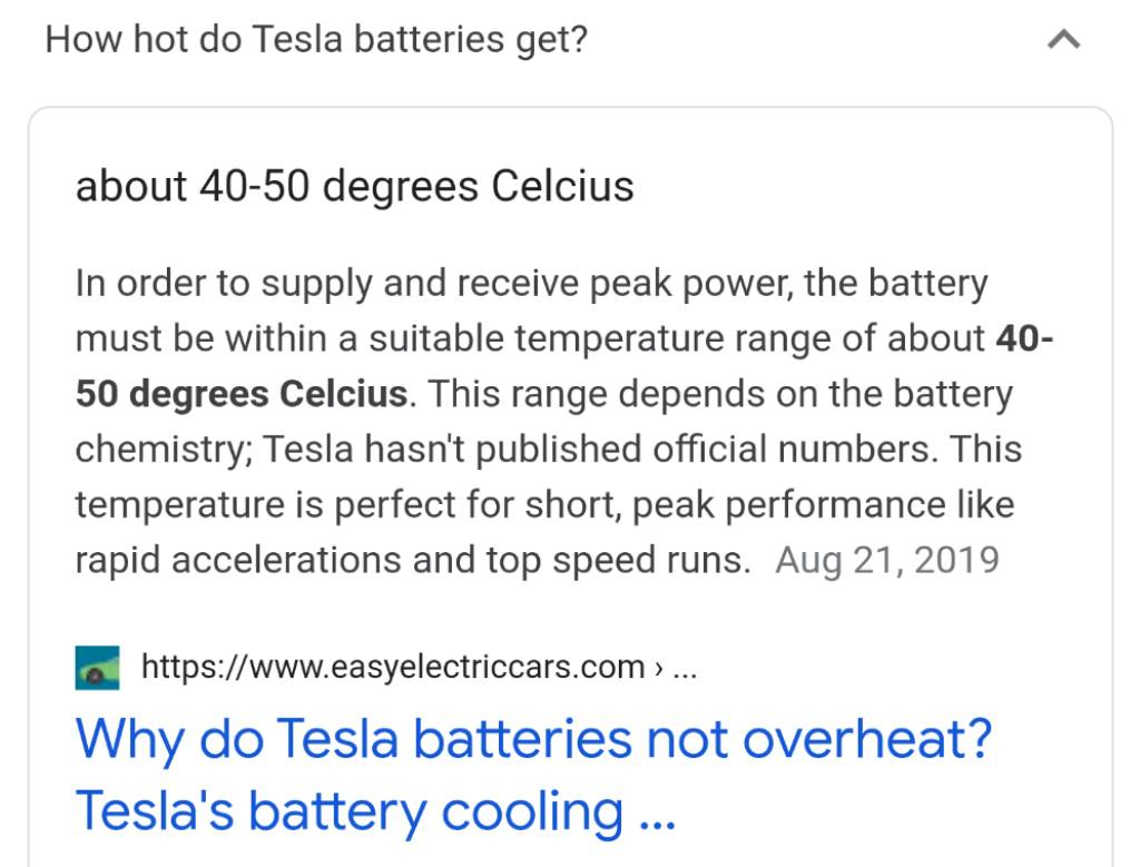

What is the temperate rang? My garage is usually 90˚F - 105˚F during the summer months and cools down to 80˚F - 90˚F at night.
Would I have to A/C the garage?
Caveat - I'm definitely no expert.
I found this informative piece: Why do Tesla batteries not overheat? Tesla's battery cooling system. - Easy Electric Cars
Basically, a hot garage in the summer is fine.
When powered (plugged in or in use), the car's management system will keep the batteries in a good temperature range.
Assuming they don't catch fire, of course...
A Tesla will heat or cool its battery as needed even when parked.

Looks like the optimal temp for the batteries is 80F. No wonder they are building the new Tesla factory down the road instead of Michigan.

Tesla's have a glycol system that flood the cells which depends on if it needing heating or cooling it heats it up with a heat pump when needed to be warm. Charging lithium below 32 F will damage any lithium battery, the BMS (Battery Management System keeps everything in check on those parameters along with charging parameters
   / Battery based electric vehicles of today and tomorrow. #1,787
Only the newest Teslas have a heat pump. Until recently resistance heating was used.
