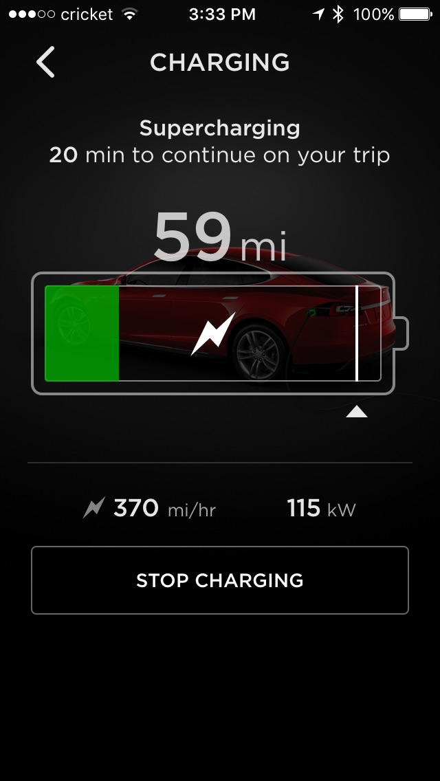

CHAdeMO is rated for up to 500VDC and 125A, 62.5 kW. LEAF has a 400V nominal system for 50 kW. When Tesla built a CHAdeMO adapter they had problems with chargers not behaving per written spec, but according to what a LEAF would allow.
Tesla also DC charges are nominal 400V.
This is a screenshot of the a Tesla app during one of my supercharging sessions. Is running 115 kW at that moment. It tapers down to 60 kW or so with 200+ miles of range in the battery.
