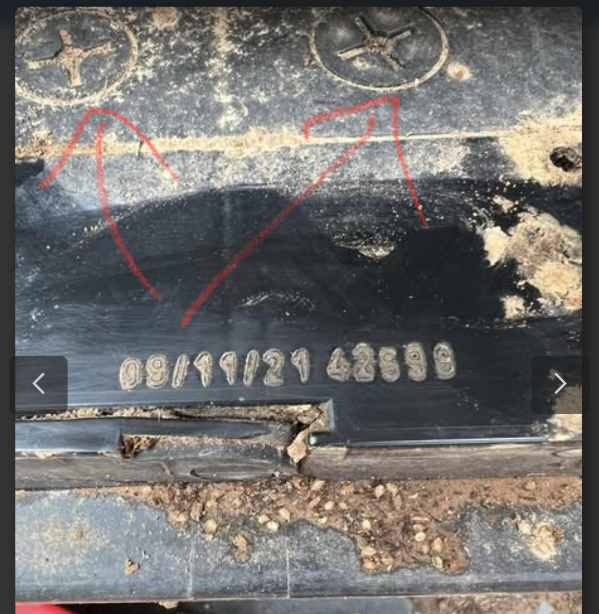

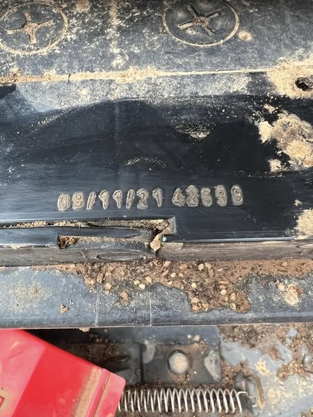

My 2022 Massey Ferguson 4707 tractor has a dead battery. The date of 09/11/2021 is on the battery, so I'm guessing that's how old it is.
I bought a battery for my wife's van last month, and the guy at NAPA said that batteries only last 3 years on modern cars because of all the electronics on them that never turn off. Her battery was 3 1/2 years old. It looks like my battery is just over 3 years old.
Does this make sense to everyone? I used to get five years out of a battery, and sometimes in older vehicles, even longer. 3 years just seems like it's too quick to die and need replacing.

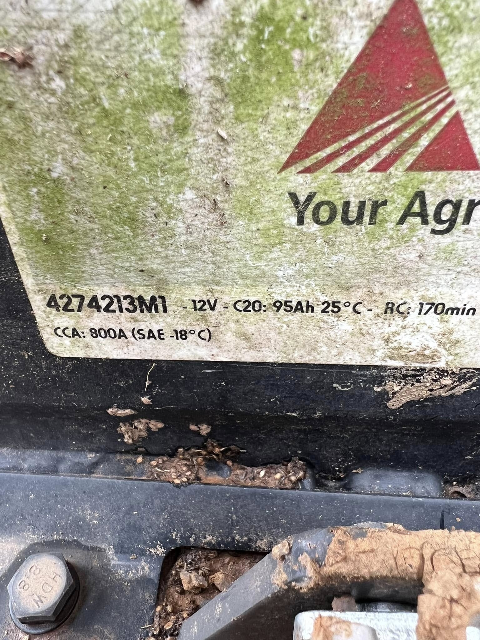

I do not want another Massey Ferguson battery. I'll go to NAPA and see what they have during the week. Before I go there, I'm curious if this label makes any sense to you?
I haven't removed the battery yet. I should do that now, but it's too cold out there, and I'm going to work on my fence first.
Is there something that I should ask for when I go to NAPA to get a better battery?

If you take the battery in, they can match it up. if you measure the battery tray and height, you may be able to get a bigger one.
/ Battery Info #4
You need to know what BCI group (design) your battery is so the shape will fit ok. Your old one is 800 CCA which is how much ummph it has.

I typically buy most of my batteries at Sam's. High turnover, so no old batteries on the shelf. The RC 170 is a rating for reserve capacity. The CCA is cold cranking amps. The most of both is best.
