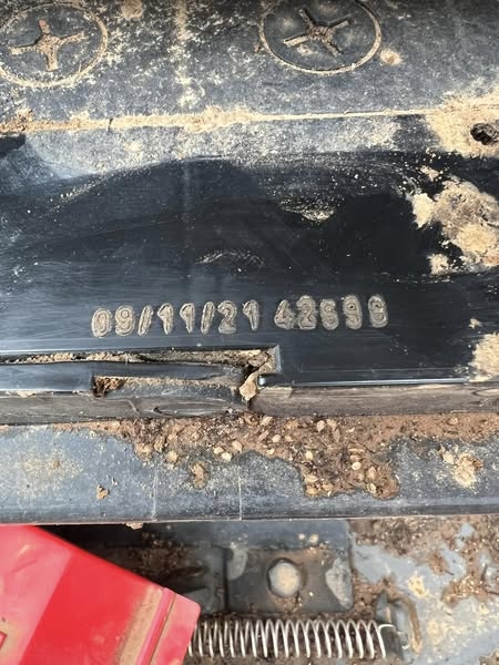

My 2022 Massey Ferguson 4707 tractor has a dead battery. The date of 09/11/2021 is on the battery, so I'm guessing that's how old it is.
I bought a battery for my wife's van last month, and the guy at NAPA said that batteries only last 3 years on modern cars because of all the electronics on them that never turn off. Her battery was 3 1/2 years old. It looks like my battery is just over 3 years old.
Does this make sense to everyone? I used to get five years out of a battery, and sometimes in older vehicles, even longer. 3 years just seems like it's too quick to die and need replacing.
I do not want another Massey Ferguson battery. I'll go to NAPA and see what they have during the week. Before I go there, I'm curious if this label makes any sense to you?
I haven't removed the battery yet. I should do that now, but it's too cold out there, and I'm going to work on my fence first.
Is there something that I should ask for when I go to NAPA to get a better battery?
Batteries are like anything else. You get good batteries and not so good batteries from all manufactures . This is my opinion at least. I've had batteries die within several years and others seem to last for years. I just run them till they die and replace. I have better things to do besides running around trying to find the "perfect" battery.

Eddie get the biggest CCA battery u can.
The more the more heavier which is good
Don’t know how it is anymore but if u bought a six yr battery it would have more cca an heavier.

The main killer of lead acid batteries of any vintage, has always been sulfation due to allowing the battery voltage to get to and remain below 11.0 V. You may be able to revive that battery using a desulfation charger. These are often called battery rejuvenators.In any case, make sure to keep your lead acid batteries fully charged year-round. My tractor battery is now 11 years old and still going strong. The start batteries in my bulldozer are now 16 years old.

My NAPA Legend AGM battery is a DEKA. That's why I bought it. It was expensive.
/ Battery Info #59
Well….most napa batteries are deka…that is to say both are made by east penn mfg.
I was told East Penn makes different grades of batteries (like good, better, best, etc) and the Napas were the lower end. Deka was better/best
/ Battery Info #60
" the guy at NAPA said that batteries only last 3 years on modern cars because of all the electronics on them that never turn off. "
Couple of things
1. Opinions are like **** orifices - everyone's got one.
2. Branding is not equivalent to manufacturing.
3. Manufacturers and vendors may lie about product features without legal consequence.
4. A single manufacturing facility may produce dozens of uniquely branded items off a single assembly line.
5. Vendors may purchase the rights to use a famous "brand" name on a product manufactured for them by a third party. e.g. Home Depot licensed the 'General Electric" name to 'brand' water heaters made for them by some company in TN.
The battery in my 'modern' five-year old car is the one the car came with (Knock on wood). The battery on my Kubota B7800 lasted over five years, but the Interstate battery I replaced it with did not. Now using a Walmart battery in it (crossing digits).
