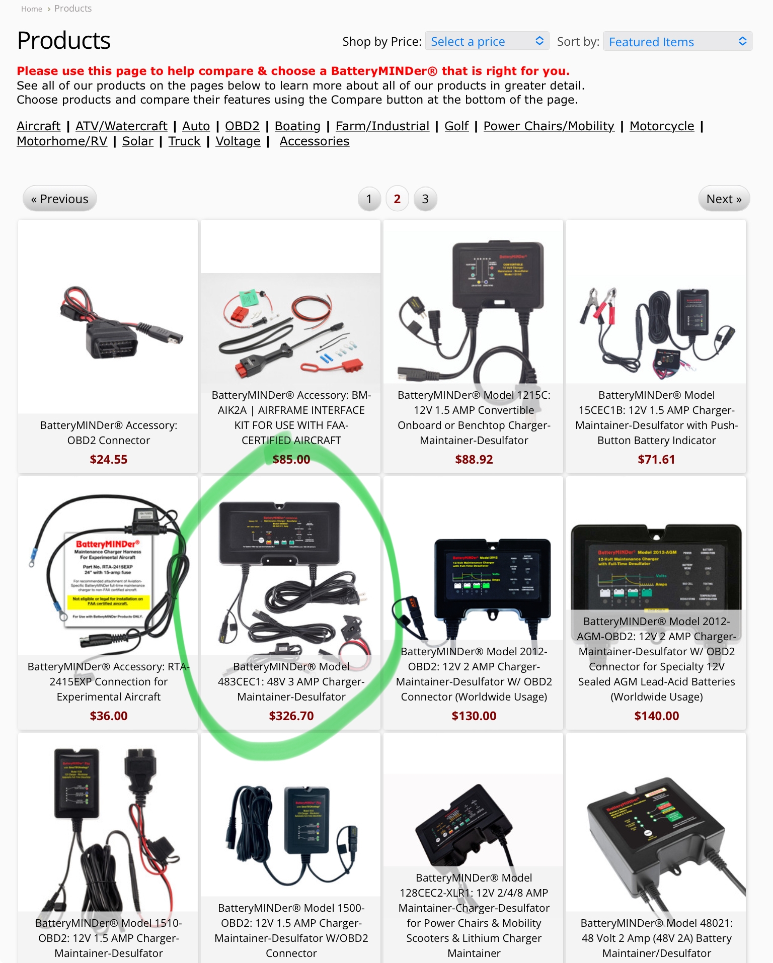

RjC, Where did you find a "48V" batteryminder charger? I looked on their website and none were listed? Heck, I'd like to even find an 8 volt charger for individual golf cart batteries and can't find any anywhere! Is there a trick/secret to searching I'm unaware of? Thanks, Greg

Click here for 48V BatteryMINDer chargers
Its hard to find 8 volt chargers from reliable, well-known manufacturers. The only one I've found from a "big name" manufacturer is a BatteryTender 8V, 1.25 Amp charger/maintainer. Battery Tender is not my first choice of manufacturers, since they are neither temperature compensated nor do they have a desulfation feature. However, they do have a reputation for making reliable units that won't cook your battery by overcharging even if left on for extended periods (and if you KEEP your batteries fully charged, desulfation is far less of a concern.)

It's on page 2 of their products section.
Even at just 3 amps, it charges my cart overnight for my average usage. I haven't used the 20 amp OEM charger much at all this year.

Thanks for that RjC! I didn't scroll past page one - silly me!
