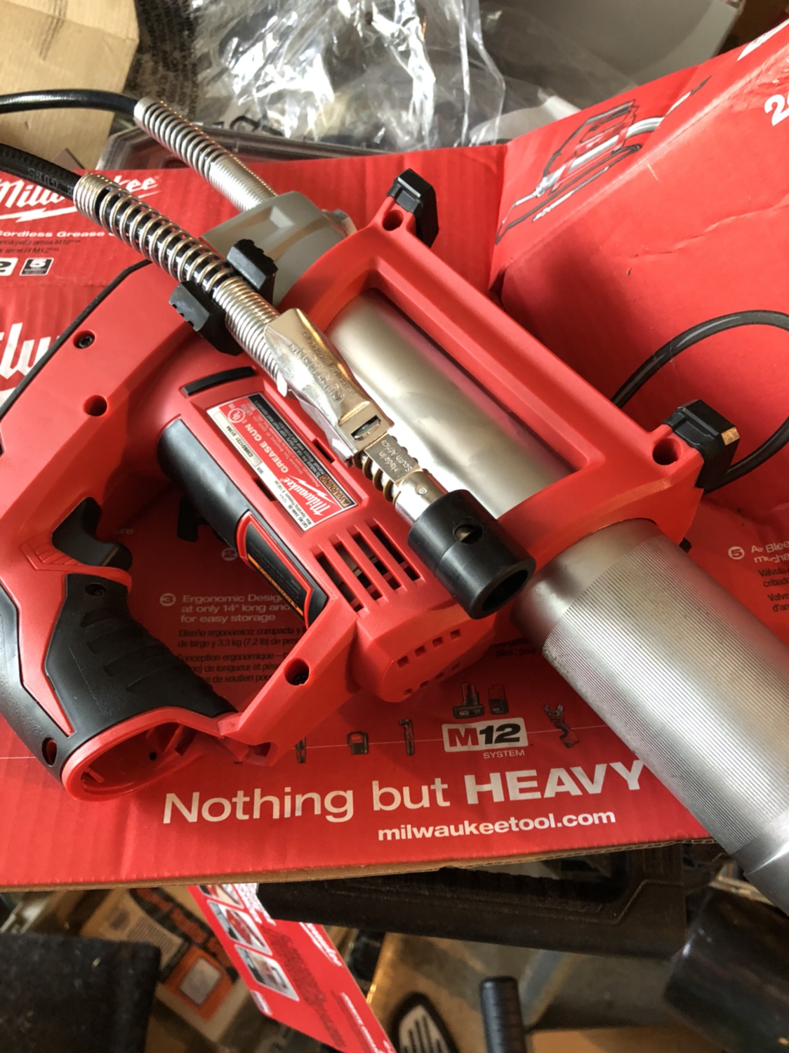

I have both a Lincoln and M12 Milwaukee
Prefer the Milwaukee
