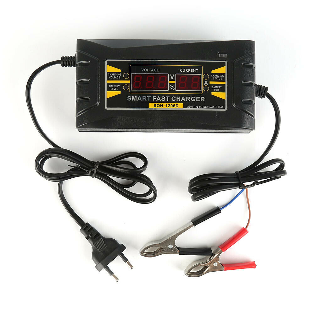

May have said this before. Have two tender type chargers. One a Schumaker. Both work but don't fully charge the batteries, and don't boil the batteries either. Good to keep batteries healthy but not good for starting or deep cycle applications. Just ordered some chinese 4 stage charger for $12.99 USD, Free Shippinground s. See how well that works.
I rather buy something right from China for Thirteeen Bucks, than buy the same thing here marked up three times for Sixty!
Ordered with US Plug.

Can't believe I got my cheapie Chinese Charger in the mailbox yesterday. Looks promising. I was doing to put it on some battery last night, but was worried about buring the place down, so I will try it today and keep an eye on it.
Glad it somes with instructions.
"The Charger has a high-pressure, danger, such as failure, please contact your dealer or contact the manufacturer . . ."
And Lastly. NOTE: There reverse protection function is not connected to the battery charger, the output voltage is not output when the output terminal from the battery output only after being triggered. So there! Glad I know that now.

I kind of like this cheap little charger. Short thermoplastic cords that don't get tangled up as easy.
I like a brick style charger, but the charge/ready light doesndd't tell me much. This thing has Volts, Amps and percent charge which I like, if the information is accurate.
BUT, like all low current chargers, it will put a surface charge on a depleted battery and tell you it's charged.
Even if there is the remote possibilty that a charger isn't made in CHINA, the parts inside will be. Last I knew, they didn't make components in the States.
One question I have. Should you remove a charger when starting a machine?
