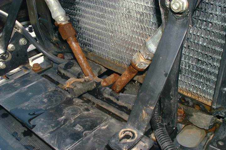

Mike, the battery leak problem definitely effects Class III Boomers. I think I was one of the first to report the problem here on TBN and since that time I've seen the problem repeated over and over. If your dealer said the problem was only with overfilled batteries, he just doesn't know the full scope of the problem. My battery and many others have not been overfilled. I took my tractor into my dealer and made a warranty claim for the repairs. I got a new radiator, hydrostatic coolant lines and battery hardware. I've attached a picture of what my battery area looked like. /forums/images/graemlins/tongue.gif In this picture, the battery is removed, so you need to look behind your battery to locate any problems. I keep expecting New Holland to come out with a battery box or even an apron to cover the battery, but as yet, nothing.... /forums/images/graemlins/frown.gif Just keep an eye on your battery area and wash the area down with lots of fresh water. You may never see a problem. I sure hope not.

At least on the Class II Boomers, there's barely enough room for the battery, so I am not sure a battery box would fit, plus it doesn't solve the underlying problem. I think the problem is worse on the Class III Boomers because it's harder to see the damage. As jinman's post indicates, you have to pull the battery to see how bad things are. At least with the Class IIs, it's all out in front. /forums/images/graemlins/frown.gif Even on my Class II, I didn't see how bad the battery tray was until I pulled the original battery out.
As jinman recommends, for those still running the original battery, you have to keep an eye on it. The solution to the problem is to replace the original battery with a sealed battery like an Optima. It's an expensive battery, but it solves the problem.
I could have reported the problem to the dealer and had him replace the battery under warranty, but then I'm without the tractor for a few days and I have to pay for pickup and delivery. It was easier for me to just clean up the mess and replace the battery. I didn't have damaged hydraulic pipes or a damaged radiator to deal with. I just had to clean the area, repaint and replace the hold down J screws.
I honestly don't think it's if Boomer owners will have a problem, it's when. And the when will probably happen when it's least convenient to deal with. My advice to Boomer owners is to do some preemptive maintenance and replace their battery. /forums/images/graemlins/wink.gif
