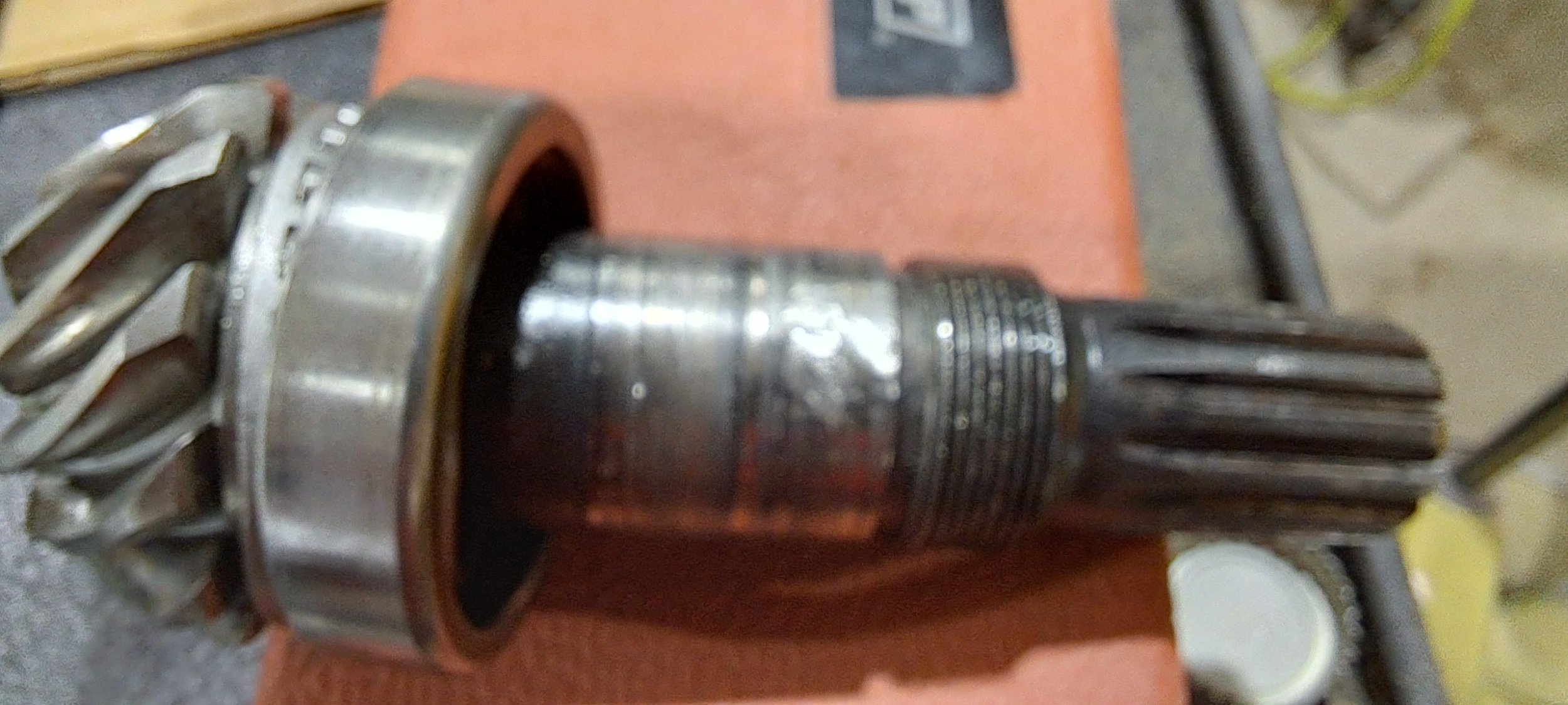

Thank u so much. I remove whole axle and was able to remove pinion..it appears bad shape..my question is branson wants sell Pinion and ring gear as a set..is there anywhere i can just purchase a new pinion that u are aware of....thank u
   / Bearing removal #33
I do not. Can you post a picture of the damage?

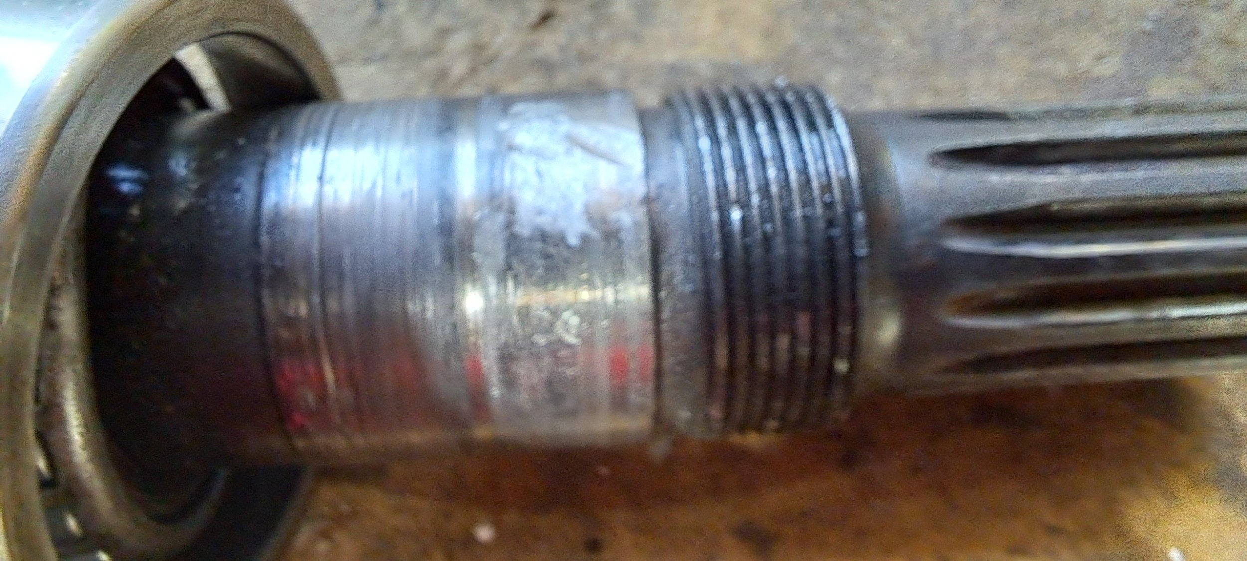

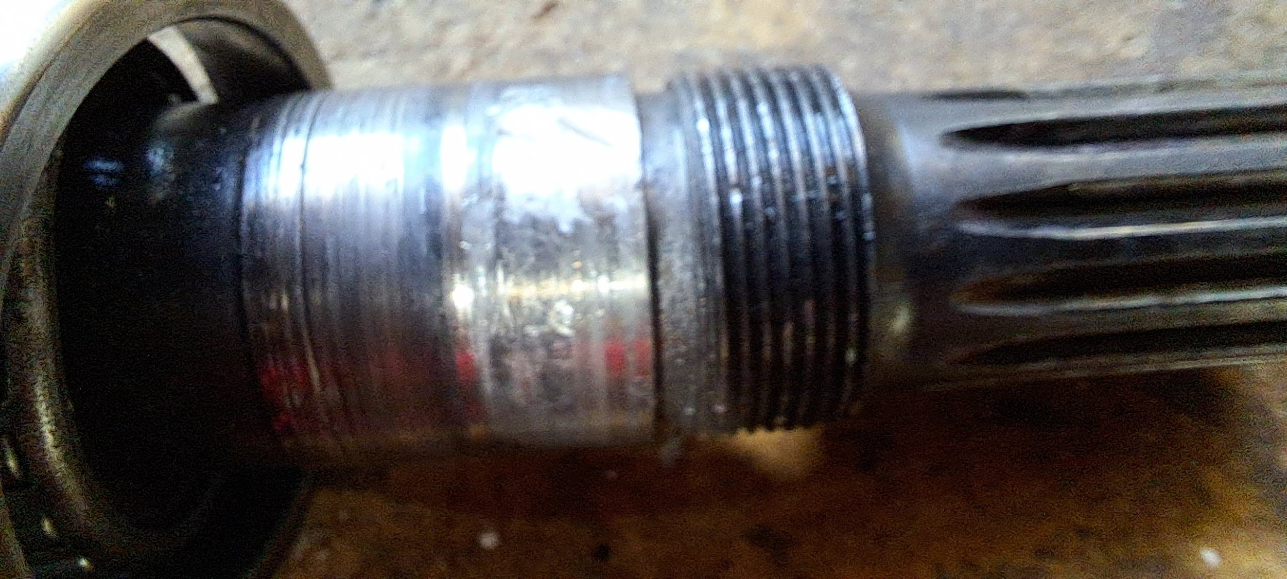

Ty for assistance new pinion only comes with ring gear 650. Dollars

That is unfortunate. The one gouge looks fairly deep and is right where the seal rides. I would mic that and outer diameter of the seal. You might could find a seal that would fit well if you had a machine shop turn the end of the shaft down to get rid of the gouges. The part of the shaft where the bearing fits is likely fine. Testing the fit would tell.
   / Bearing removal #37
You could also have a machinist deposit metal on the surface and machine it back down to spec.
This reminded me of the Speedy Sleeve. One of these might would work well in this case.
I think i just bite the dust and oder new shaft..hope it comes with new inner bearing no way to get this one off
I was not able to get the parts book to load all of the diagrams but you should verify it comes with the inner bearing. I would be surprised if it did.
I suggest you contact the folks at SKF and talk to them about the shaft and if they think a speedy sleeve would work. That is something you could just add to your shaft yourself. As long as the seal has a smooth surface to mate to you should be ok.
Here is a video explaining how it works.
   / Bearing removal #40
I have removed bearings off of shafts that looked as crummy as that. Also repaired journals as messed up as that. Any good machine shop could fix that for a lot less than the $650 plus bearings you were talking about. I would guess a few hours to fix. As others mentioned you can either turn down the chewed up shaft and spray on new metal which then gets turned or tig in new metal and turn. 15 minutes to get the old bearing off. Note I am not a machinist or welder and I fixed up a rusted and chewed up gear box. It is skilled work but a routine job for a talented machinist. Adam Booth has more than a few videos of fixing shafts.
