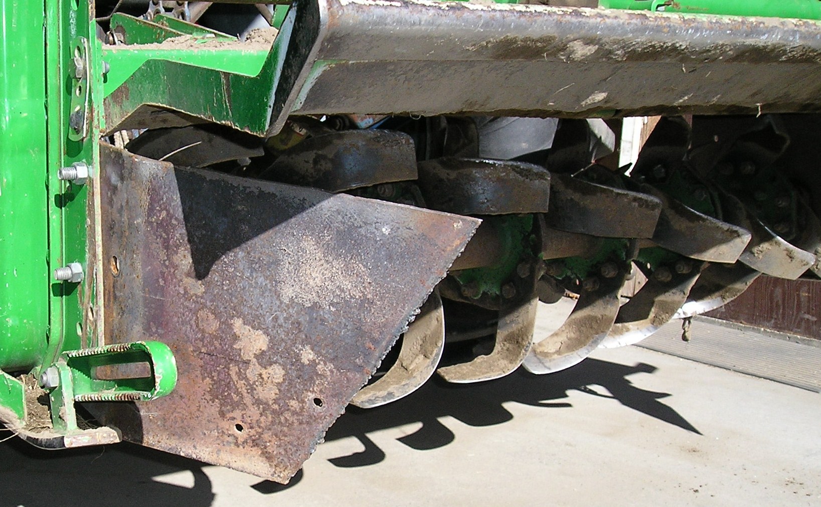

For growing garlic in raised beds I added "wings to each side of my tiller... I wanted to show the entire set up but my camera bit the dust... Anyway there is a wing on each side of the tiller and the bed is elevated about 8". The soil is really fluffy and drains well... the top "flat" of the raised bed is about 36" wide and the wings bring the soil inward about 8" on each side... Hope this gives another "food for thought" idea... Dave
I like it. Simple enough that I could make it from scrap.
/ Bedder/hiller fabrication #28
Baby Grand, mornin'... One more point.. My tiller is wider than the inside width of the tires... So, the bottom edge of the wings, when installed on the tiller, is narrower than the tire inside width... This allows to drive the tractor down the raised bed again for any other work that needs to be done... The upper edge of the wings is tapered inward so the dirt won't slough off, back into the tire track... Also I have added a drag of sorts, that attached to the door on the tiller, to "pre groove" the raised bed for planting purposes... that works well also..
Mornin', Dave! My tiller is just a skoatch (less than a tad) narrower than my tires (ags) outside-to-outside, so I think this would work for me if I can shove enough soil to the center that I have 2 clear tire tracks. I'm thinking of adding a toolbar on two receiver hitches to take a pair of hilling discs, but I could also add the hilling wings with a hinged leveling plate across the top of both wings, just aft of the discs, to get a nice shape and a little consolidation to the bed. Attaching at the tiller skids, as you did, would give me a nice 4 point mounting, which should be plenty tough. Time to get out the shirt board and hot glue and see what that would look like. Thanks for this idea!

Rob, morning... I usually do all my tilling, sub-soiling, fertilizer additions prior to bolting on the wings... I have made multiple passes with the wings attached and the raised bed just keeps getting taller... For me an 8" raised bed is about right considering it compacts over time to about 5".
Getting that height usually takes 2 passes... By all means experiment with it... You might wake up in the middle of the night with an idea for an attachment that puts you in a higher tax bracket....

Here is an addition, to my first post, on my hiller fabrication attachment to my tiller...
The wing shows how I narrowed the width of the raised bed to accomodate the tractor to drive down the bed again.
The raised bed... It has garlic planted in it and I chopped some straw to cover for the winter..
