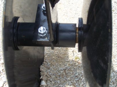

For those who may want to go with the 2 18 inch blades on each side setup, I can furnish a kit consisting of 4 blades, 2 axles, 2 axle nuts, 2 bearing sets, 2 end cast washers and 2 butt cast washers for $269 + shipping. (less hanger bracket) Ken Sweet

Agri Supply has the Keulavator frame AND discs without mounting hardware.
Ralph
