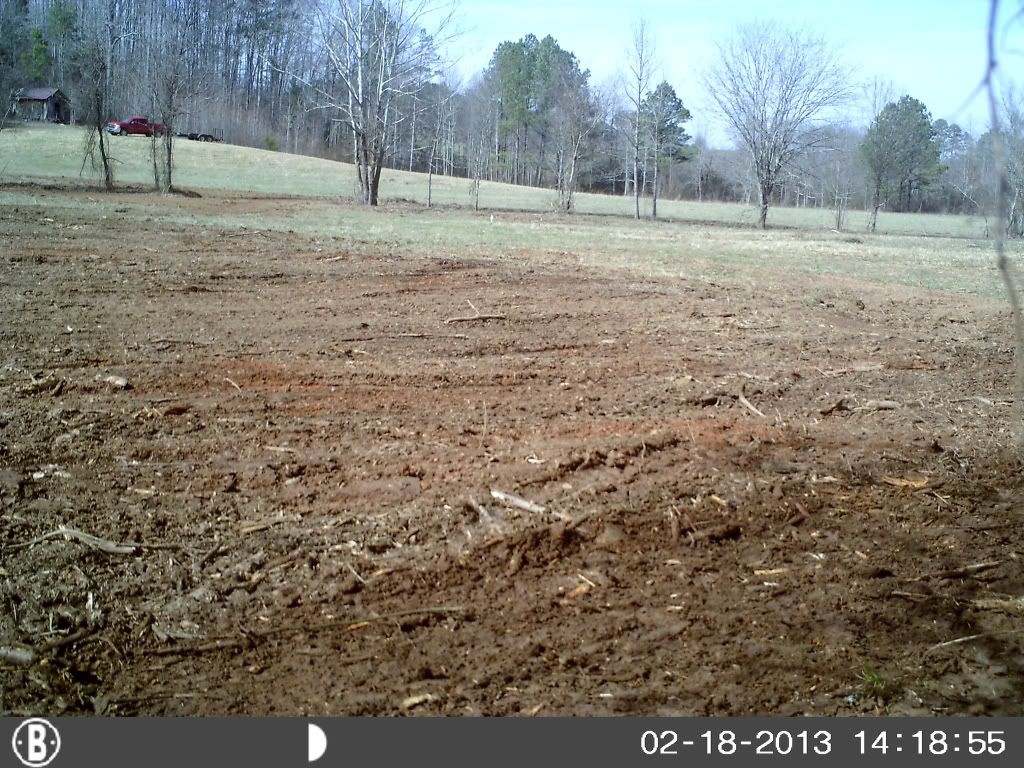

I don't care about 2 " stuff - it is the 6" that bothers me. Post #4 decsibes my problem best. After the skid steer moved the large pile of debris (logs, rootballs, etc..) it left behind smaller debris1-6" pieces of root, limbs, etc.. and the tracks pushed them into the topsoil. I want to turn this area back into pasture and a small plot area. I don't think a landscape rake will remove the debris. BTW = what is an assistant tractor driver??
This picture shows only about 1/4 of the area, but you get the idea of what I'm dealing with.

Have your kids out there with 'play' buckets and pay them by the pound!:)

Why your kids of course. they will be driving it before you know it then off to college and gone in a blink of an eye. Take time to play and laugh with them while you can it really doesn't last long at all. My youngest is now 27.
For that field I would just drive up set it in park and get down and throw every big piece within thirty feet of the bucket into the bucket then move it ahead thirty feet and repeat. Dump the bucket when full at your new burn pile or scrap pile location and go back for more. If one is too big to lift slip a chain around the exposed end and lift it with the loader. Each pass up the field will clear a thirty foot swath so it won't take long and they are out of there not just hidden by some dirt to reappear after a rain. You might have to do it again after you disk as it will find and turn up some that are buried now. It's like picking stone out of a Vermont side-hill field. Yah nevah run out of stones.
Rock and root rakes are nice if you have a lot to do but for a one time small acreage situation like yours just get on with it.
