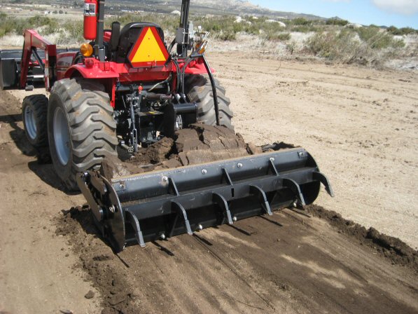

It is no big deal to add rear remotes:
Fit Rite Hydraulics - fitritehydraulics.com

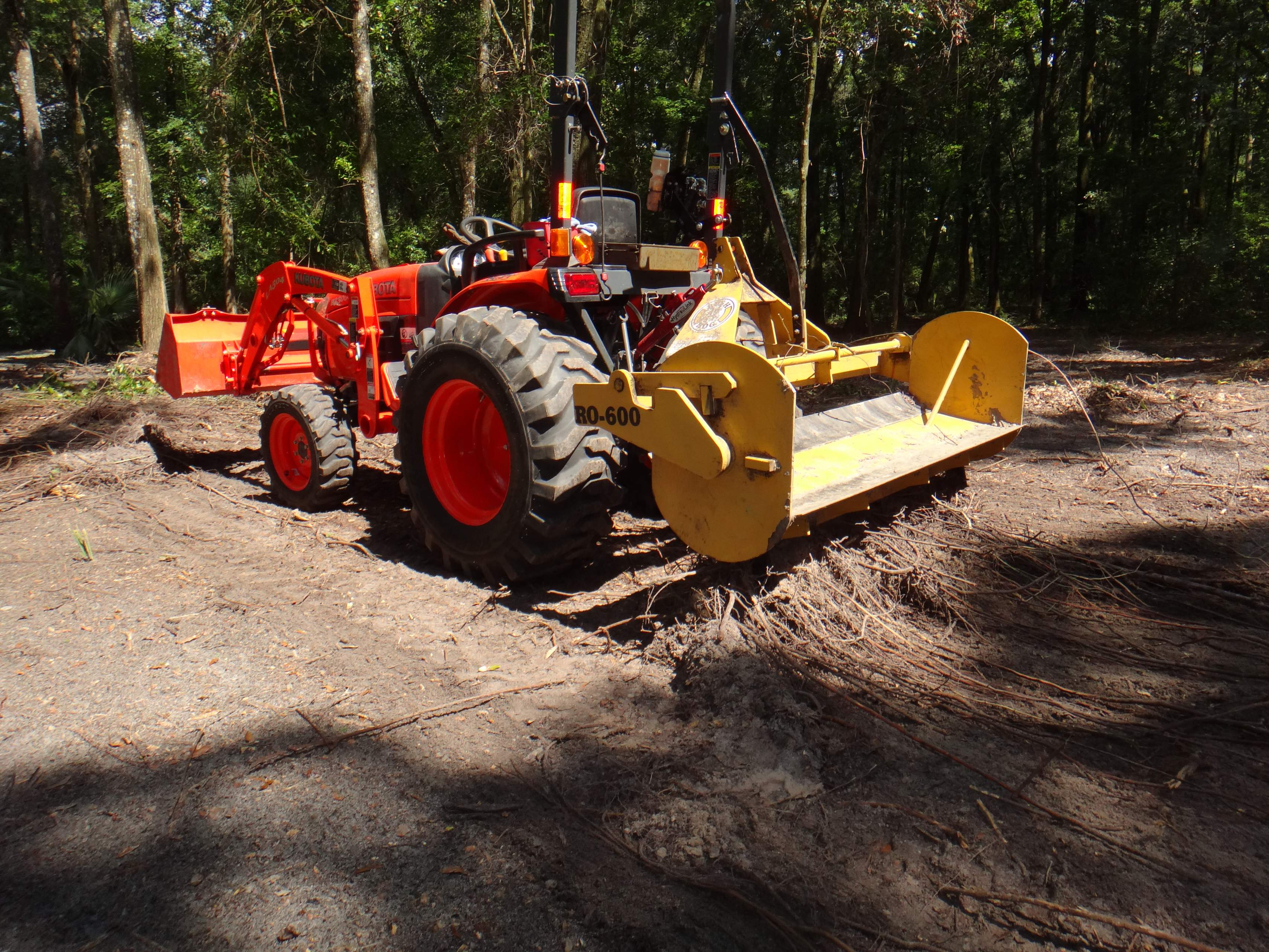

Consider a Rollover Box Blade (ROBB) in lieu of a standard Box Blade.
Brian, who is FIT RITE HYDRAULICS, has several ROBBs.
ROBBs were designed before rear remote hydraulics came on the tractor scene.
At that time, the Gannon "Earthcavator" was the premier ROBB used in construction.
ROBBs are simpler to use than a standard Box Blade and require less adjustment.
ROBBs are heavier than the equivalent width standard Box Blades, therefore, unfortunately, cost more.
Personally, I seek/am attracted to simple solutions. In the case of a ROBB, you pay more for the simpler solution.
Dirt Dog Manufacturing
LANDSCAPE BOX-ROLLOVER 3 POSITION | A&B Eagleline Farm Equipment
Bush Hog® Perfomance You Can Count On
https://www.google.com/search?clien...tractorbynet.com&ie=UTF-8&oe=UTF-8&gws_rd=ssl

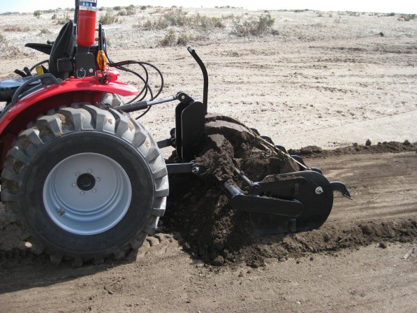

If the ground is REALLY dry, adobe, no Box Blade will cut. The ground has to contain at least a little moisture.

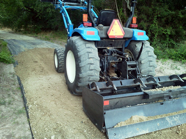

It was pretty hard to find a used Gannon here in Texas...especially a six footer. Where you're at I'd check out all of the older asphalt contractors and construction sale yards. I don't think you'll have a hard time finding one. Here's mine with manual scarifiers.
