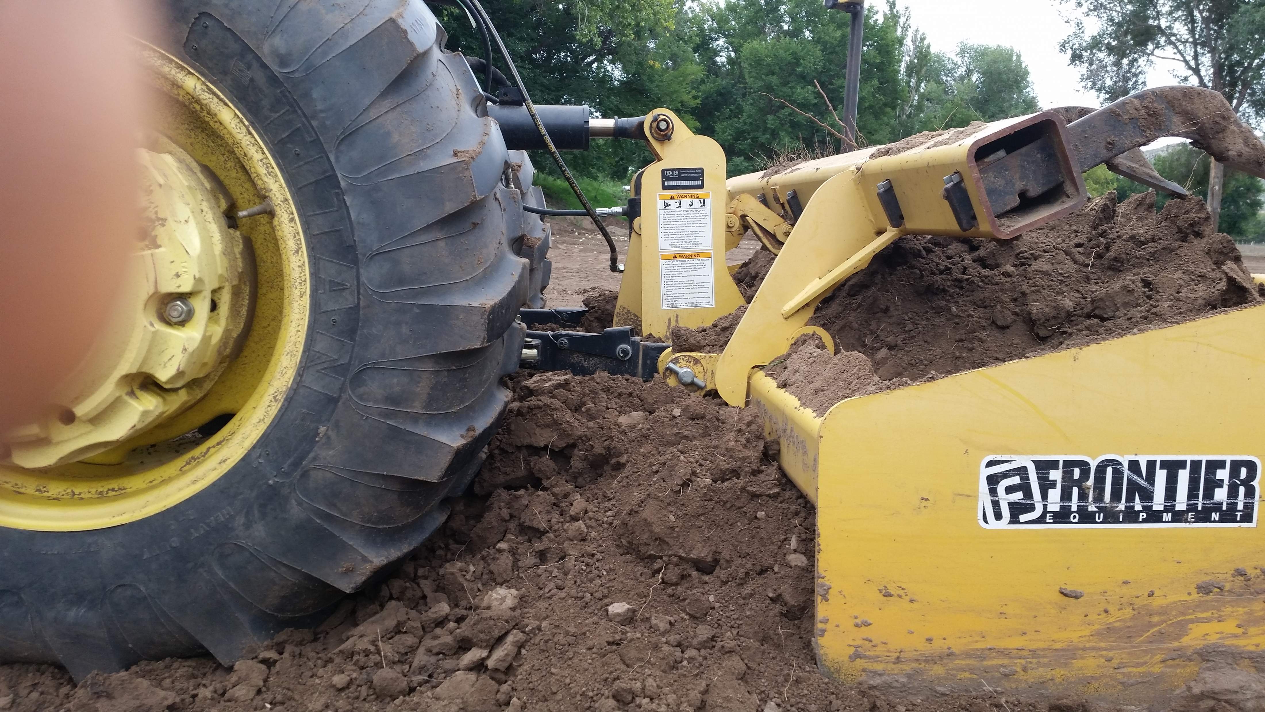

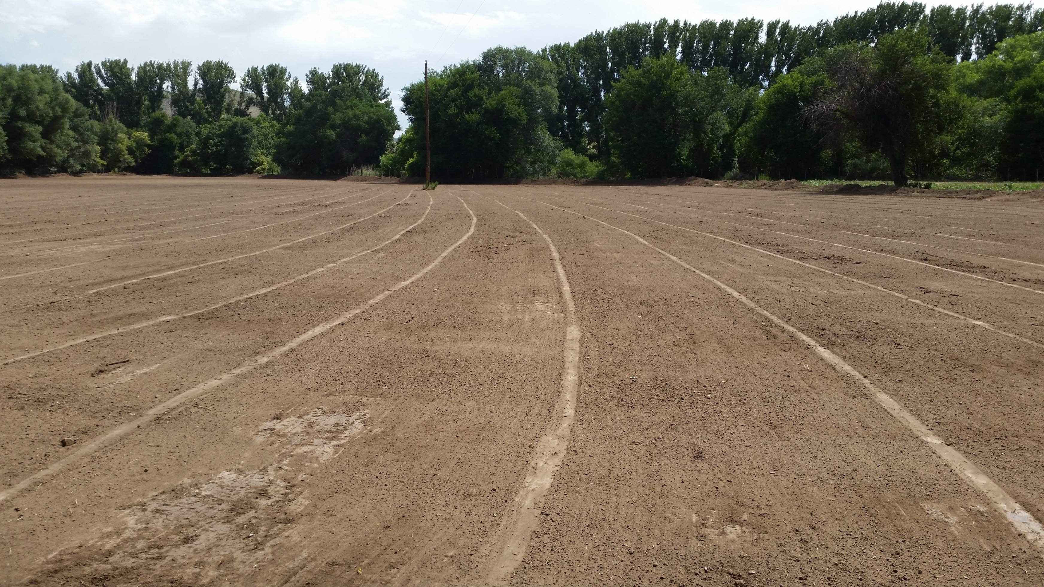

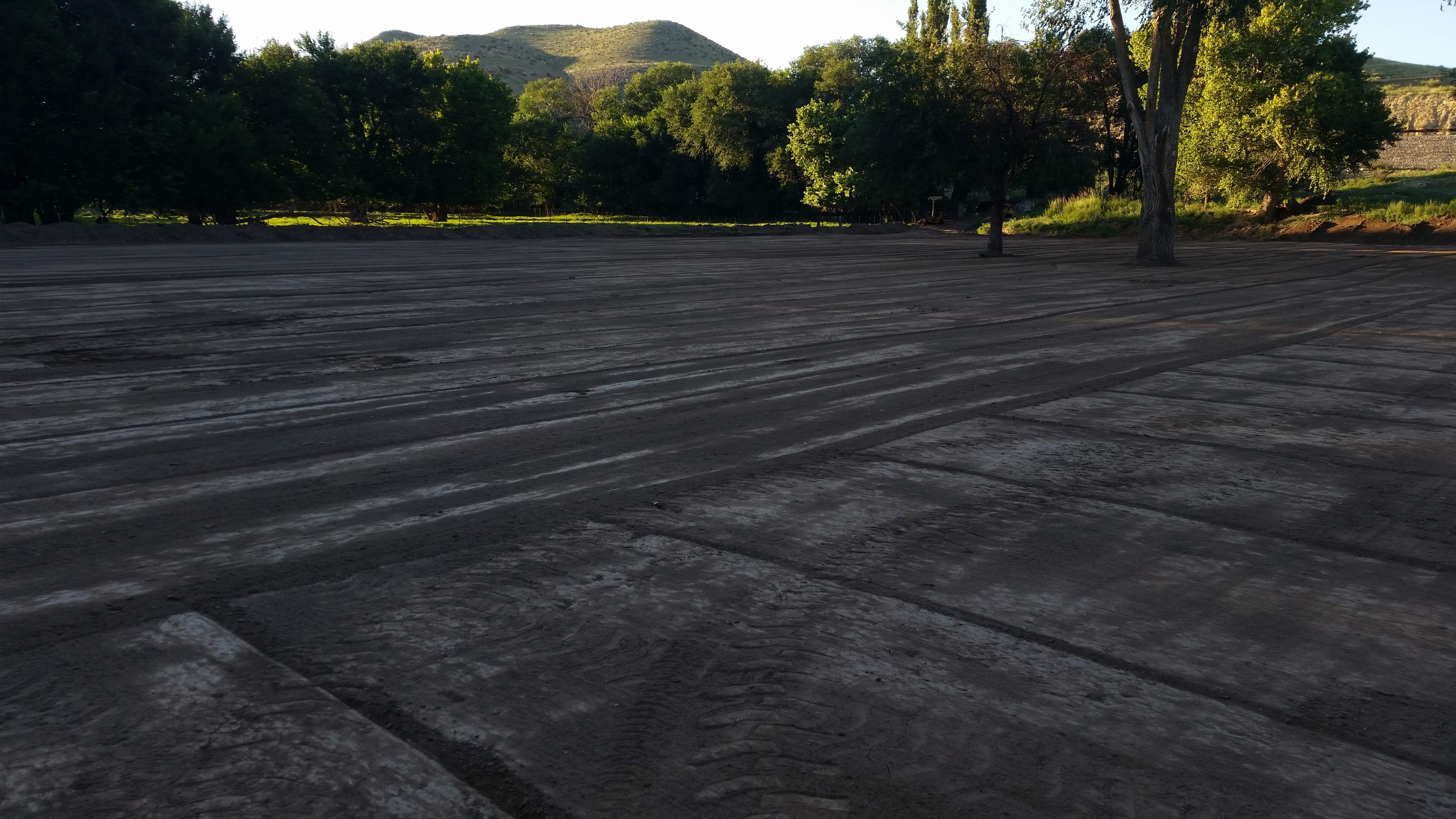

Thought I would post a few pics of a job done this month, small pasture with flood irrigation that I graded with a .250 % slope. First two pics of the field after grading three and four of the box blade, did not use the land plane on this field. The fifth picture is the adjacent field where I used the land plane after the box blade, you can see it makes the field a wee bit smoother. The last two pics are of the land plane used for this, I built this in 2009 to smooth out my rear lawn. While I do use a Topcon laser and receiver this work was all done without machine control, manual operation only. Will be adding the machine control and hydraulic wheels when this project is completed and collected. Point is that there is no way I could get these results if I did not have a good view of the entire box blade when working it.
