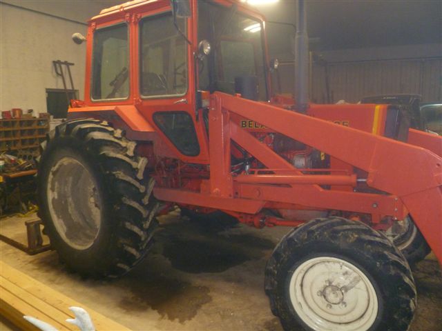

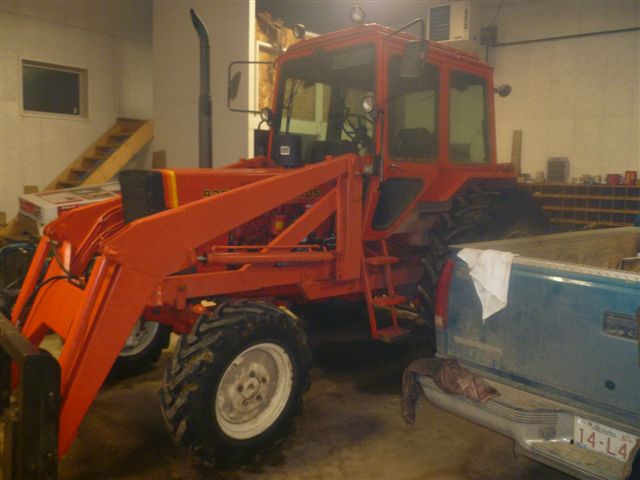

Yep, just 4 grand but it had no loader on it.(dealer estimate was 15 grand);)
I put that on my self,i got the loader for free from a neighbor. I just had to build the brackets and put new pins and bushings in the loader arms.
and fixed up the rams. I painted it to match the tractor for good measure.(maybe out of pocket $500)
I build the 2 bale fork in the 3 point as well.
