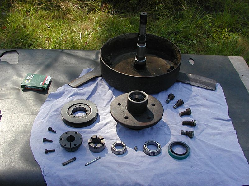

On the PT mower: I learned the hard way to check mine after every mowing. I raise the mower up as high as it will go, then I grasp each blade firmly and try to rock it. If the bearing is bad, you can feel it. It only takes a few seconds and will save a lot of money.
If you run with a bad bearing, it doesn't take long to destroy the spindle and/or hub.
You can't hear the problem until it is too late. The hand check is the safest way. The bearings aren't that hard to change, and they are readily available at reasonable prices. I order from Skate Bearings in Miami.
