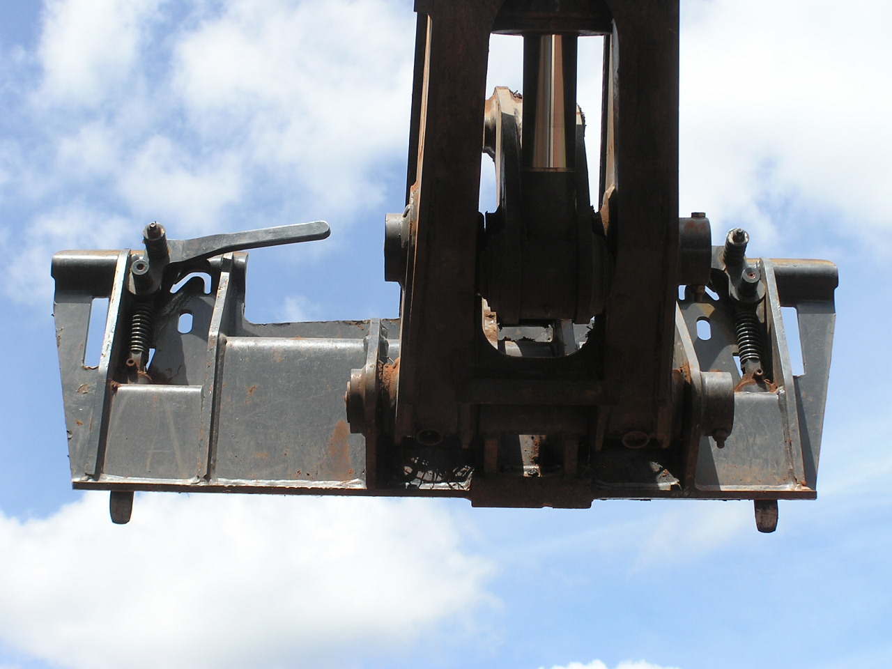

I don't worry about my SSQA getting twisted: :giggle:

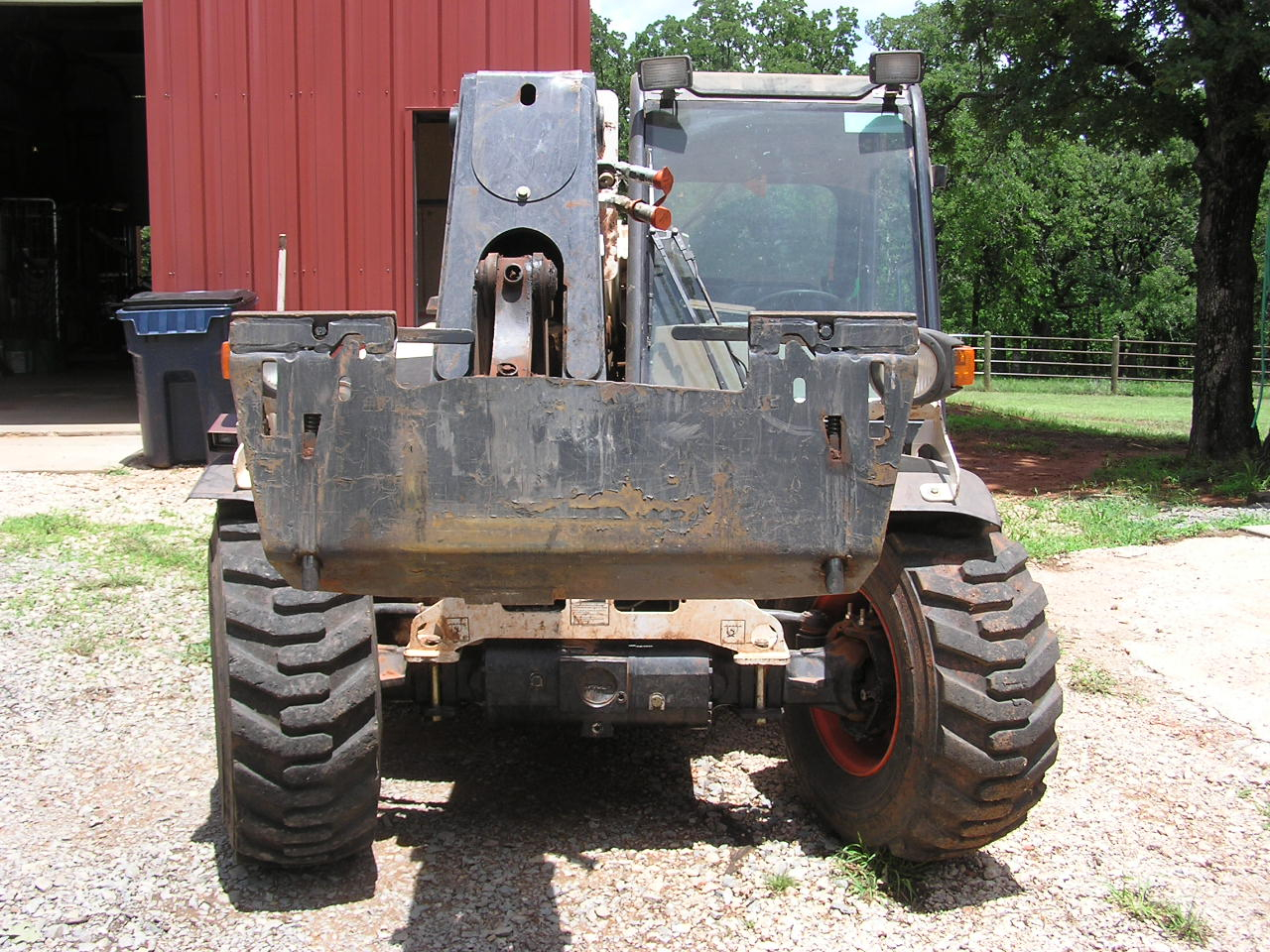

View of the back side:

Any idea why that forklift crane has the curved cutout in the back plate instead of being straight across?

Bend it back but the cross tube will soon break and need to be replaced with a solid bar

I would use caution reinforcing the cross bar too much. That is the weak link and easy to fix. I bent mine on my L6060, because one side of the forks (w/6' extensions) I was using unlatched and put all the pressure on one side. That twisted the ssqa mounts out of time. I cut the tube and put a small adapter into the ends to weld it back. It takes a unusual force to twist the cross bar, if that doesn't twist something else probably will and it might be much more expensive to fix.
