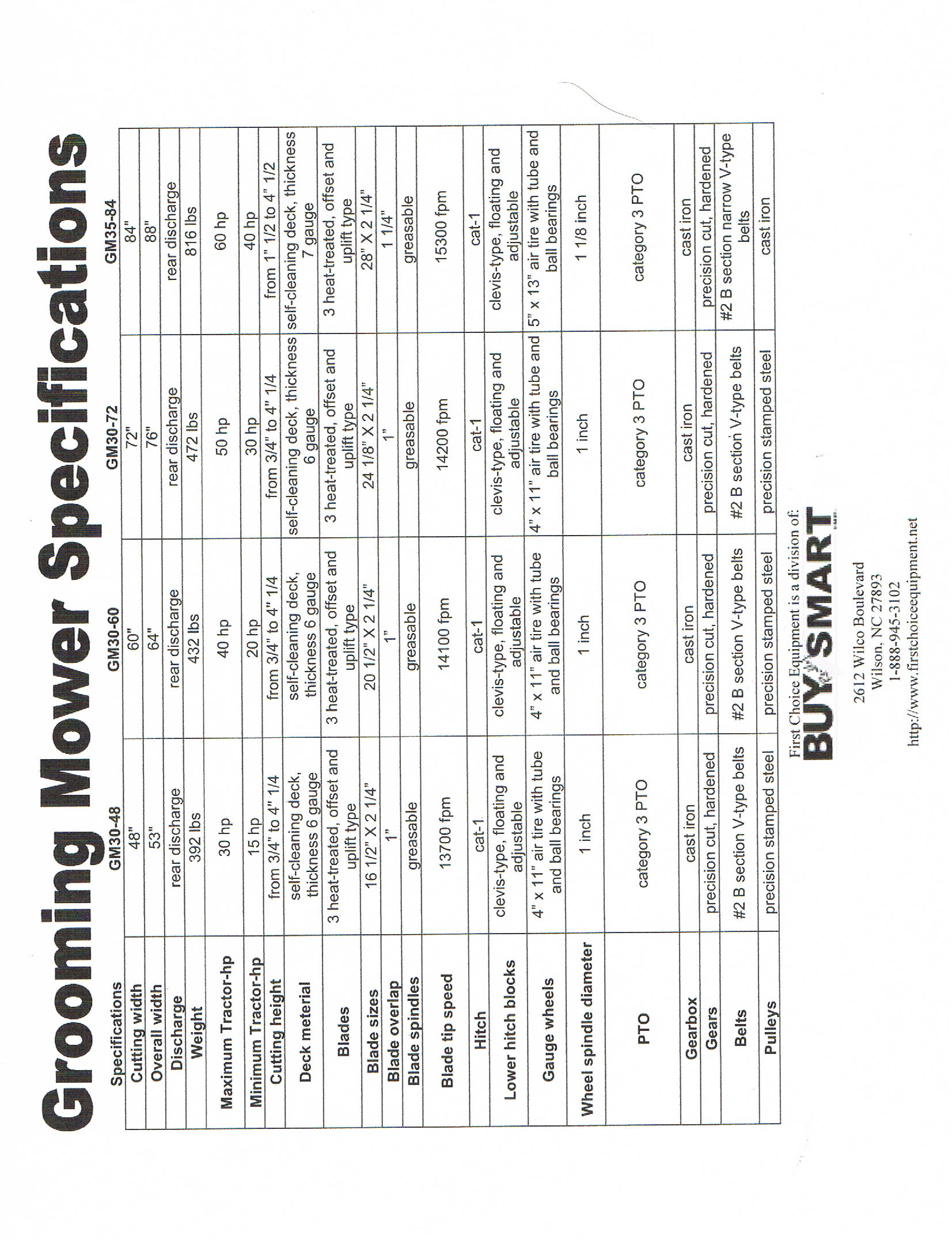

1 yr manufacturers warranty against defects in material and workmanship and 3 yr on the gearbox. The anti scalp roller is not standard equipment on these machines, however, is available. Here are the specs. Ken Sweet
