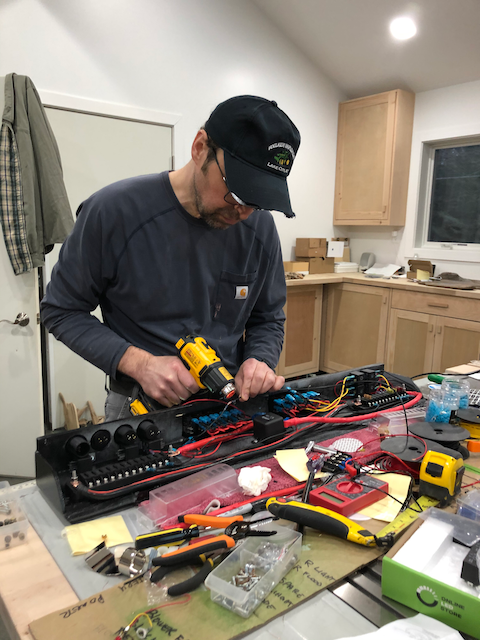

You mean like these? I saw this on one of Andrew Camarata's videos. https://www.amazon.com/gp/product/B073RMRCC3/ref=ppx_yo_dt_b_asin_title_o04_s00?ie=UTF8&psc=1
This is what I now use. What an amazing invention. They have a seal, grease and solder.
