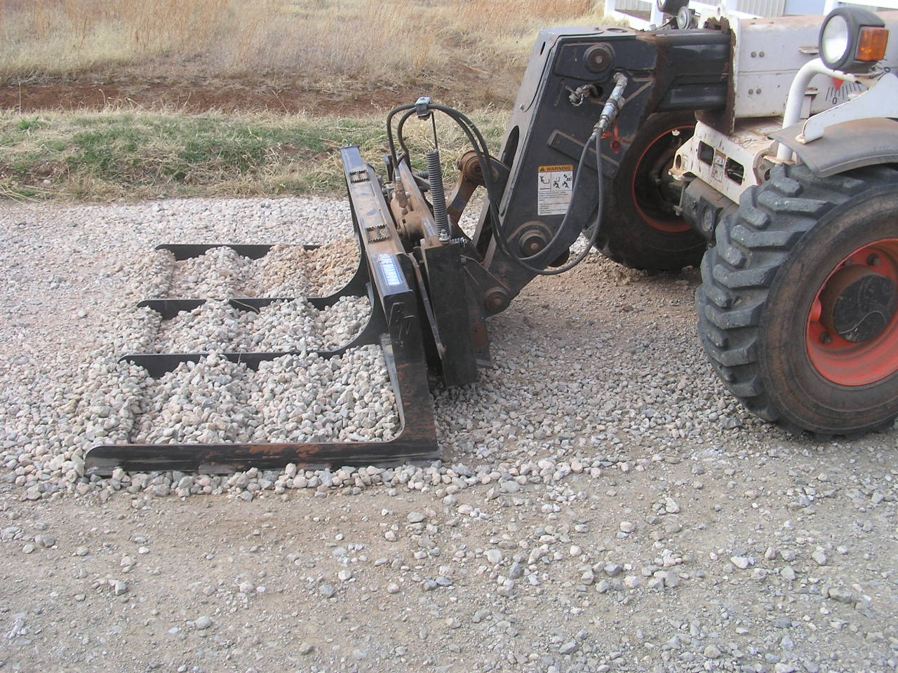

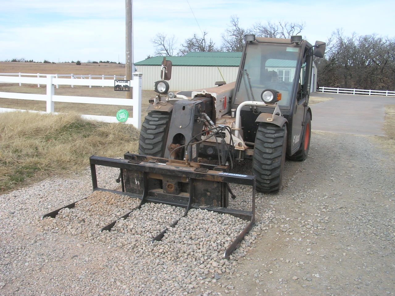

   / Best Attachment for Parking Lot Leveling #47
I do not have a LPGS. I have saw two different designs in regards to blade angle. One type have both blades angled the same direction. One type have the blades at opposite angles.
Which is yours? Thoughts about which would be best?
My blades are straight across and flat:
6' Wide:
