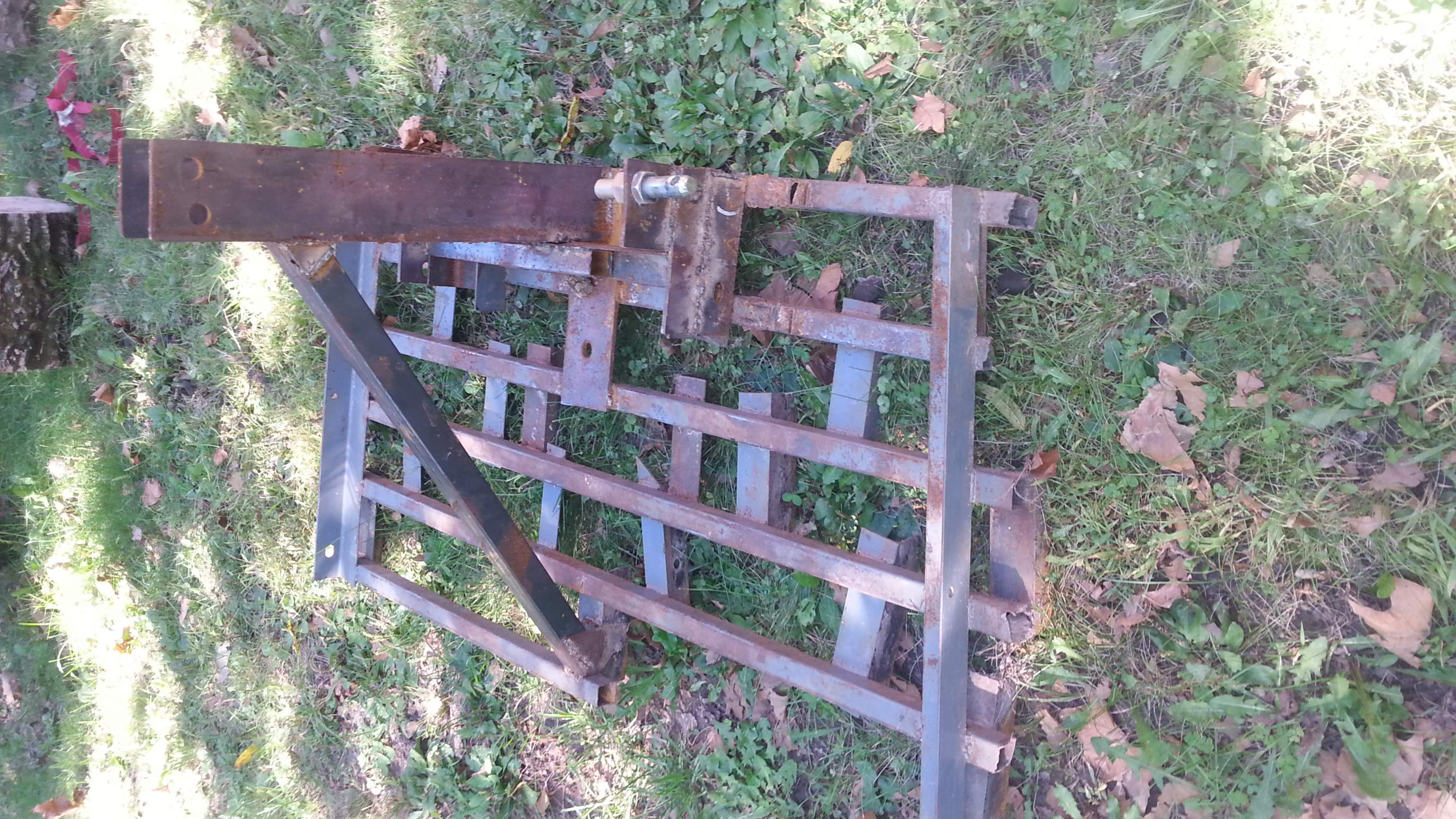

Almost like I could fassion something up myself somehow. We did make the original drag ourselves. Was for pulling behind ATV. No I modified it for 3PH use with a tower and tie bar mount so can pick it up. That was the problem with it on ATV, no way to pick it up. Like to disengage is over the wooden bridges and jumps as not to tear them up. It is good to leave the faces of jumps hard pack.
I'll post a pic of what we made (me and the 13 year old). Nothing fancy or nice, but something to do in the garage.
Problem with it is it is like 36" long and four rows of teeth and it doesn't like to turn as all the teeth are digging in sideways.
But these soil pulverizers are one row of teeth and I imagine turn better. Even the larger ones that are two rows of teeth, they are only 10-12" apart.
Have to find a nice I-beam and see what I can fab up.

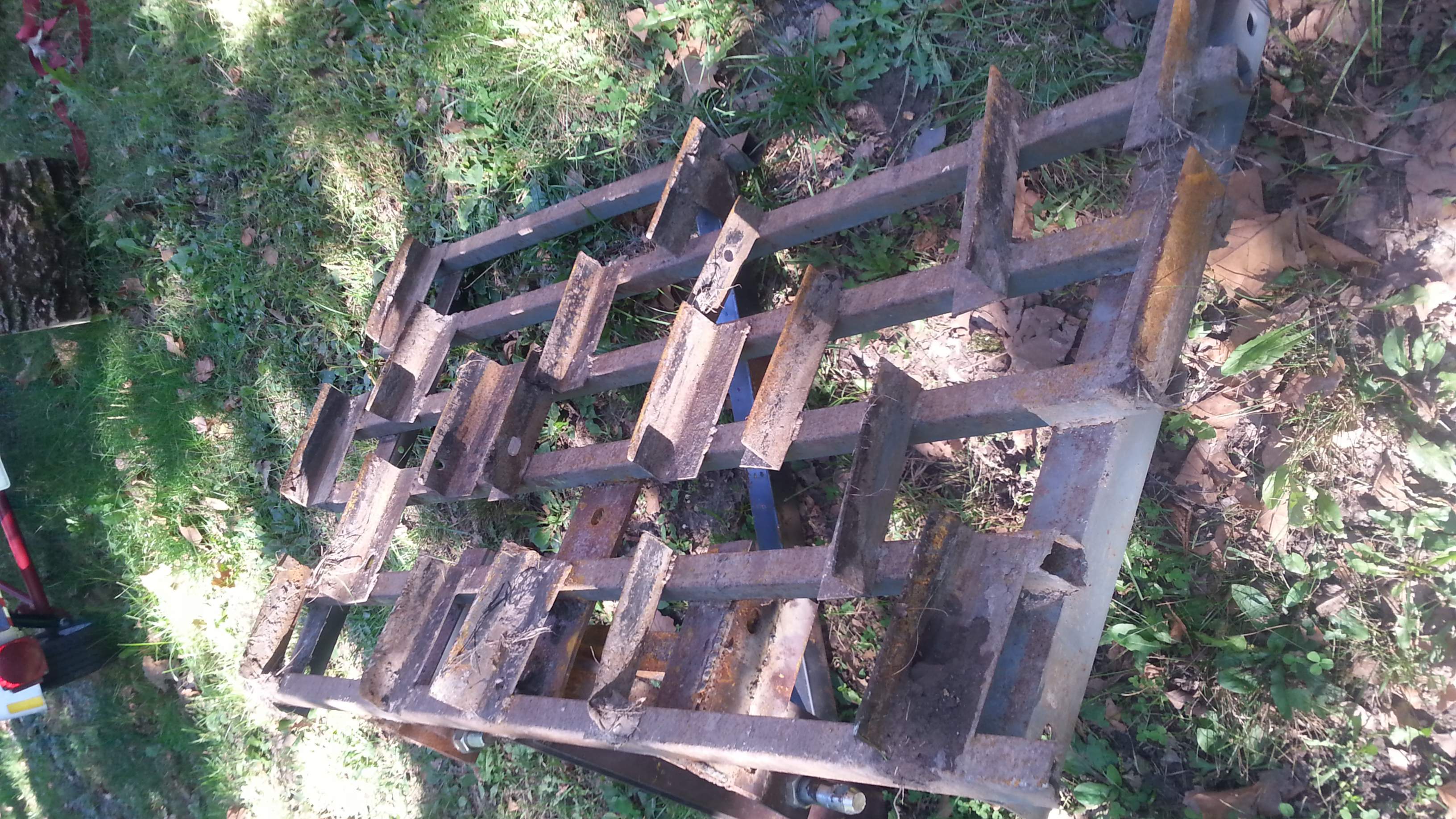

AS you can see: The "teeth" are lengths of angle iron 6-8" long. You can imagine it doesn't want to turn.
I get free steel from work. The kid got a flux core welder for his birthday. We like messing around in the garage. Might have to try Version #2

Consider modifying your current design into a Landplane / Grading Scraper.
After seeing your homemade drag, I would remove the angle iron "teeth" and get some 1/2" or larger rebar and cut it into 5"-6" lengths and weld it onto the cross members of the existing drag so that the rebar teeth would extend about 3" below the the drag.
Similar to this: 4ft harrow / arena drag. Heck, you could even add the rake on the back like this one has if you want a smoother surface.
