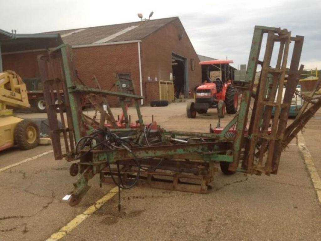

I run a disc over it and then follow up with a do-all to break up the clods.
   / Best attachment to loosen up soil of dirtbike track? #43
What is a do-all? Is that what would be called a spike harrow?
   / Best attachment to loosen up soil of dirtbike track? #44
There are different configurations, but this is like mine and has the rolling baskets on the front and then what amounts to a drag harrow on the back. The rolling baskets are what make it work so well for breaking clods and then the harrow smooths it out.
If you don't have a big enough tractor to pull it, you can remove the wings.

What would it be called?
Drag harrow
Spike harrow?
Soil conditioner?
Drag bar?
   / Best attachment to loosen up soil of dirtbike track? #50
Spike harrow. A drag harrow would be attached to the drawbar, not mounted to the 3 point hitch.
