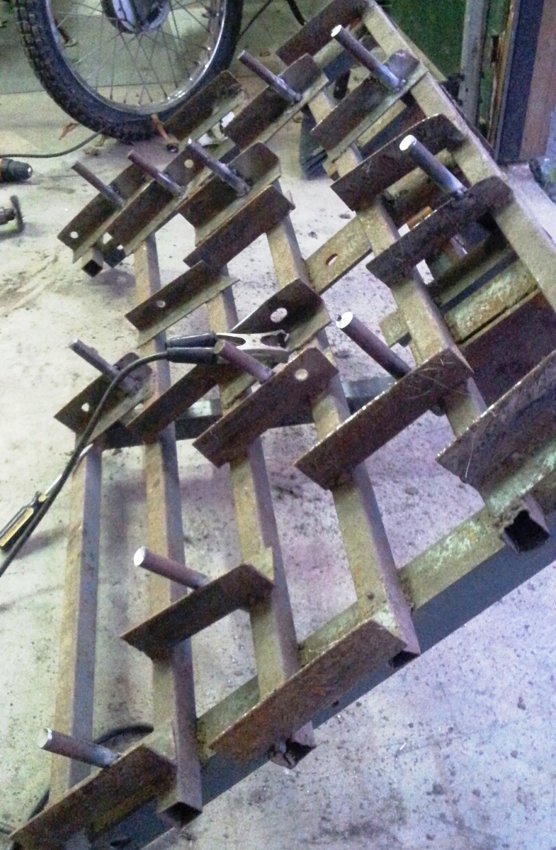

Thinking for sure I will try straight rods on my present drag to see how that goes. Might just make them all longer and leave the angle iron teeth on there....something more to weld to.

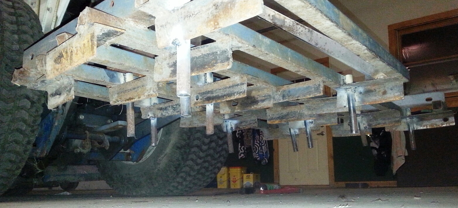

Yea, I still think the gang disc will be best.
But, for the heck of it, grabbed a six foot length of 5/8" 1144 stressproof and cut it into 12 6" pieces.
Will drill 12 holes in selected angle iron sections and put these through. 3" of weld length and 3" of exposure over the present angle iron "teeth".
See how this works....for free.

See how this works.
Something to do.
