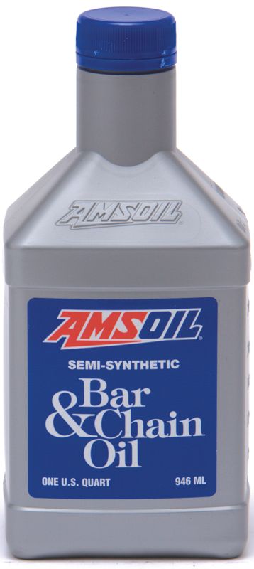

What I consider the best I only used in racesaws. Slick as snot and used less HP to run IMO. But cost to much for regular use.
I just use Cam2 or TSC brand for everyday use. RK sells cam 2 brand for $5 a gal.
