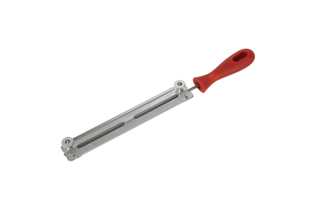

I use this thing, there is a guide for the angle, and you can't screw the depth it works pretty good for me. As for file I am not sure a file is a file but I think I use Oregon. I simply buy lots, I am not scared to throw it out and grab a new one.
This type of guided file maintains a sharp chain, takes away no more than needed, and also files the rake at the right depth. It works better than the little electric sharpeners, like the one Harbor Freight sells. I do like the electric grinding wheel type of sharpener when salvaging a chain after hitting metal or rock.
