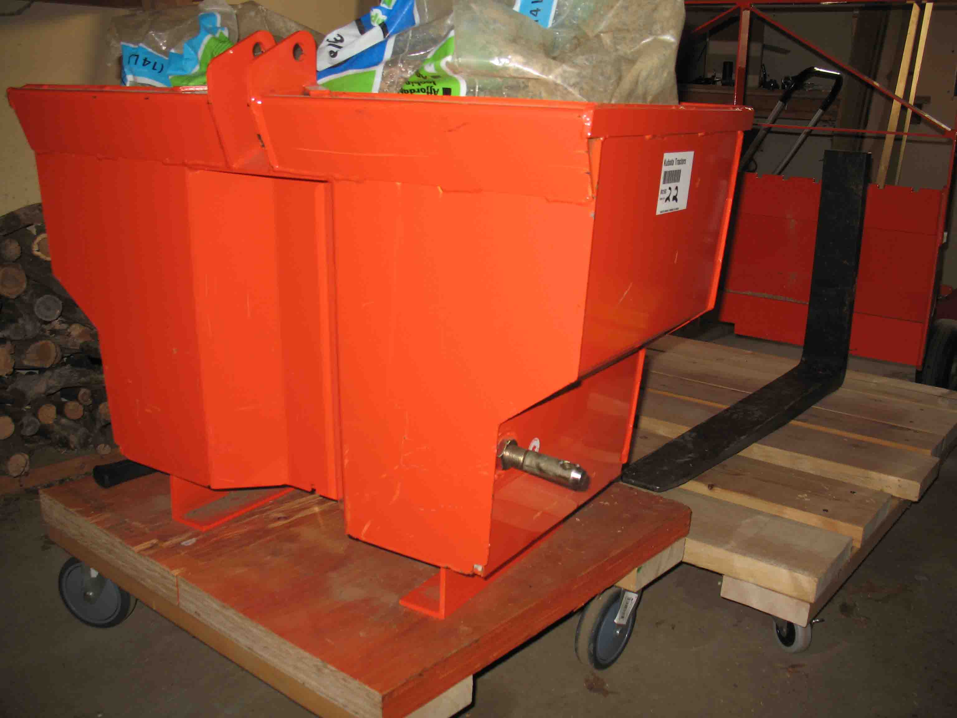

I'm ALL about photos!!! My middle name is photograph... So... yes, photos, please... :thumbsup::ashamed:
Teg
Here's the pic...
The curved part (top) of the Pat's catches the box before engaging with the pin.
