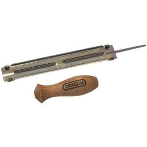

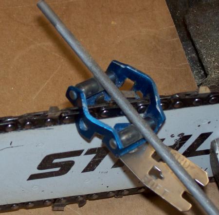

The two types of sharpening guides I've had good luck with (fast, easy to use, and get reliably good results):
I've also used the Pferd Chainsharp CSX and the Stihl 2 in 1 (which is just a relabeled Pferd guide). They have an advantage that they are faster, since they set the depth gauge at the same time you are sharpening. The disadvantage is that their method of setting the depth guages is not progressive, requiring that you match the lengths of the cutters when sharpening for best performance. Contrary to popular belief, it is not necessary to match the length of the cutters if you use a progressive tool for setting the depth gauges. (but that's a subject for another post - one which I have already made here on TBN several times).
