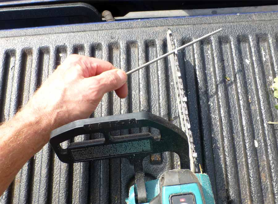

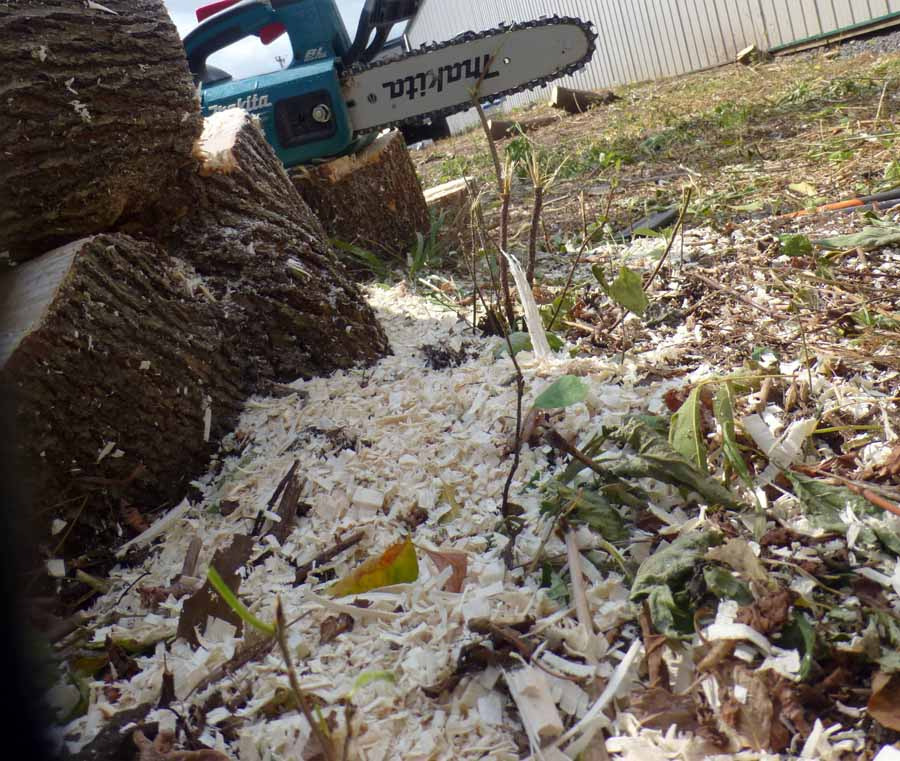

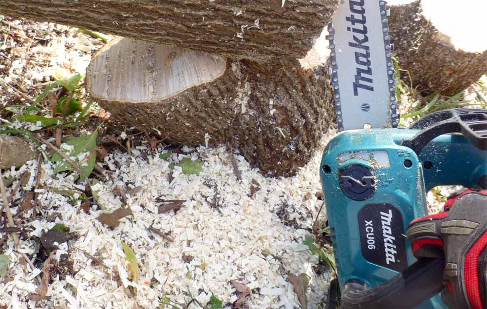

Here is my AAA sharpener I use and the results it does. Its joints are loose and can be owly to operate.. This is the only way this chain has been sharpened since new and it may have been redone 8 times. Was it worth its cost? Looks like its chipping to me. :p
Sharpeing device does wear glove for this process.

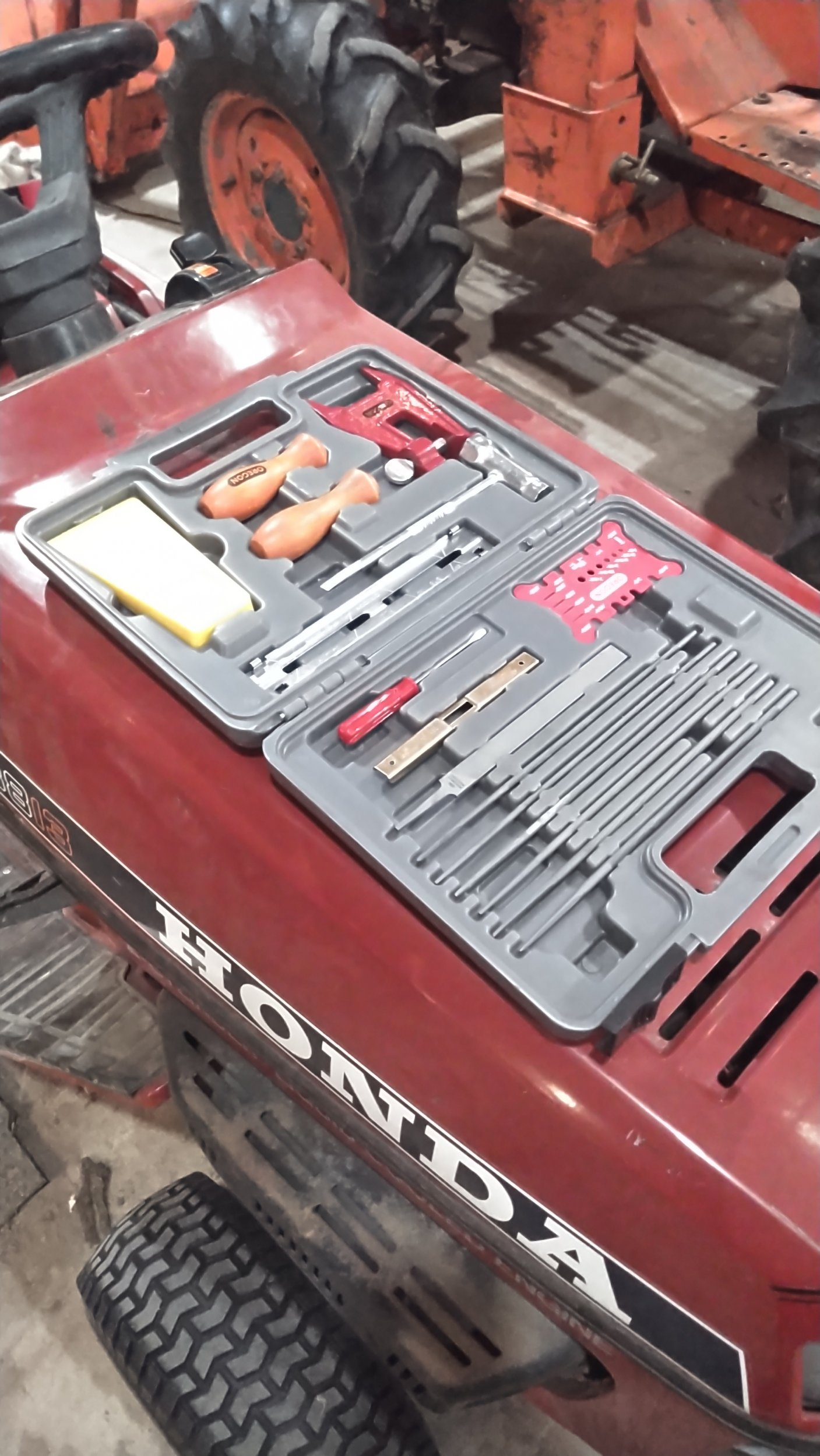

Looking for new files for my 4.5 gas and cordless running chainsaws all different pitches, etc. instead bought this entire Oregon kit imo good black Friday deal. Even has a portable stump vise.

That kit is gives you an assortment of file sizes, but only one of the clip on guide plates. Those guides are specific to a file size, so for whatever files you wish to use other than the one that matches the included guide plate, you will need to buy the appropriate guide plate (or learn to free-hand file).
