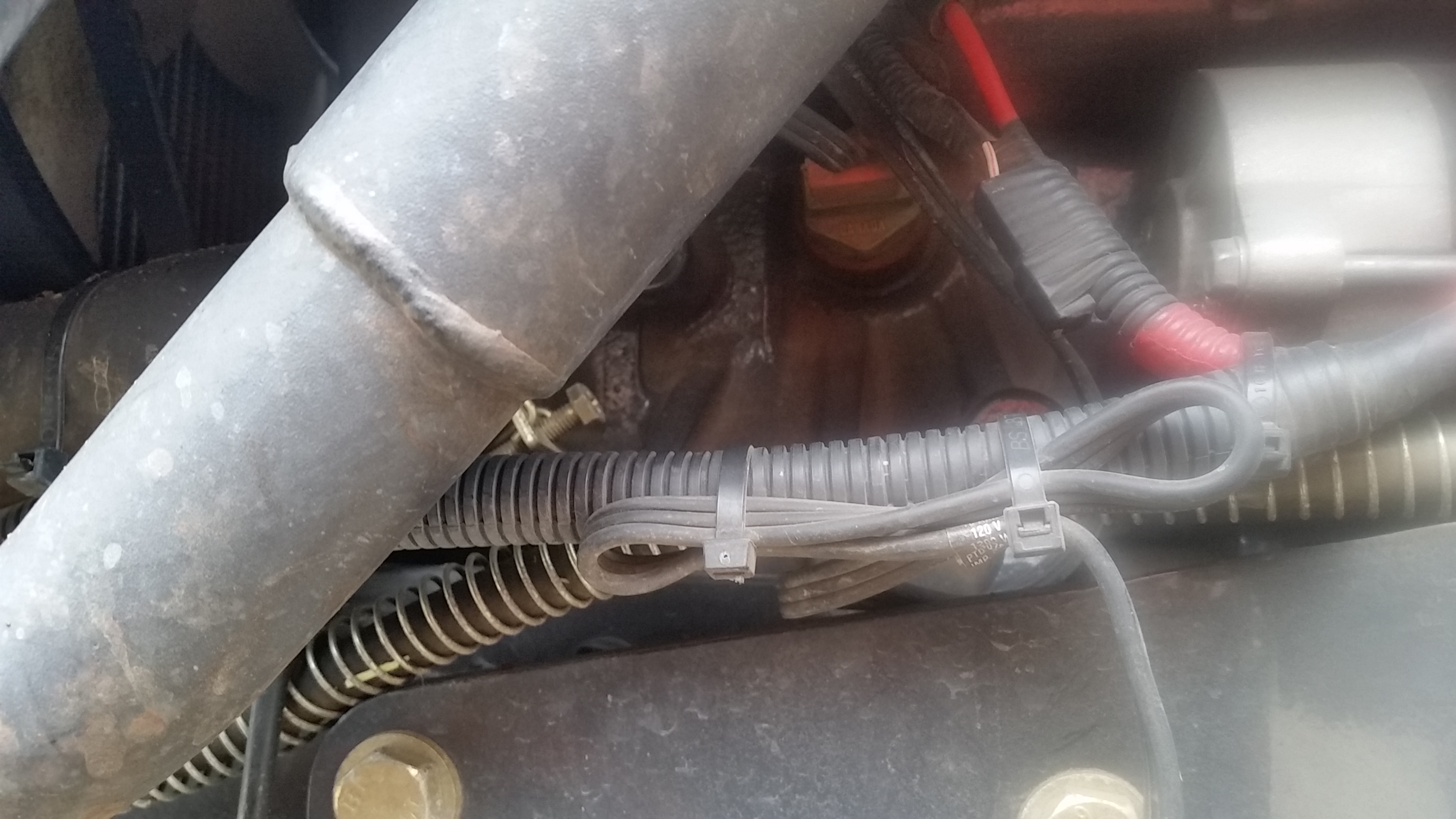

I've got a Bobcat CT235 (CK35) and it gets really cold here in Canada on the wind blasted prairies 200 miles north of Fargo. The in block heater element taps into a receiver just in front of the starter. You can see it here in between the starter and the exhaust pipe in the foreground. That's it with the reddish cap. The block will get warm to the touch in the coldest of days. It'll start without it but I prefer to baby my baby. Synthetic oil is a must for these occasional -30 temperatures too. A pour point of 20 degrees colder than my coldest is simply assurance. Mine was dealer or factory installed. I used to have Kubota BX and had the dealer come by, drain the coolant, knocked out the thin form that revealed the tap and simply screwed in the 110V heating element. I would suspect it's much the same without any tapping.
   / Best choice for engine heater CK 30 (block, heater hose, magnetic?) #17
