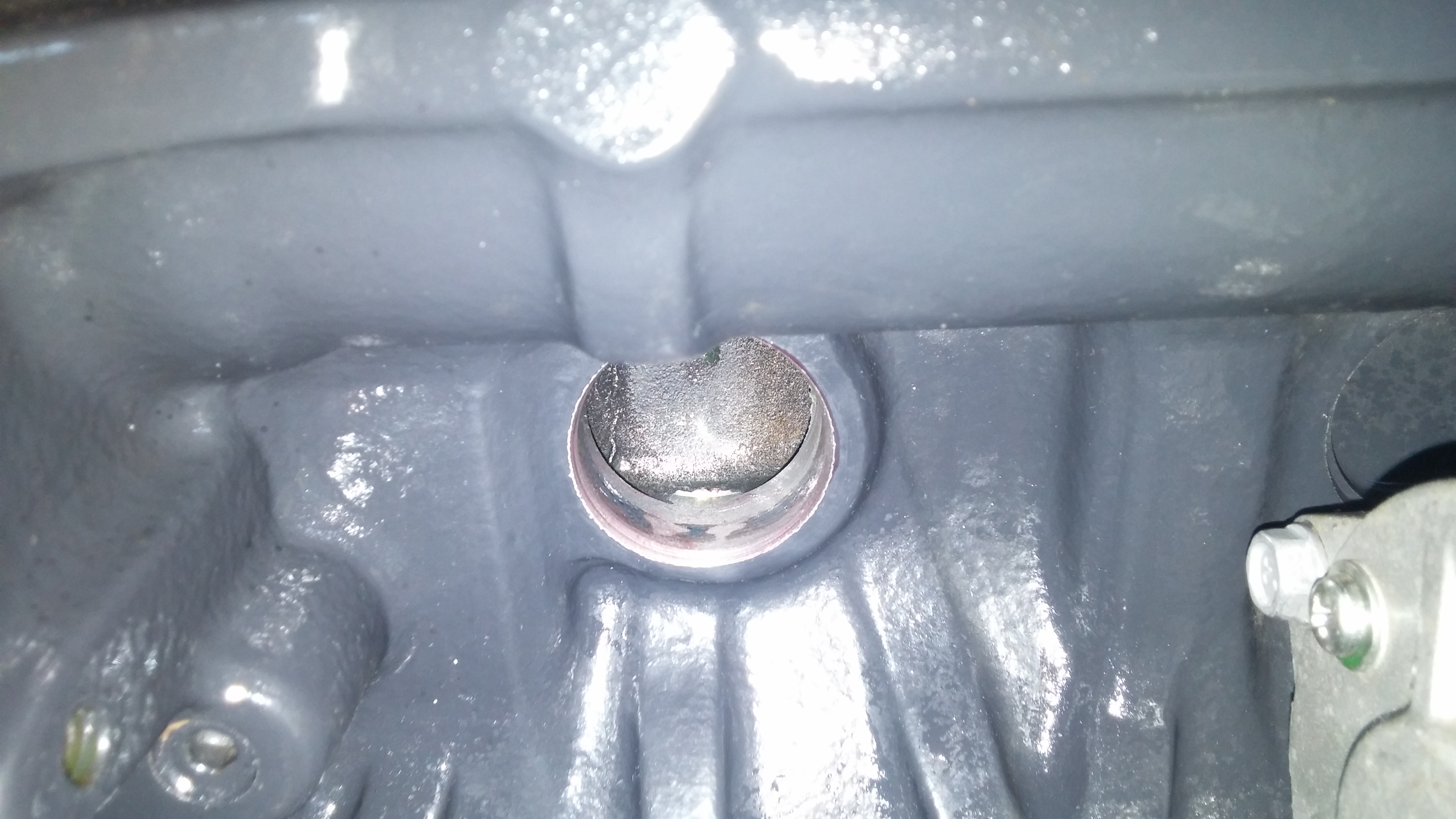

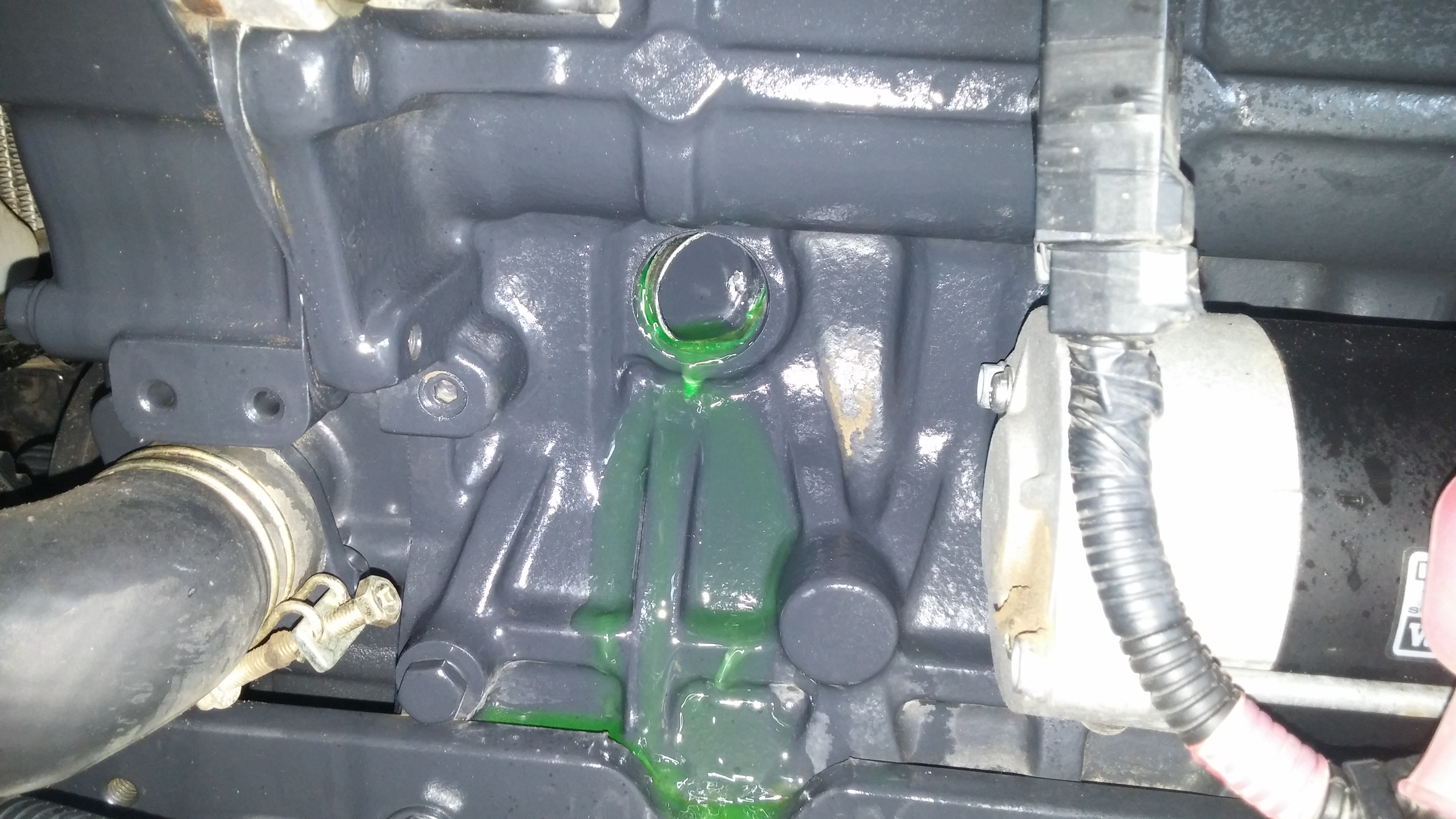

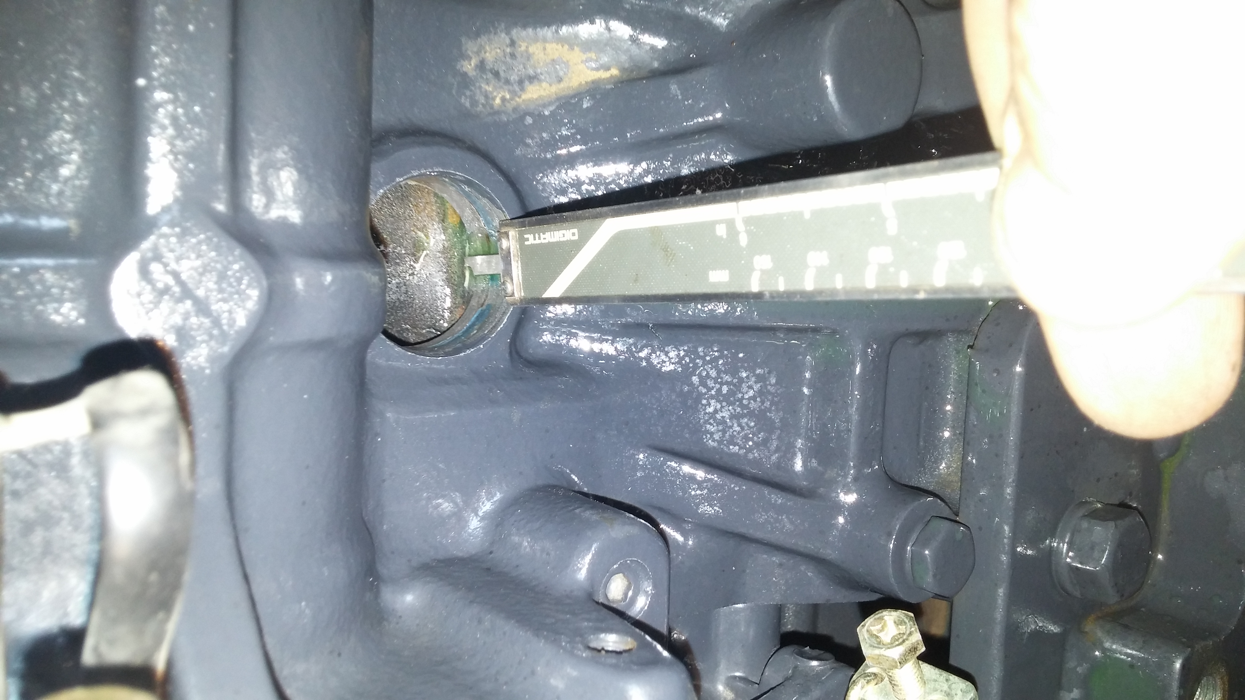

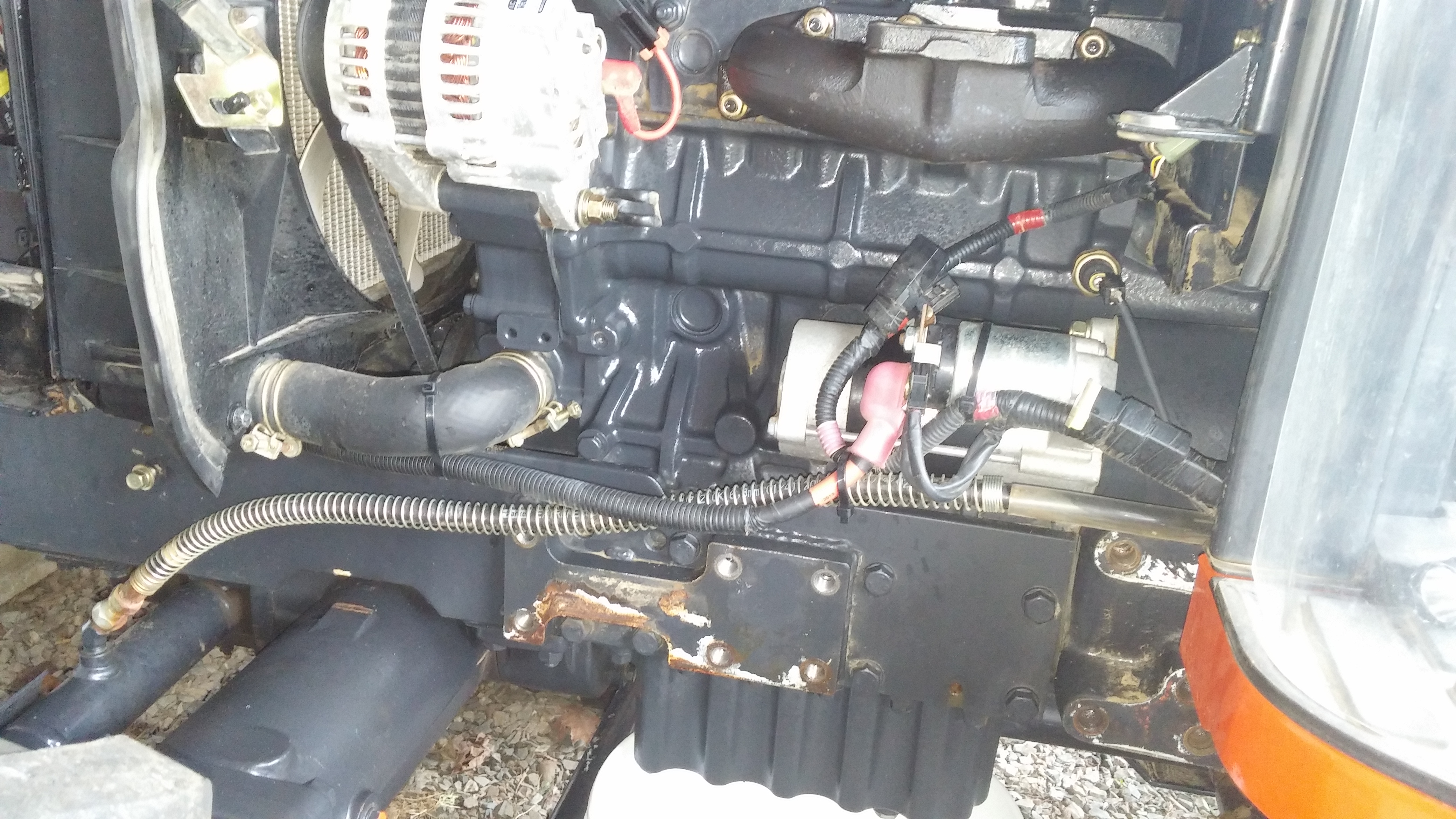

I finally got a chance to install the bushing and heater today it went pretty smooth. I removed both the loader frame and the muffler to have room to work. I used a punch to push in the side of the freeze plug towards the operator station. Once the antifreeze stopped flowing out I grabbed the lip of the plug with a pare of vice grips and pulled it out, just had to work it back and fourth gently and it popped right out.

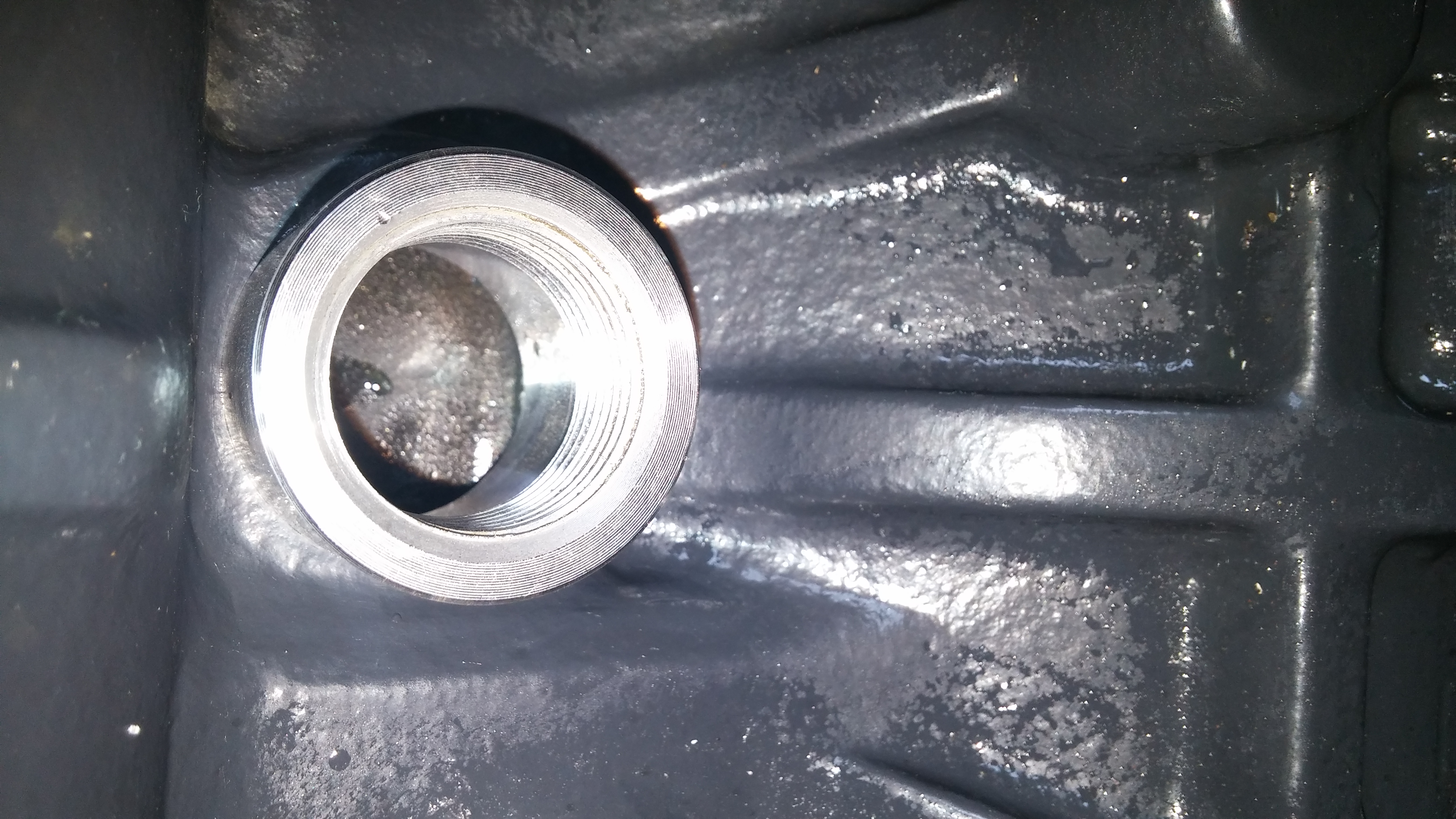

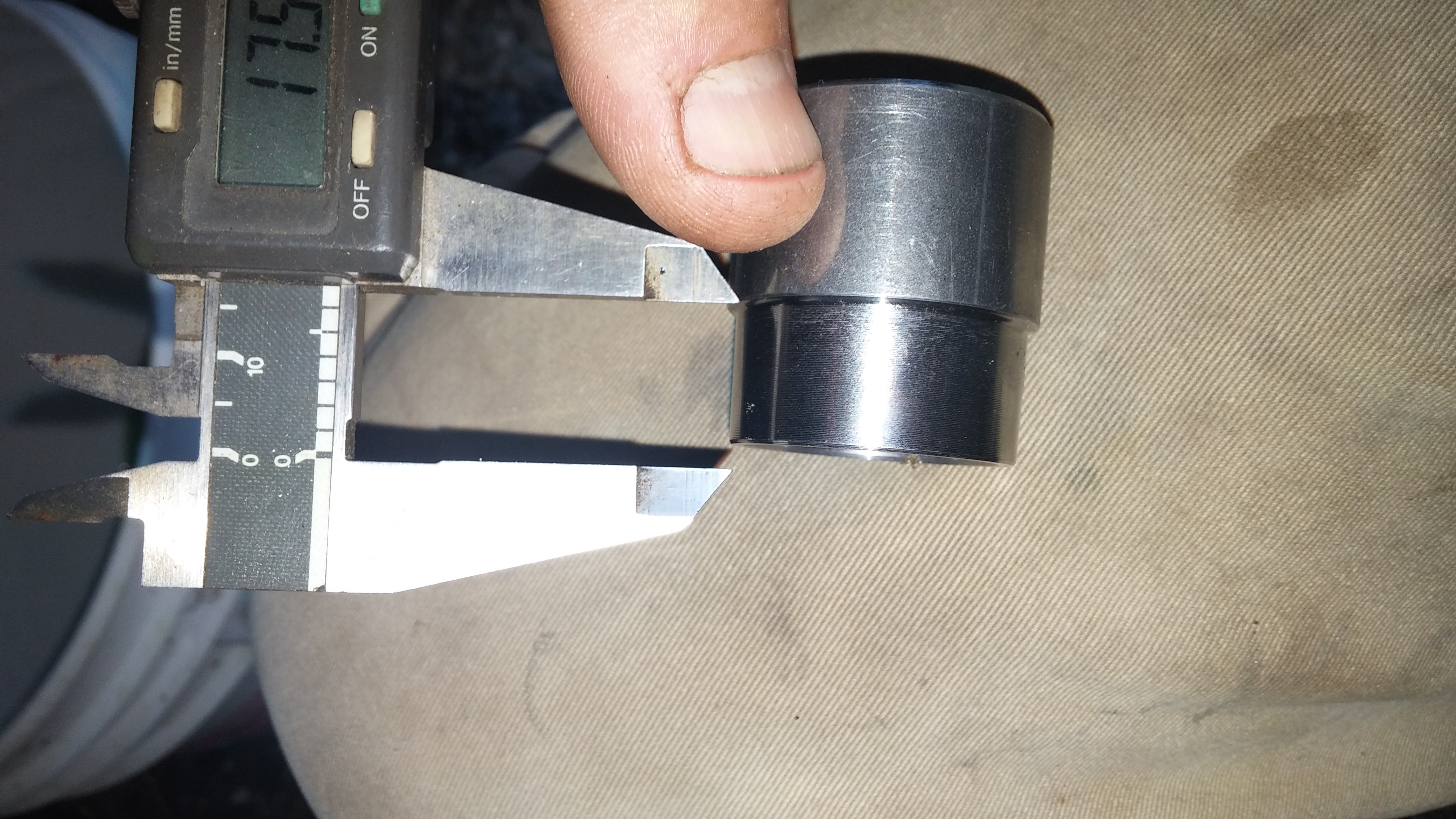

Once it was out I blew a bit of air in the radiator to push out more coolant. once the coolant finally stopped completely I buffed the inside of the hole with a piece of scotch brite to clean out the old sealant and remove any paint around the edge. Once the hole was clean I measured the depth of where they stopped machining the hole it was back some from the cylinder liner. The depth was about 17.5 mm, the depth of the taper on the bushing was well under that.

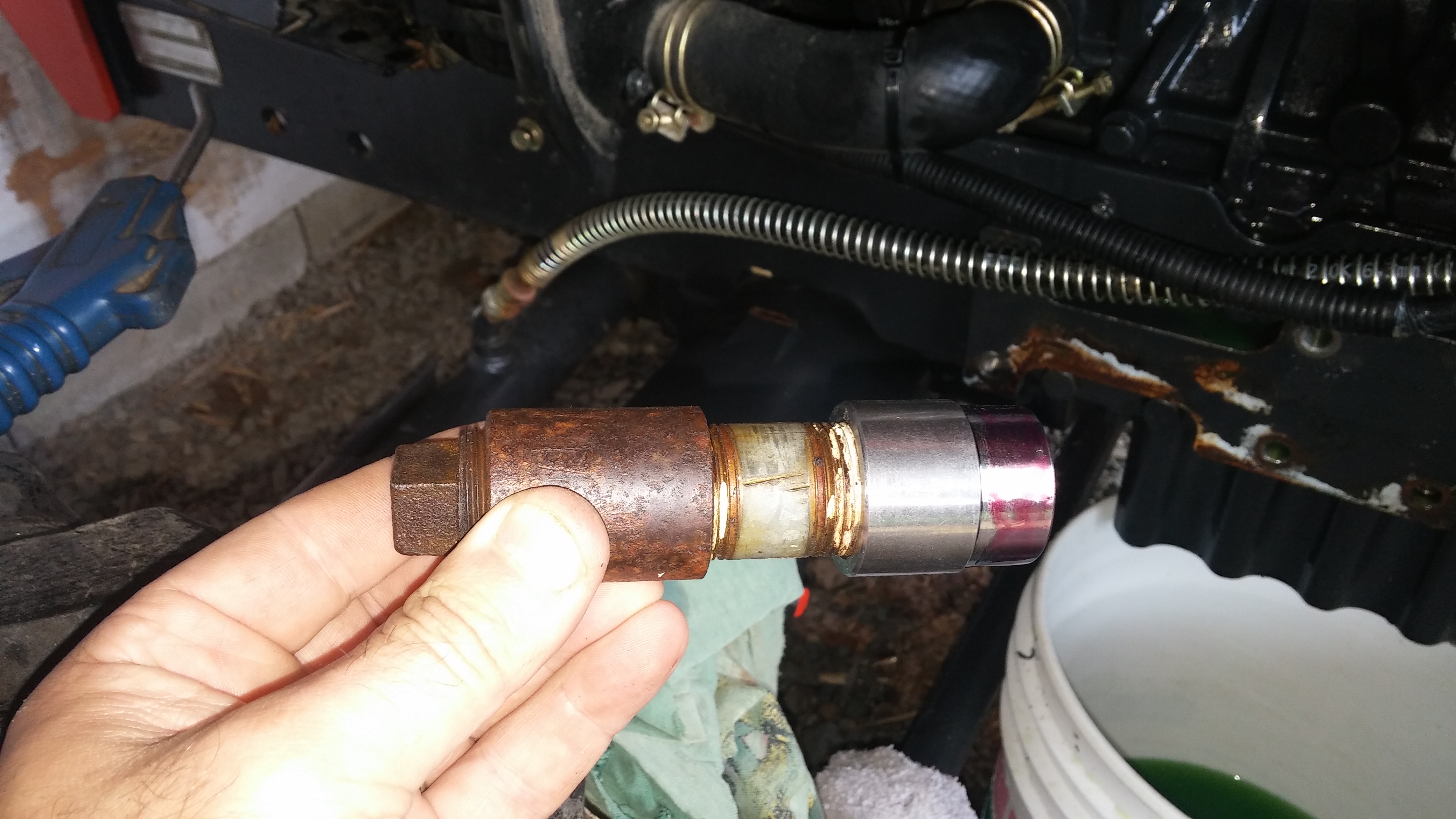

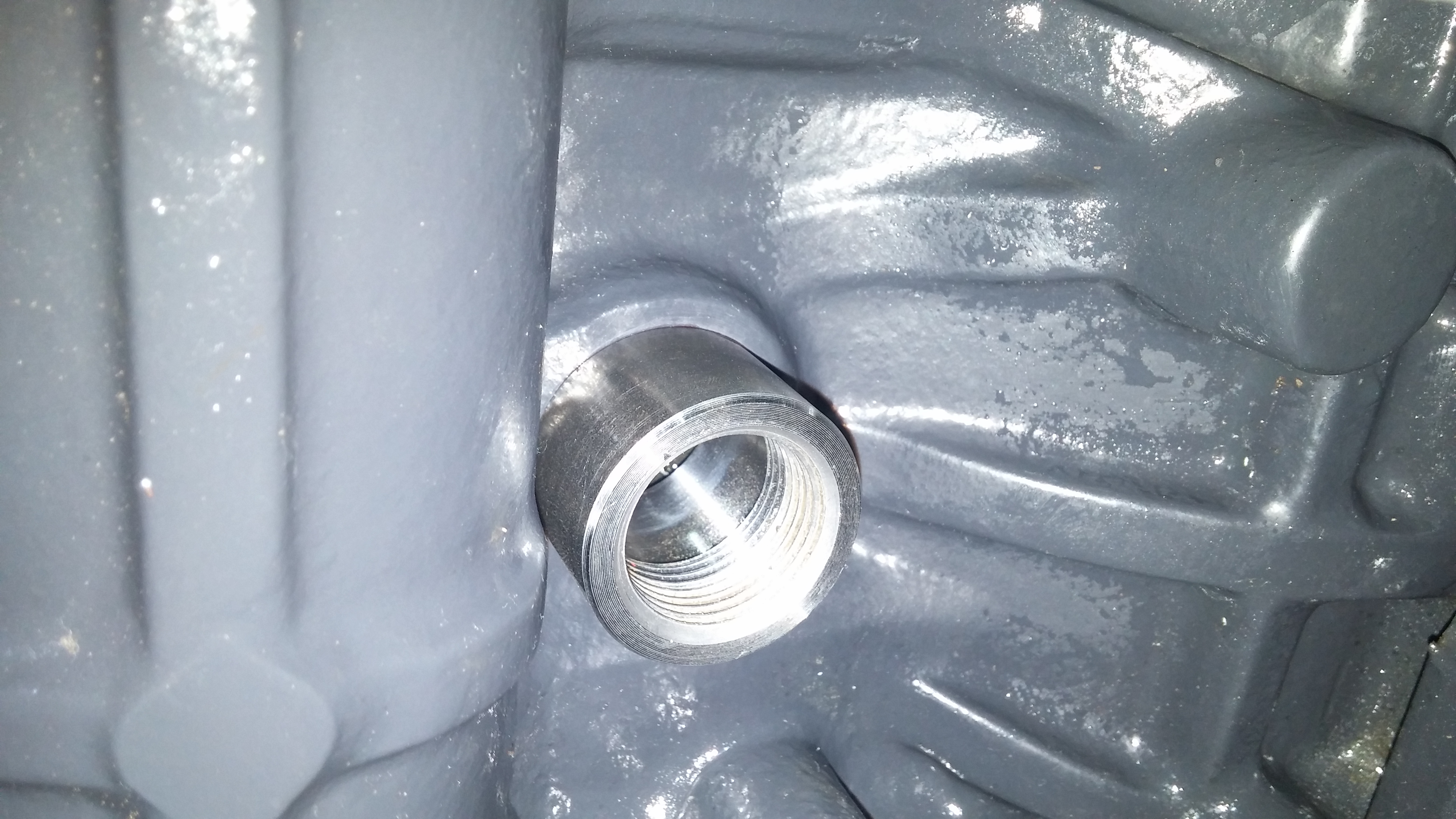

I applied red loctite to the bushing and the hole then used a fitting stack I had to drive the bushing in with a hammer. I drove it until the bushing was against the block. It is a very tight fit and have no worries about the bushing ever coming out. It is much tighter that the freeze plug ever was.

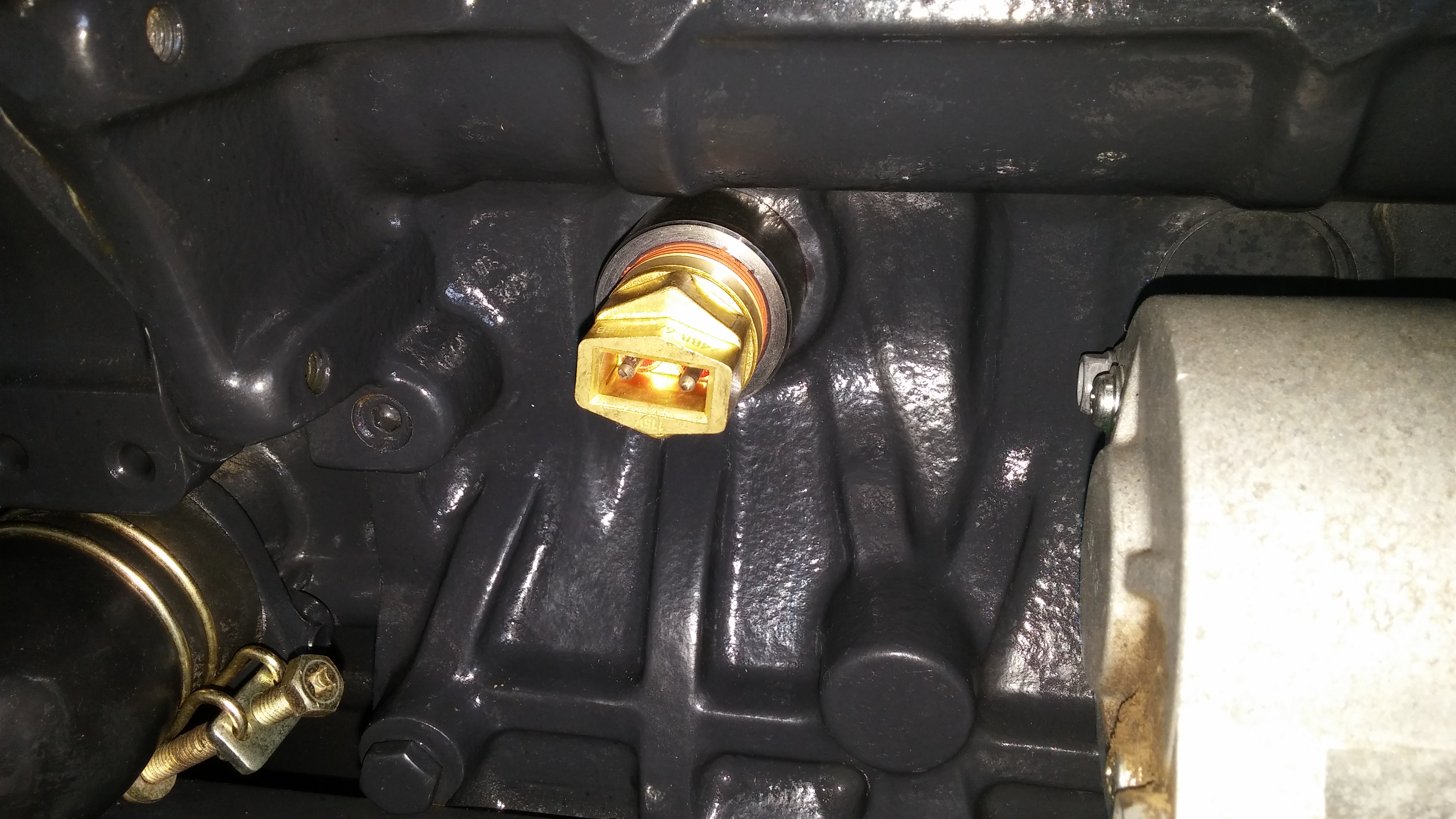

After the bushing install I installed the heater then filled the coolant back up then ran the tractor and looked for leaks all was good so I put everything back together.
