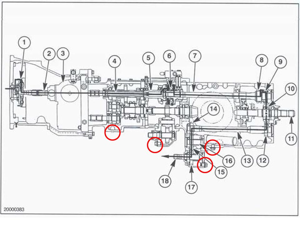

Todd, if you are approaching the 50 hour service. There is no recommendation to change the hydraulic fluid. This change is only for the filters according to NH's maintenance schedule. The first change interval for hydraulic fluid is at 300 hours. If you are at 300 hours, I would sure use NH 134D or NH F200. You will find that when you remove both sump drain plugs, you'll only drain off about 7.5 to 8 gallons. You will probably have plenty of oil if you buy a 5 gallon pail and a 2-1/2 gallon pail. You don't need 10 gallons. However, if you are going to do the front differential and drop boxes, you'll need more fluid and 10 gallons might come in handy. Just be sure that when you refill the hydraulic reservoir, you put in about 7.5 gallons and run the tractor for a minute and then recheck the level.
Jim/Anyone, is there a way to get more than the approximately 7.5 gallons out of the main section than just by using the two plugs? I see there is a section near the front of the tranny that has no plug to drain it and may contain as much as a half-gallon or more. Can't see why NH didn't put one of the drains there. Seems like I recall a plate with about 20 or more screws about half way back on the tranny that although won't help to drain anything more than the two plugs, might provide access for getting a hose in so one could reach the front otherwise inaccessible section. Thoughts???
A Class III 4WD New Holland has three drain plugs to drain the transmission, rear axle center section, and 4WD drop box.
In the spirit of "I can split this hair thinner than you can," there are 4 drains on tractors with a mid-PTO attachment.:laughing: The illustration showing locations is attached.
The Owner's Manual only calls out two drains for the Class III Boomers, perhaps because the 4wd drop box and mid-PTO probably hold less than a pint of fluid each. Even if they held a quart, you will rarely see over 8 gallons drained even though the Owner's Manual says the reservoir for an HST holds 9.6 gal and the 12x12 transmission holds 9.2 gal. If you add the volume of fluid in the filters, main pump, hydraulic lines, HST transmission, transmission cooler, 3PH, maybe loader and backhoe, I can see where at least 1-1/2 gal of fluid might be trapped. I just accept the fact that I'm going to have 20% old fluid remain in the system when I add 80% fresh. It is what it is and I don't lose any sleep over it.:thumbsup:

Rick and Jim, thanks for the informative replies. I must somehow have missed them and got real busy back in early March, or whatever other weak excuse might fit. Anyway, I'm not sure where I got the idea of only two drains, if from the manual or just a quick visual check or what. Jim, the copy of the diagram from the service manual was extremely helpful. Now that the weather is warming, I'm getting ready to tackle this job.
I understand that I won't get out all the fluid, but I've had somewhat unsatisfactory hydraulic 3 pt response in the winter and so I'm switching to Amsoil synthetic multigrade, hoping for some improvement. I've bought plenty of fluid so I'm hoping to get out as much of the old fluid as I possibly can.
With that in mind, would you agree, to drain the 3 pt lift, internal cylinder, I should lower the links? Or doesn't it matter, even though the cylinder only operates in one direction under pressure, do they fill the back side of the piston with fluid (like a two-way) anyway?
Yep, you might get a half-pint to a pint more fluid with the 3PH lowered. On the tractor, the major amount of oil will be in the HST and cooler, with some trapped in the PTO plumbing and the main hydraulic plumbing. The rest will be in the loader and joystick plumbing. You could disconnect fittings and drain oil, but the likelihood of ending up with a leak far outweighs the usefulness of draining every last available drop of fluid. You will have about 85% Amsoil in your system just by draining and refilling. If you do it again in 300 hours, you will end up with over 95% Amsoil. I think trying to get every drop of the old oil out is a lot of grief for a little bit of gain and not worth the hassle.:)
