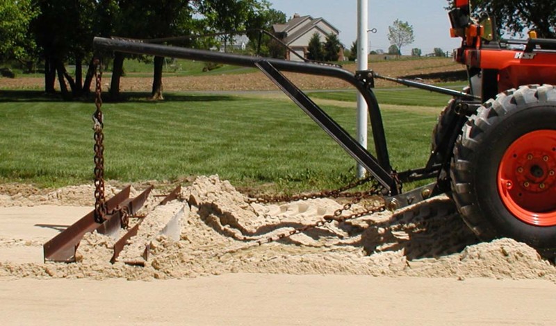

I saw the above photo on one of the TBN posts. I thought it was called "driveway fixer". Sorry I can't give good credit for it.
This thing works and is easy to use. I built one 10' wide for next to nothing. The boom was $80 and used I beam sells for about $0.15 per pound. Add some chain and you have a tool that will surprise you. It is the implement attached to my tractor right now.
A 10' wide one of these will really put down a smooth surface. I have 68 hp and the tractor idels with this thing. Shorten it according to the hp you have available. Easier to cut it shorter if it is too long, than to cut it longer if you find it does not use your available horsepower.
It will take multiple passes to get a really smooth surface, but so will other implements.
