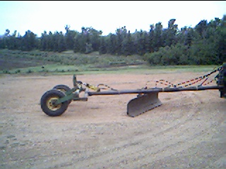

Thanx for the tip about resolution - I found the proper setting and tried--Eureka!!! Presto!! Whatever!! The "T" frame of this is made from 4" sch 40 pipe that my brother "inherited" on his job. Price was exactly right. The carriage was from a No. 100 John Deere cultivator that I converted to a 3pt mounted. The blade was made from 20" oilfield casing that I aquired years ago- don't remember cost- probably just over junk price. I also went down to the county road shop and got some old grader cutting edge from them at no cost and bolted that to the bottom of the blade. Hope all this helps.

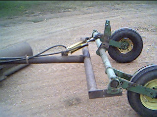

Another view

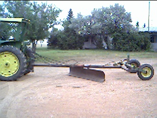

And another

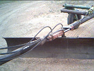

And one more
