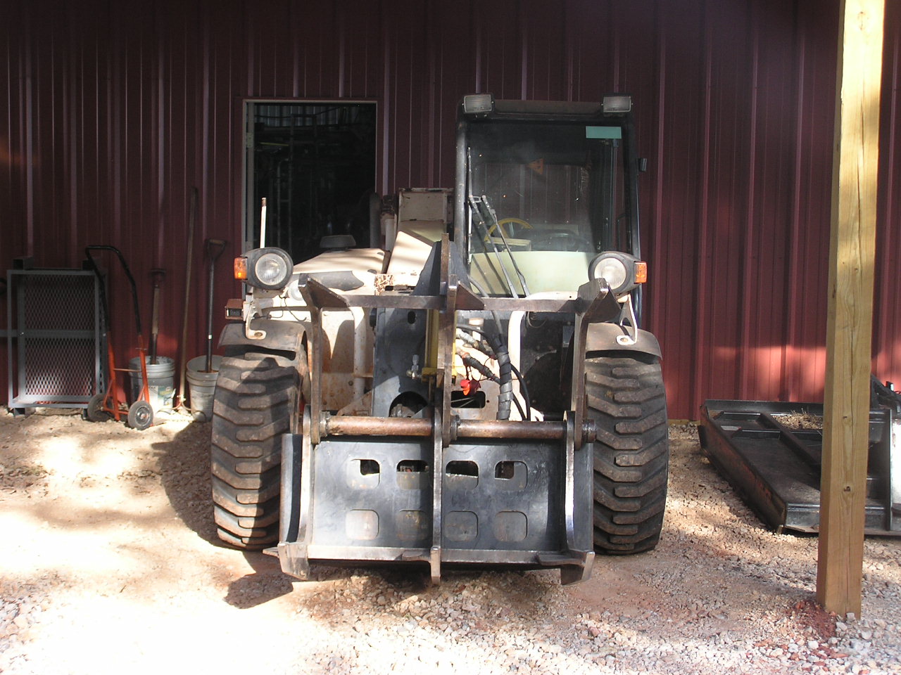

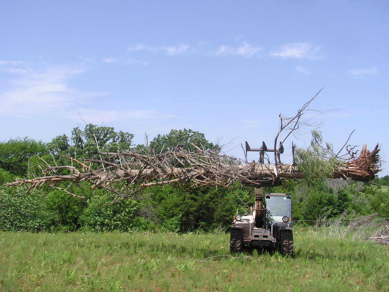

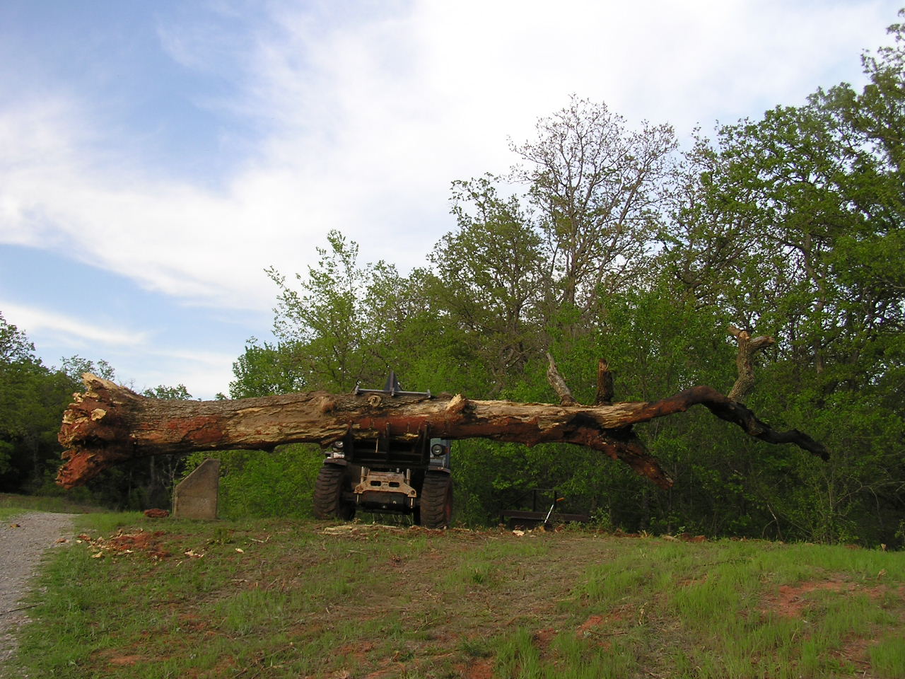

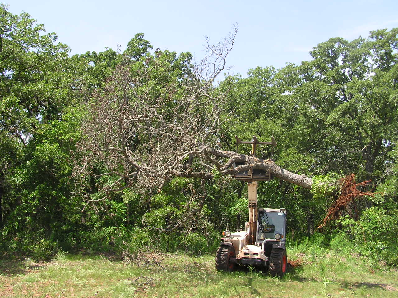

Grapples are great, but not really much good if you don't have enough width on each side of the tractor to carry a log out.
In my experience grapple width is not needed for carrying logs or trees.
This grapple is 44 inches wide, same width as the SSQA.
Find the balance point and you don't even have to clamp it with the top tines.
