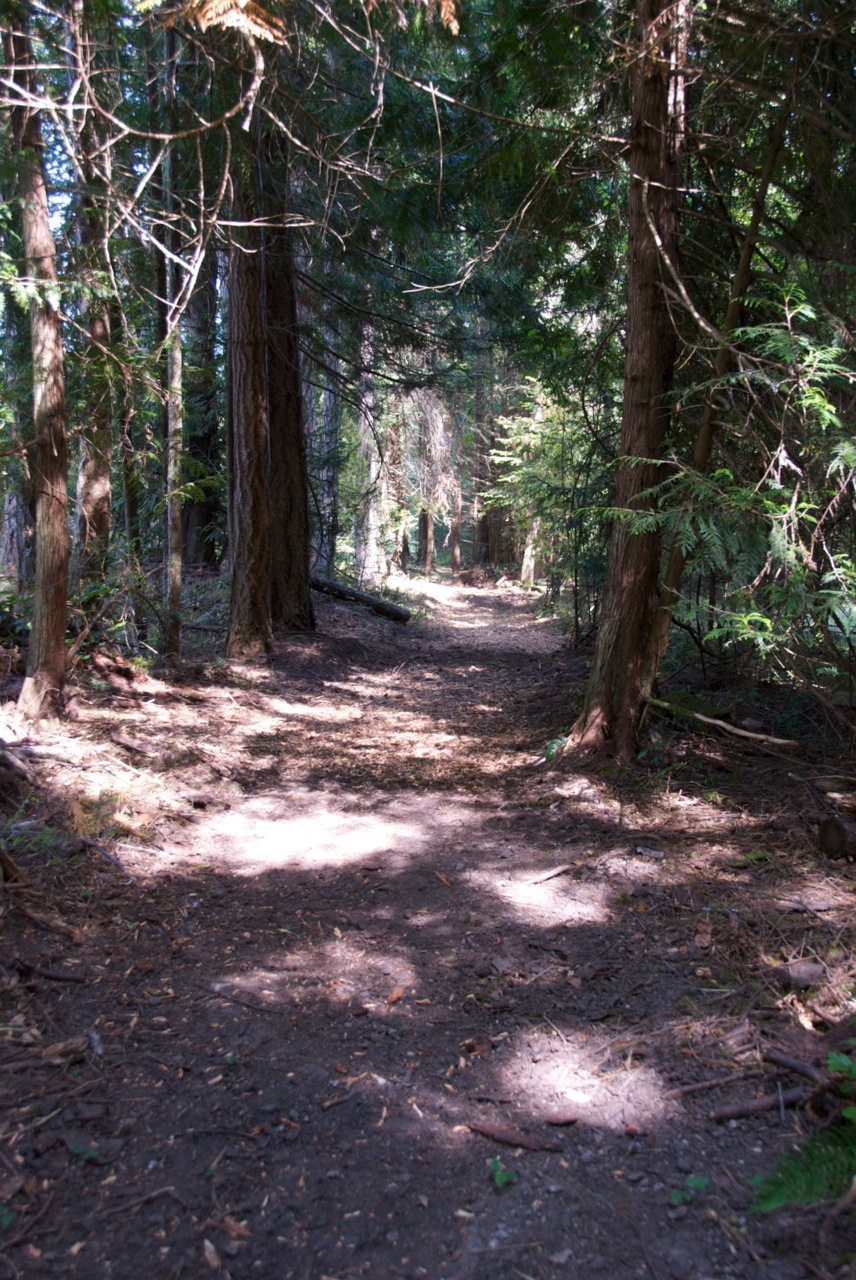

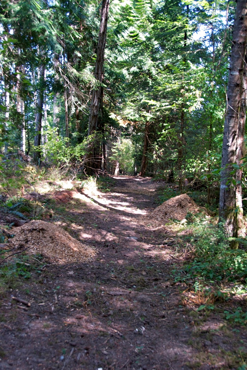

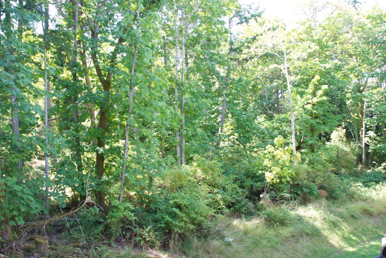

I've just finished about the first mile or so of horse trails through our woods. I have a L3130 Kubota with FEL, 6' box blade and backhoe. The underbrush was dense. First pass involved using the chainsaw to take down anything the tractor couldn't push over and to rough out the clearing. I bucked this and laid it aside. Second couple of passes was with the box blade, teeth projecting an inch or so below the blade so I could tear up the surface and any smaller plants while trying to leave large tree roots untouched. There were some places across streams and watercourses I needed to install culverts and used the backhoe to excavate and backfill. Lastly, I chipped all the slash to form trail dressing.
I've attached a couple shots, one shows typical density of underbrush before I began, the others a view of part of the completed trail. The chipped material which has yet to be spread can be seen in piles at the edge of the trail.
I should add I took down just about all the maples, young and old, along the trail or on the side of it - they're the widow makers in this neck of the woods.
