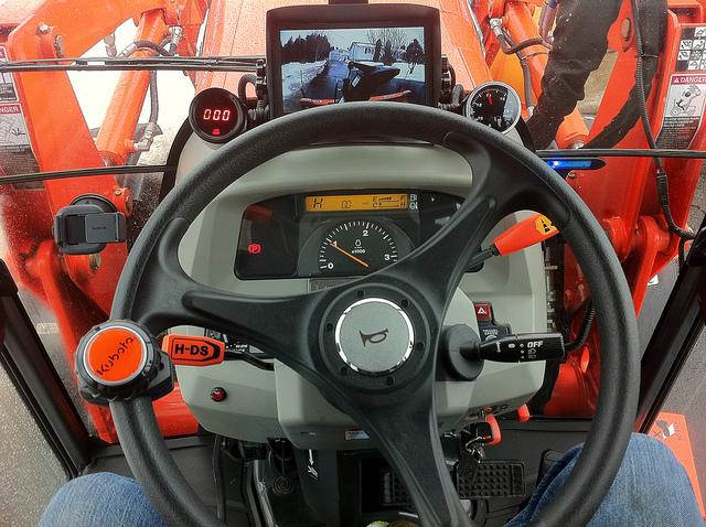

I've made a few mods and I think they're great for my needs. Now that I got it all done I have to do it all over again on the new Kubota 5740HSTCC3 I have ordered :confused2:
- Modified the FEL tubes for storage area's by machining custom caps for the tubes.
- Modified the truck plow to adapt to the tractors FEL.
- Modified the bucket by adding a top guard and hooks.
- Added custom built emergency light bar and strobe light to the top of the cab.
- Added L.E.D. strobe lighting to the rear of the snow blower and built custom boxes to house them in.
- Added custom build boxes to the plow so Super Nova L.E.D. strobe lights could be installed adding extra lighting to the FEL side on when plowing.
- Added a reverse beeper. (not a small task on these tractors)
- Added a reverse camera with a color 7" LCD monitor that is also inferred and has a built in microphone in the camera it's self. The camera was adapted to the top rear light making it appear that it was always there.
- Gauge pods were added to each side of the LCD monitor and an ambient air temperature and digital volt gauge was added to each pod.
- Two RAM mounts were added in the cab for mounting various items like my phone and MP3 recorder. Also a new mount was just installed for the new IPhone 4
- A moisture sensing system was adapted to the wiper system so when I'm using the tractor the wipers will work automatically when snow or water is present on the windshields. That way I don't need to be switching the wipers on and off myself. The system takes care of that for me.
- Mud flaps were added to the front fenders to help keep the water off the front glass when traveling the machine.
- All powder coated upper mud flap hardware was removed and replaced with stainless hardware.
- All common steel hardware that was present on the snow blower was replaced with stainless steel to prevent corrosion.
- Some custom badging and company lettering was added to the tractor.
- Custom trim was added to the rear fenders to give it a more refined look.
- Added a parking brake warning light. Well a better one that came with the tractor
- The rear factory lollipop top lights that came with the tractor were replaced with L.E.D. lollipop lights.
- Added a few cool rubber holders on the snow blower to hold a shovel and bar.
- A LED light was added to the cab step so it's easy to see where to place your feet in the dark.
- I fabricated a custom front storage box with LED cornering strobe lights.
- Removed factory stereo and added a new Sony Xplod with Infinity speakers.
- Custom clock and interior temp clock.
- Modified the exhaust system so the soot would stop going on the FEL and it worked just PEEEEERFECT
Working on one new mod as I type this. Will post later.
Although there has been allot of stuff added to the machine you would never notice it at first glance. When I add or customize anything my goal is to make it look as if it's always been there.

4shorts, Good stuff! I really like the reverse camera idea sure will make putting the Backhoe on a lot easier. Where did you purcahse it?
   / Best Mod/add on to compact tractor or attachment #47

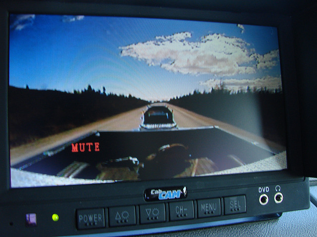

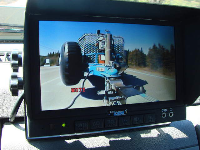

Thanks. With the camera I used you can put up to three cameras o the machine and have them all up on the monitor at the one time or individually. One day before I got into this camera thing I asked the wife to guide me back to hook up the trailer. I won't go into exactly what happened but believe me when I tell you that these camera's are much cheaper than a divorce lawyer or even a burial :laughing: Yep. Worth every penny :mad:
   / Best Mod/add on to compact tractor or attachment #48
What brand? and where did you get it from? Sounds great!:thumbsup:
