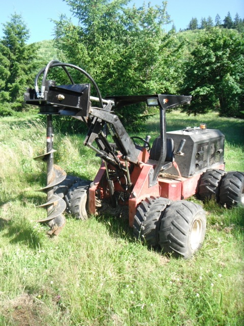

I made my own PHD for under 1K. I think I was at 850 or so with hoses. Steel was pre-cut and pre drilled, did my own welding (not much needed)

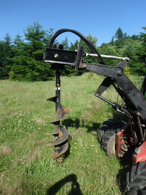

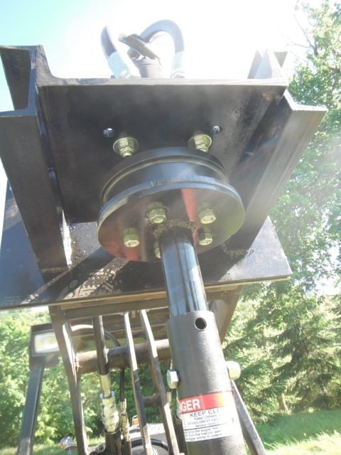

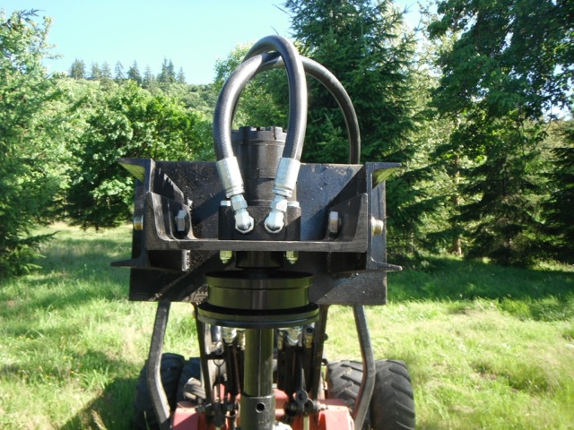

As requested. Basically come C Channel (big) and a bunch of pre drilled holes. A wheel motor with a hub. 2 plates drilled to match the wheel hub and a pipe welded on one to hold the drill. Motor came from Surplus Center. Auger was the most expensive item ($300) but I didn't want to take a risk on a cheaper auger.

WOW ! Nice. I did not gather that it was hydraulic based on your original post. Very good work. I see you have it so it swivels forward to back.
   / best post hole digger for less than $1000 #29
And left and right. The Tractor is rated to 45 degrees and I am planting trees on slopes so the "gimbaled" head is nice. It does have extra holes where I can run a bolt through to lock it in place.
   / best post hole digger for less than $1000 #30
Oh wow, left to right must be behind the plate? Nice machine as well. That will handle some nasty terrain for sure.
