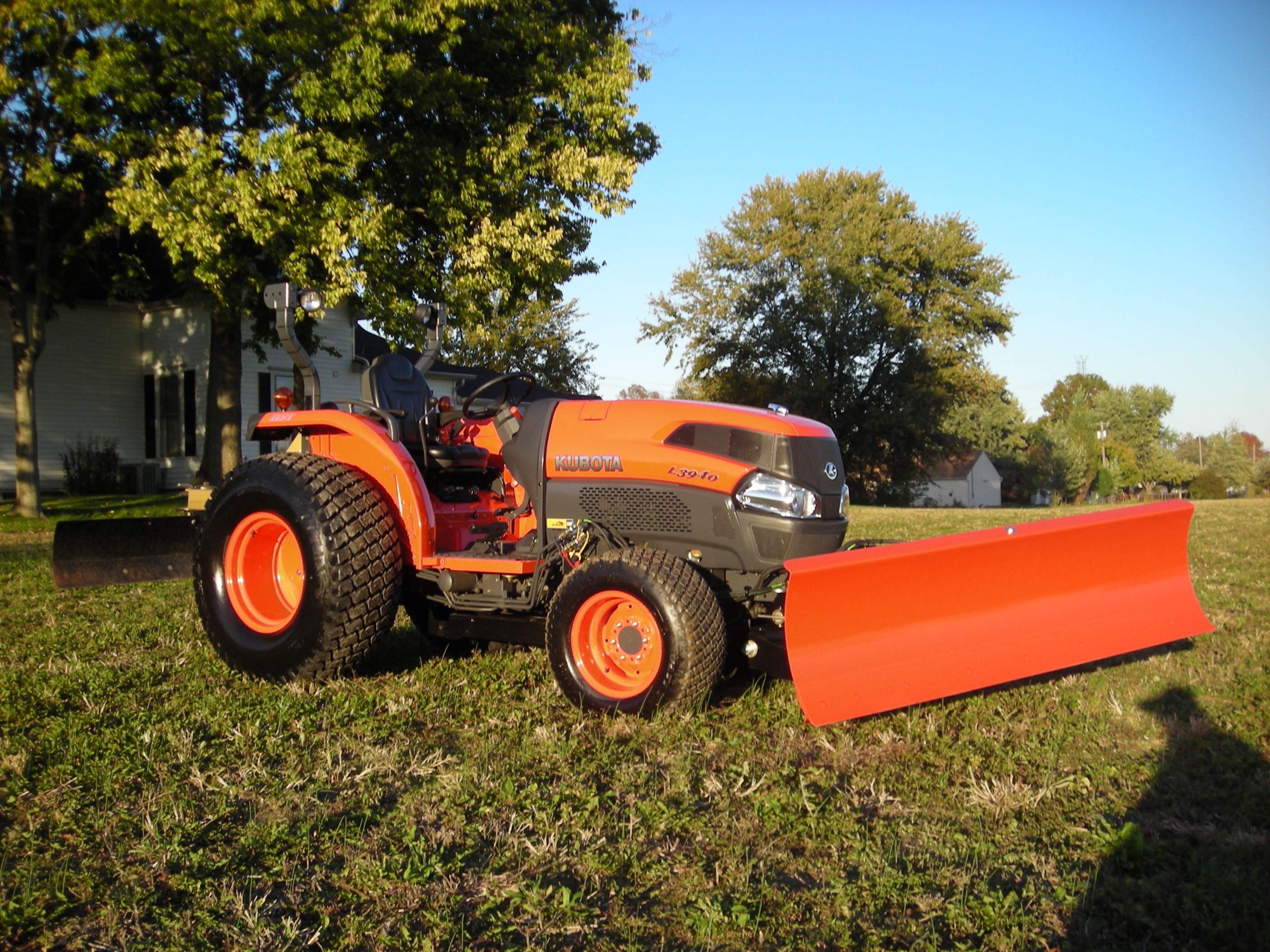

I use this in central Indiana for quick clearing of a long driveway. Philip.
That would be perfect. What size is it? Where did you purchase? And how much if you dont mind me asking?
For Grand L series. $3700, included installation, sub-frame/quick-hitch, 7' blade. Philip.
