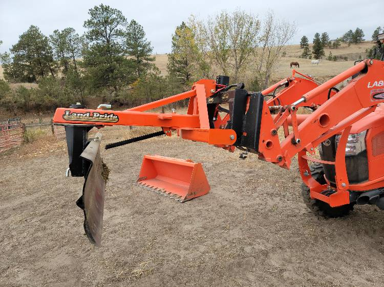

SSQA plate with a 3pt Quick Hitch welded on it was my plow mount for an old plow on a former tractor. Worked well. Cheap & was pretty easy to build to mount a light jeep plow from a garage sale. It stuck the plow out quite a ways & caused the plow to push the tractor around a bit more.
Built a new SSQA to 3pt for the new tractor to move impliments around but don't use it to much. My new plow has a dedicated solid SSQA attachment. I miss the flex in the old mount. Adding on the extra 6-8" decreases capacity a bit & it can be a bit hard to see behind the hood to hook things up.
