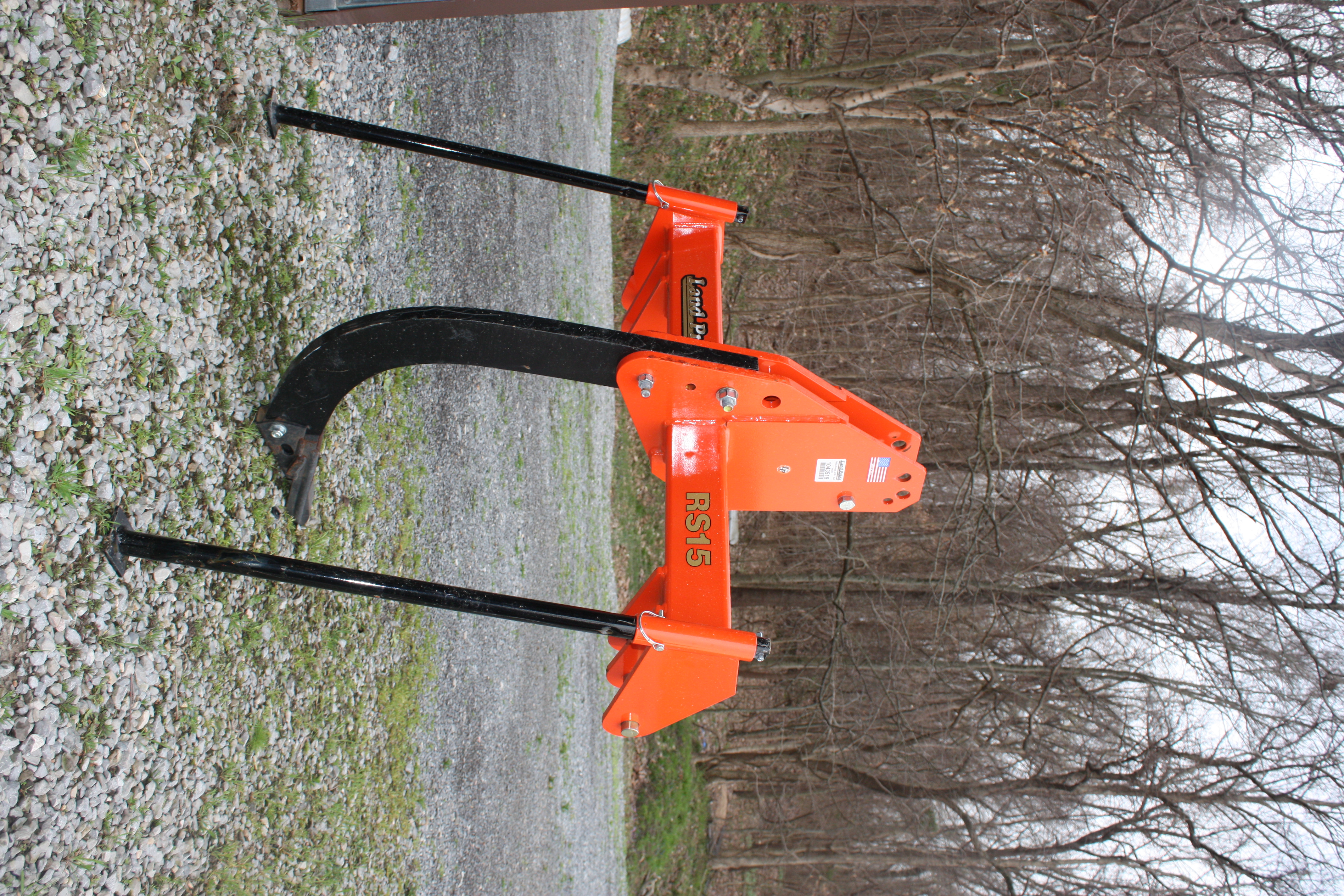

This Land Pride works we on our L5740HSTC and M8540HDC, but thes don't work well on very big roots.

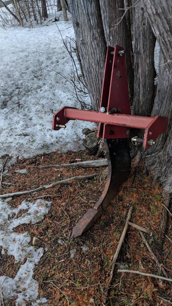

   / Best Subsoiler/ripper #8
I just bought this old beast from my neighbour. It has been leaning against a tree on our property line for years, but I never owned a tractor...until now. It will be interesting to see who wins, tractor, subsoiler, or the ground and roots.

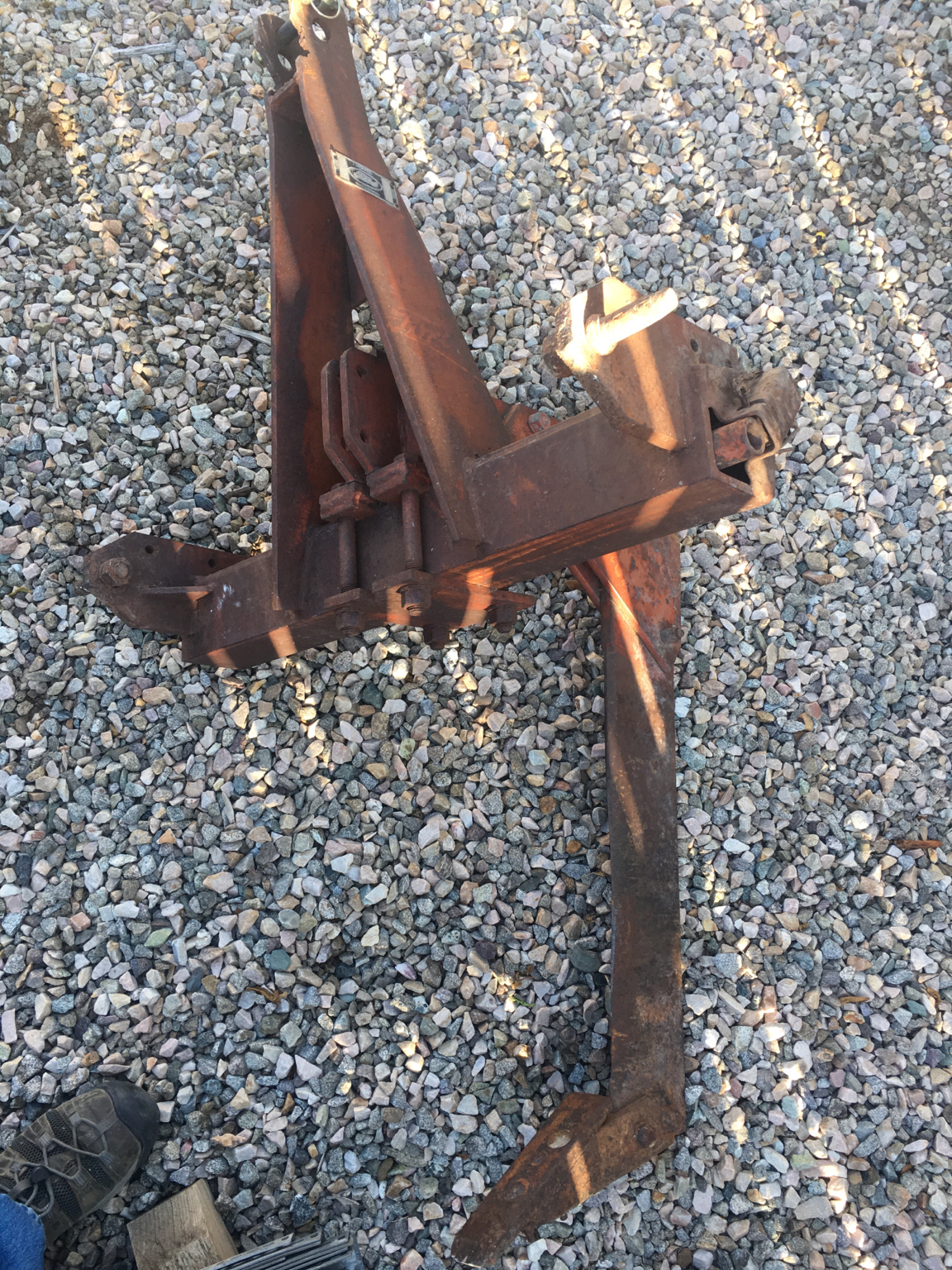

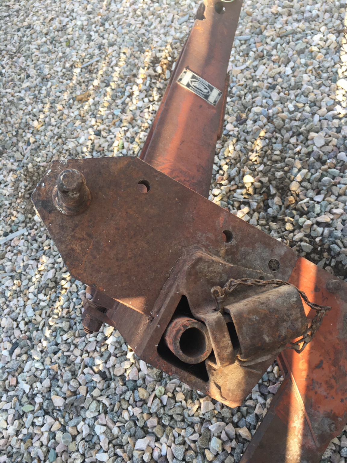

   / Best Subsoiler/ripper #9
You might try looking for an old Fold subsoiler. I bought this one a couple years ago for $100. It has a straight edge that should do a pretty good job of cutting through roots.
The blade part is 3/4” thick, so it is pretty stout.
I was able to order a replacement cutting edge from Agri Supply.
The legs are stowed inside the main beam. With the legs inserted, it stands upright so you can easily hitch it up.

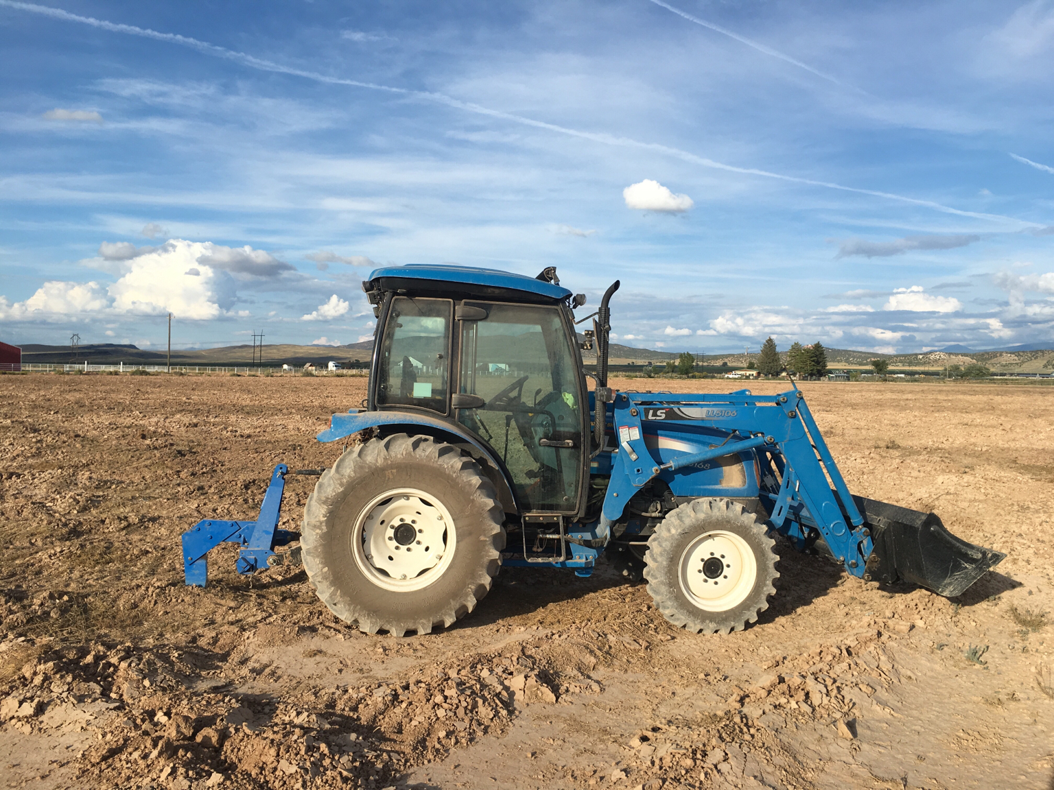

Here is it after some paint behind my 68hp LS. In this picture the point is about 20” below the surface.
