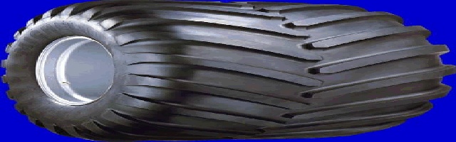

So here is an idea for the "ultimate flotation tire":
The GlueGuy

And what size implements would be required to cover those tracks/w3tcompact/icons/crazy.gif

Jeez - before you adapt your tractor for that stretch monster you should consider just adding caterpillar tracks to it. Now that's flotation ...

He didn't mention anything about covering tracks. He asked for floatation. /w3tcompact/icons/laugh.gif
You go changing the specs on me, and it's going to cost extra. /w3tcompact/icons/wink.gif
