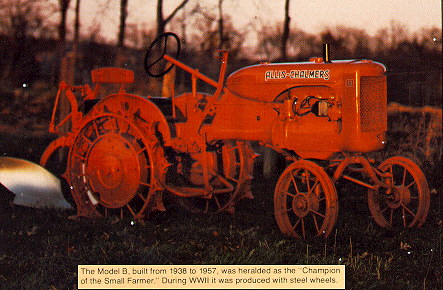

These usually seemed to do the trick on my granddad's
Allis Chalmers WC. /w3tcompact/icons/smile.gif

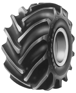

I dont know how to post pictures. But perhaps one of the wizards could get the pictures of the following tires from the online Goodyear Farm Tire Handbook:
R1W = Goodyear Super Traction Radial DT810 and DT820
R2 = Goodyear Special Sure Grip TD8 bias ply and radial
HF4 = Goodyear Custom Flo-Grip (<font color=blue>THE ULTIMATE ANSWER?</font color=blue>) Gotta see the picture.
   / Best Tire for Boggy Ground #36
super traction radial

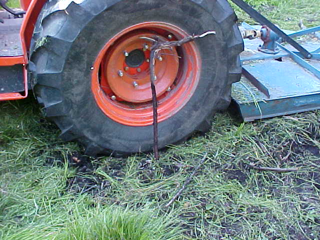

Glen, Im not quit as wordy as you or others on this form but I do have a camra and a bog. As you can see by this first photo their is a stick next to the tire, maybe about 22" long. Stay with me now...........
Rich
   / Best Tire for Boggy Ground #40
OK, now we know we have a long stick, here's the same stick but just pused into the ground, you can still see the top of it. No I didn't hit it with a hammer, just pushed it to the ground.
