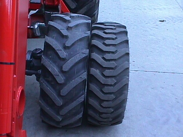

Glen, I dug this up, maybe it will help you get a better idea of the diff. in size. R4 / XM27 these are the fronts. The rears were to big to roll around. For what its worth I have had my L4610 in a bottom less bog that had a lot of small trees (1" or less) and tall grass brush ect. Went down in there and cut about 300 yd. of trails. They work way better than R4s
Rich

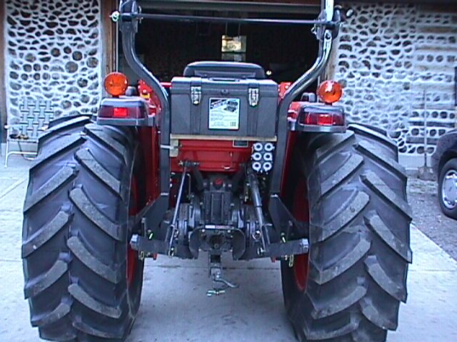

Here is a shot of the rear's
