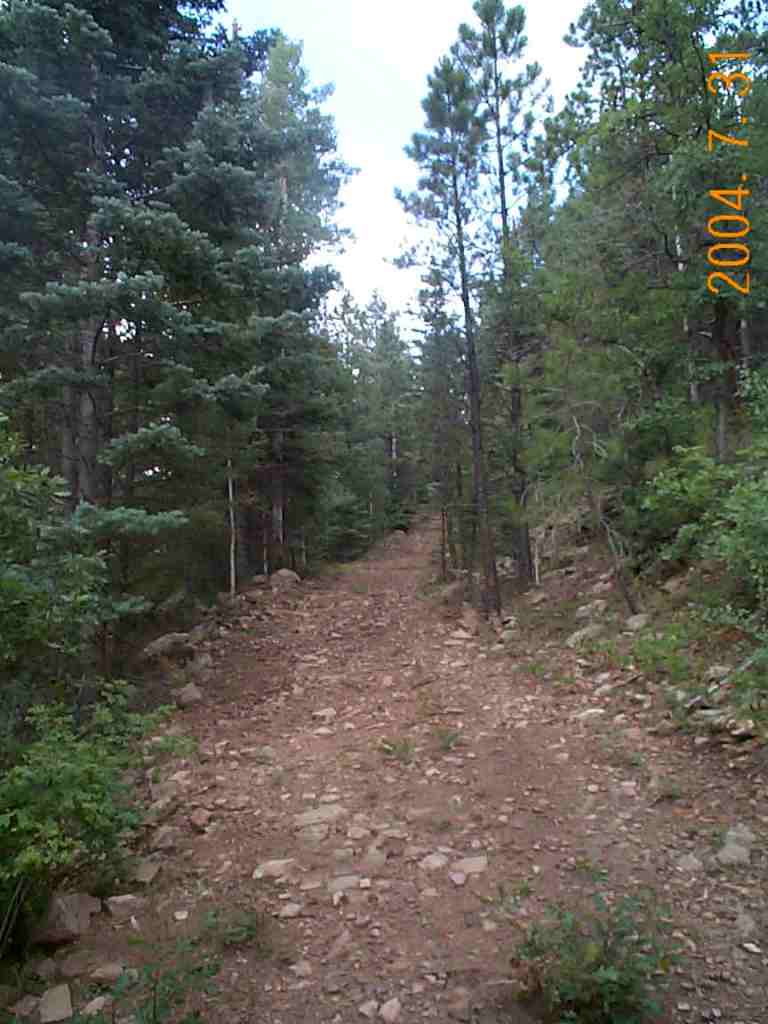

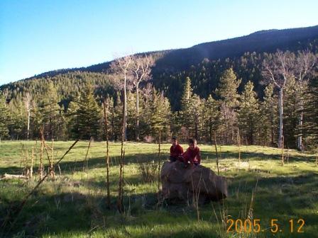

Wow, Vas, that is incredible land! Raised my estimate of New Mexico, for sure. I can't add to the excellent information you've gotten here, just felt compelled to thank you for posting the pics.

Looks and sounds like the country around Chama. I hunted elk up there maybe 40 years ago. Saw the railroad plowin' the passes on TV the other day. Great place!
