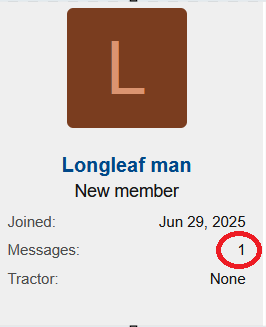

I suggest we start betting on how many days before OP replies. 30 days is my bet.
What is the winning prize? Suggestions
   / Need advice on a machine to manage timberland #22
So, 1 post total on TBN!
   / Need advice on a machine to manage timberland #23
Perhaps the two of us can keep this topic alive. :unsure:
Has AI progressed to the point where it is capable of becoming a TBN member??

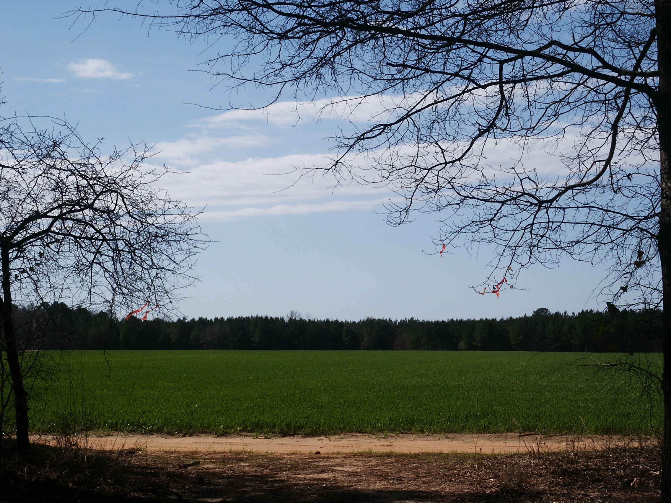

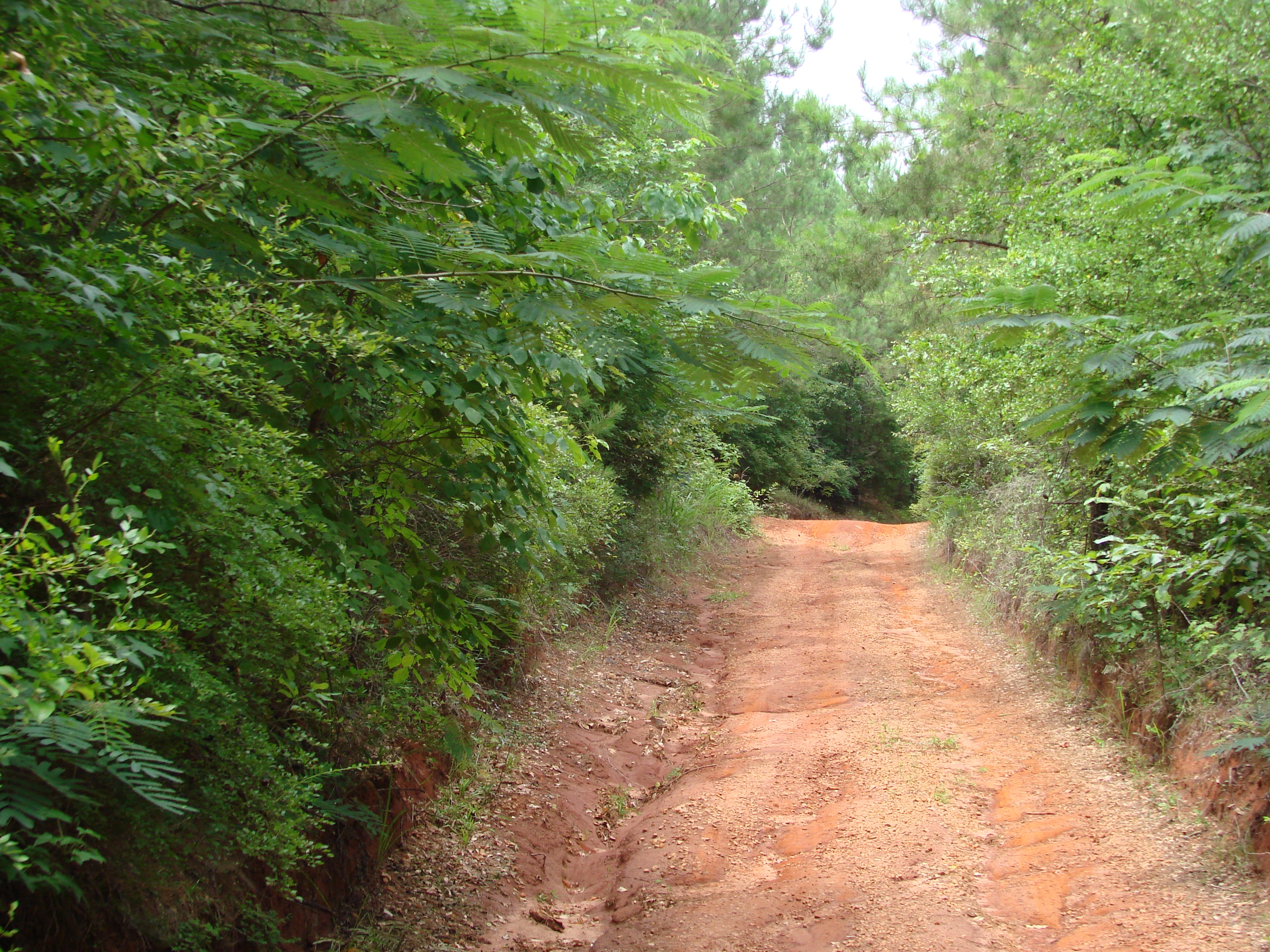

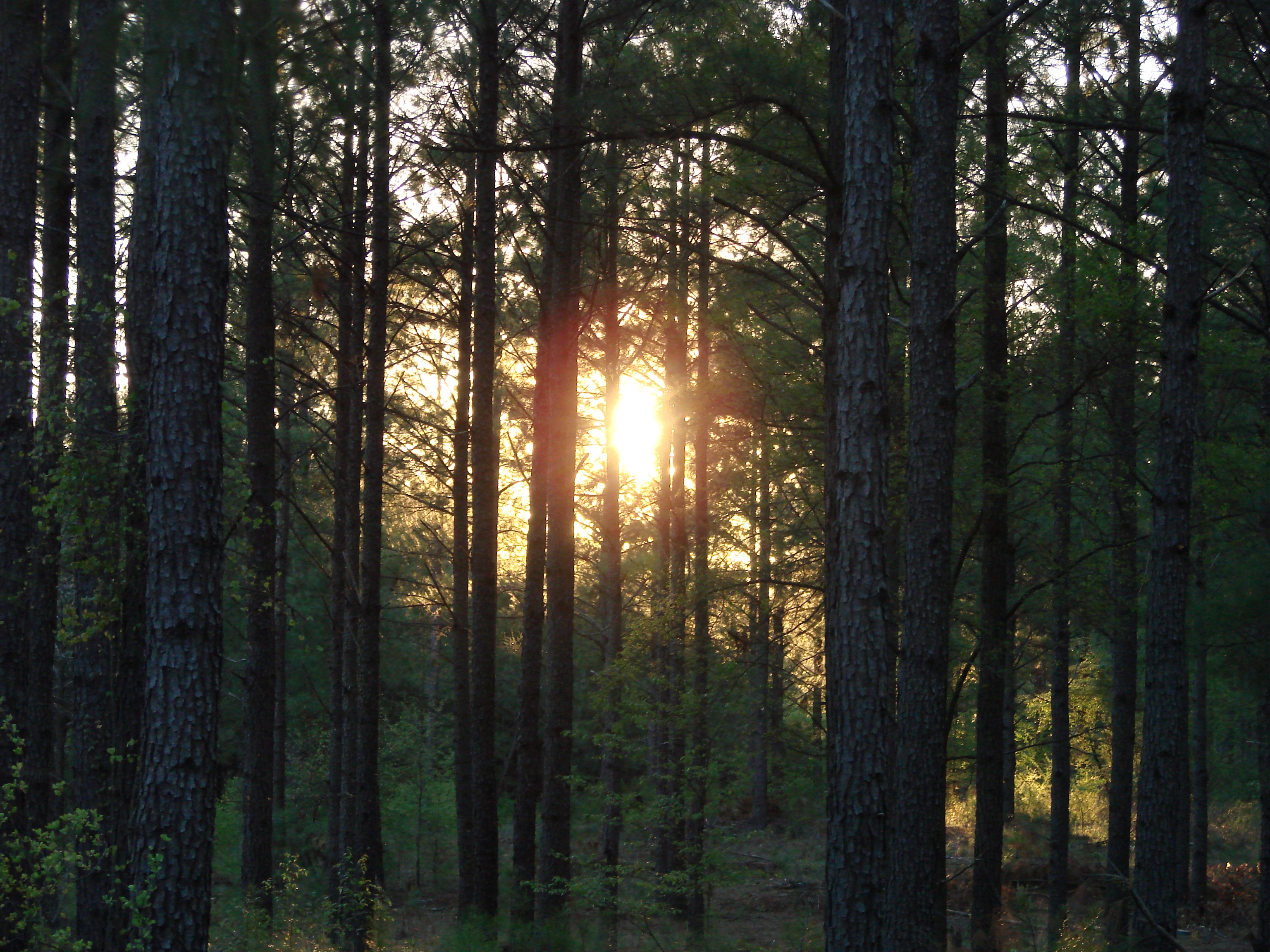

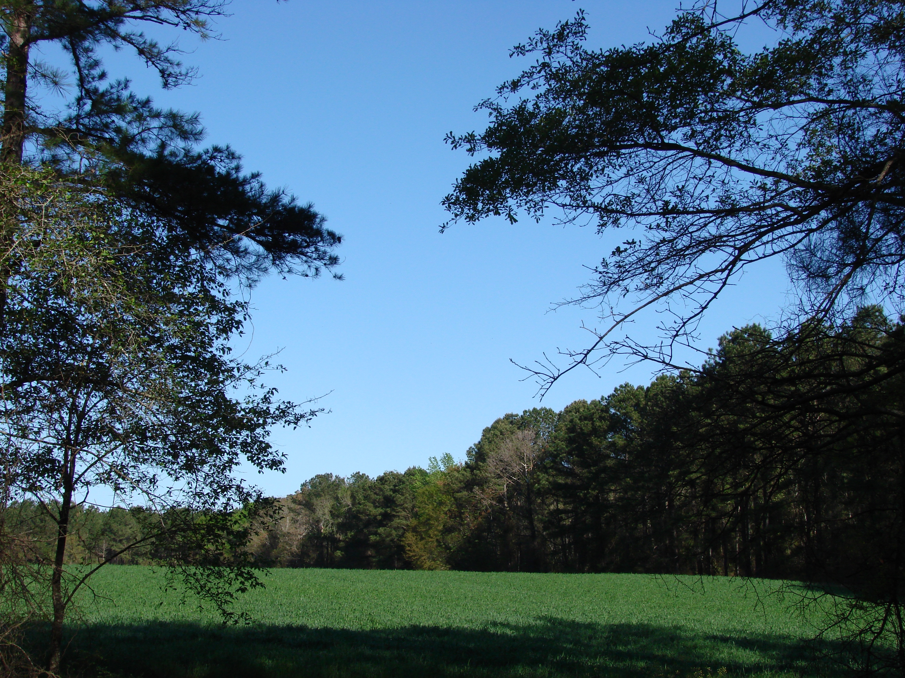

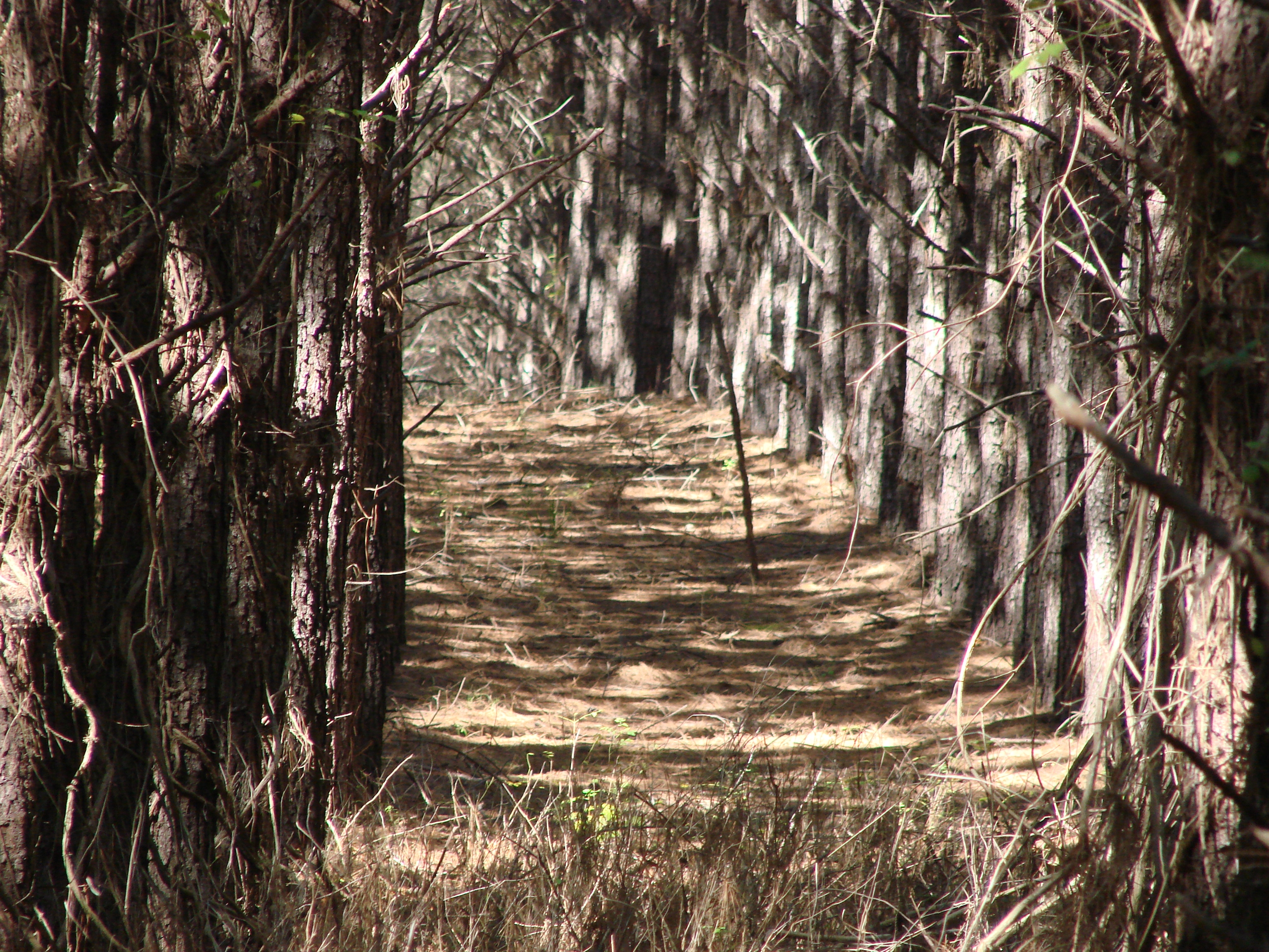

Thanks for all of the replies. You asked for more info:
1. The tree parcels are surrounded by open space sufficient for disking fire breaks. This was done at the suggestion of our consulting forester many years ago. As a result I do not need to push over trees to create the fire breaks. I think a forestry grade offset disk harrow would do the job. These implements are very robust and heavy so it would take a pretty strong tractor to pull them. Probably between 100 to 150 hp.
2. The tree parcels are between 40-60 acres in size. Terrain is gently rolling hills down to a river that makes up over a mile of our boundary. Some steep places but we have not planted pines in those areas and so they have natural growth of hardwoods. Hence no need to burn the natural areas.

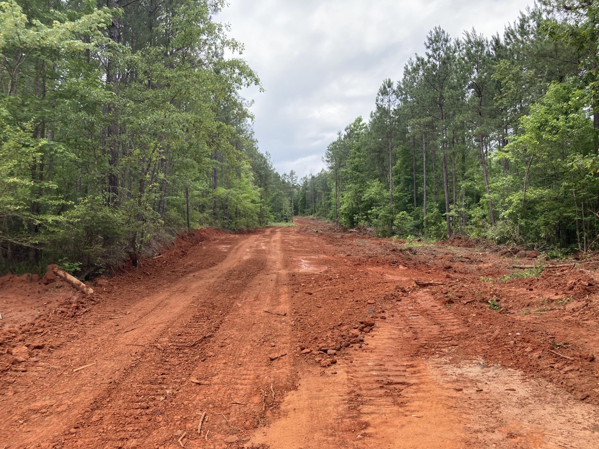

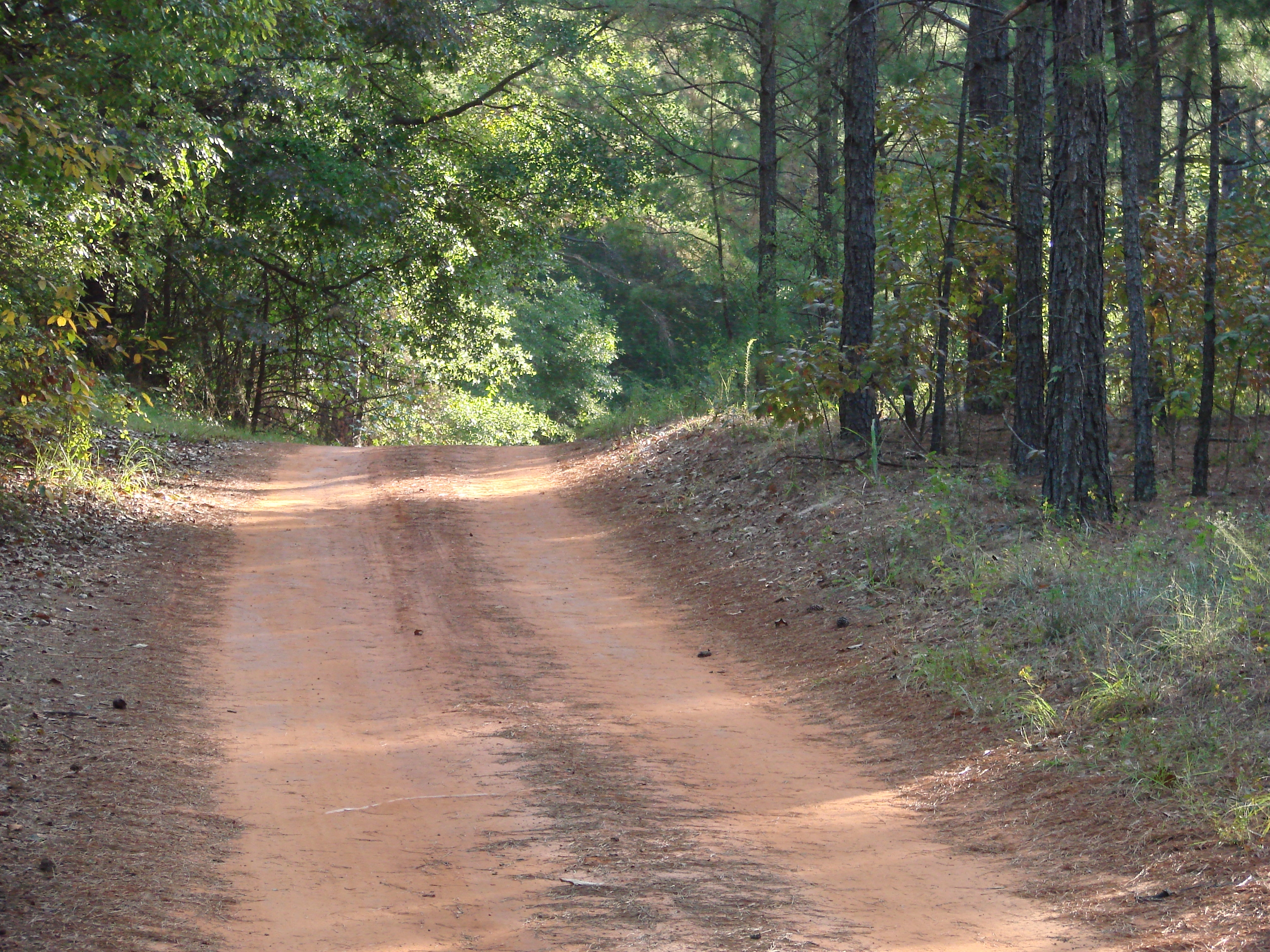

3. There are miles of roads. All dirt built by my grandfather and his farm hand many years ago. Some have been pretty badly eroded hence the need for more regular maintenance. There is a hunting club that leases the land and they are obligated to maintain the roads in the lease. Unfortunately they do not own the equipment to do the job. In the 1970s we had club members who were in the grading business and they had the equipment to do the work. Mostly bulldozers with blades and front buckets.
4. The soil is mostly Georgia red clay which turns to concrete when it gets very dry. Then turns to impassable mud when it gets wet. We have added some gravel in the worst places but there are too many roads to spread gravel at $700 per load. I primarily want to find an implement that will break up the red clay when it is dry to smooth out the pot holes and larger puddles. I can hire a bulldozer and operator to make water bars where necessary.

I forgot to mention that most of the roads were built by the farm hand on an International Farmall with a blade in the front. Surely I can find a modern equivalent to that tractor built in the early 1960s.

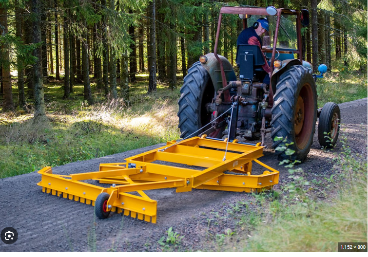

I would get a 60hp compact tractor and a used road grader
or this
Okay, I am amending my recommendation...
I would get a 100-150 hp tractor, heavy disc, and a used road grader

@Longleaf man thanks for coming back. I did maintenance for a few years on a 2000 acre woodlot in the Arkansas delta. I did not do any of the harvesting or thinning as that was hired out. The land was flat and it looks like your trees are mature. The soil was a clay silt so it did not turn as hard as your red clay. We did not have steep hills, but the levys were 10' tall in places and damn steep. My experiences might not apply 100% but there are lots of parallels.
I have a few questions:
  • what is your budget?
  • How wide are your fire breaks
Fire Break Maintenance
Do you have to take the firebreaks down to earth or just keep them mowed short? I know you have historically disc'd them, however in my opinion mowing is better as it is easier to drive on and reduces soil loss. Our firebreaks were 30' in width. In AR we were allowed to just mow them. I used a 15' batwing and a 7' single spindle rotary cutter on a 110 hp 4wd tractor. If doing maintenance on younger trees I would use a 45 hp open station compact to mow between the rows as the limbs prevented me from using a cab. If we needed to take the fire breaks down to soil I would use a medium or heavy duty tandem disc. We had some 12' tandem discs that once had wings that we removed. This gave us a nice strong small disc. I also did not mow with the loader on.

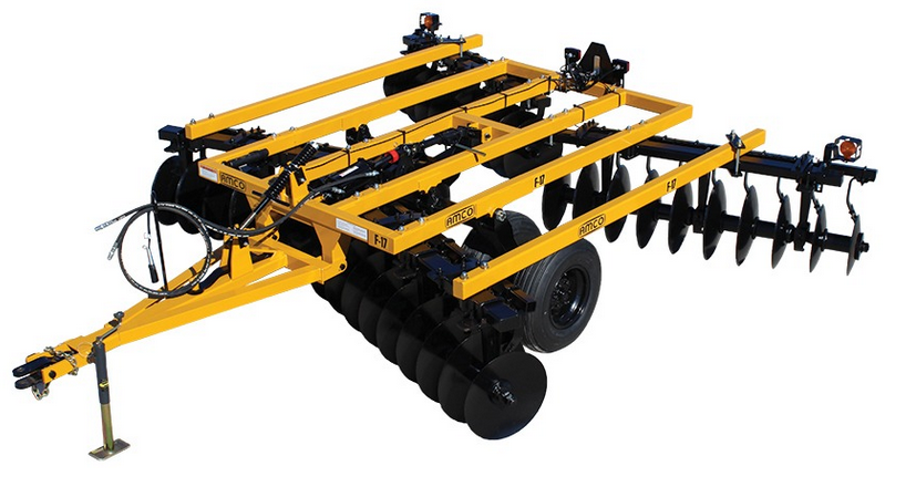

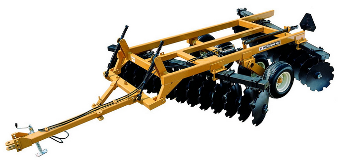

My experience is that offset discs are primary tillage and used for prepping the ground for planting trees. You will have significant soil loss and make it soft (and muddy) if using this on fire breaks. Deep tillage loosens the soil making it a muddy mess with rain. Also the deeper tillage can hurt the tree roots. Your goal with a dirt fire break is to remove the fuel from the surface, so go with a tandem disc, it will remove the fuel, and require a smaller tractor. Big tractors in the woods are not fun to run. We never took the 250 hp or 400 hp tractors in the woods for this reason.
offset disc
Tandem Disc
There a few implements that are great for smoothing the roads out. I would look at a quality landscape grader, aka land plane, aka grading scraper with scarifiers in the front to break up the heavy clay like a MK Martin LP878.
In some situations a back blade with full hydraulics could be handy for removing ridges that form on the side of the road and pulling that material back onto the road bed, and cleaning out ditches.
I would also consider a HD box blade it is nice for spreading gravel and roughing in roads. The scarifiers will do a better job of ripping dirt if it turns too hard for the land scape grader. But best of all it works great as a counterweight to keep you stable when using the loader.
I do not see were you would need to have much dozer work done if you keep up with the road maintenance. If you can elevate the roads and keep the water off your winning 3/4's of the battle. Any time we found a pothole on a road we would address it immediately as it will grow quickly if ignored. Since most of our roads were on top of levy's it could lead to a washout. Then we had to use the dozers and excavators to repair the 4-10' tall levy.
