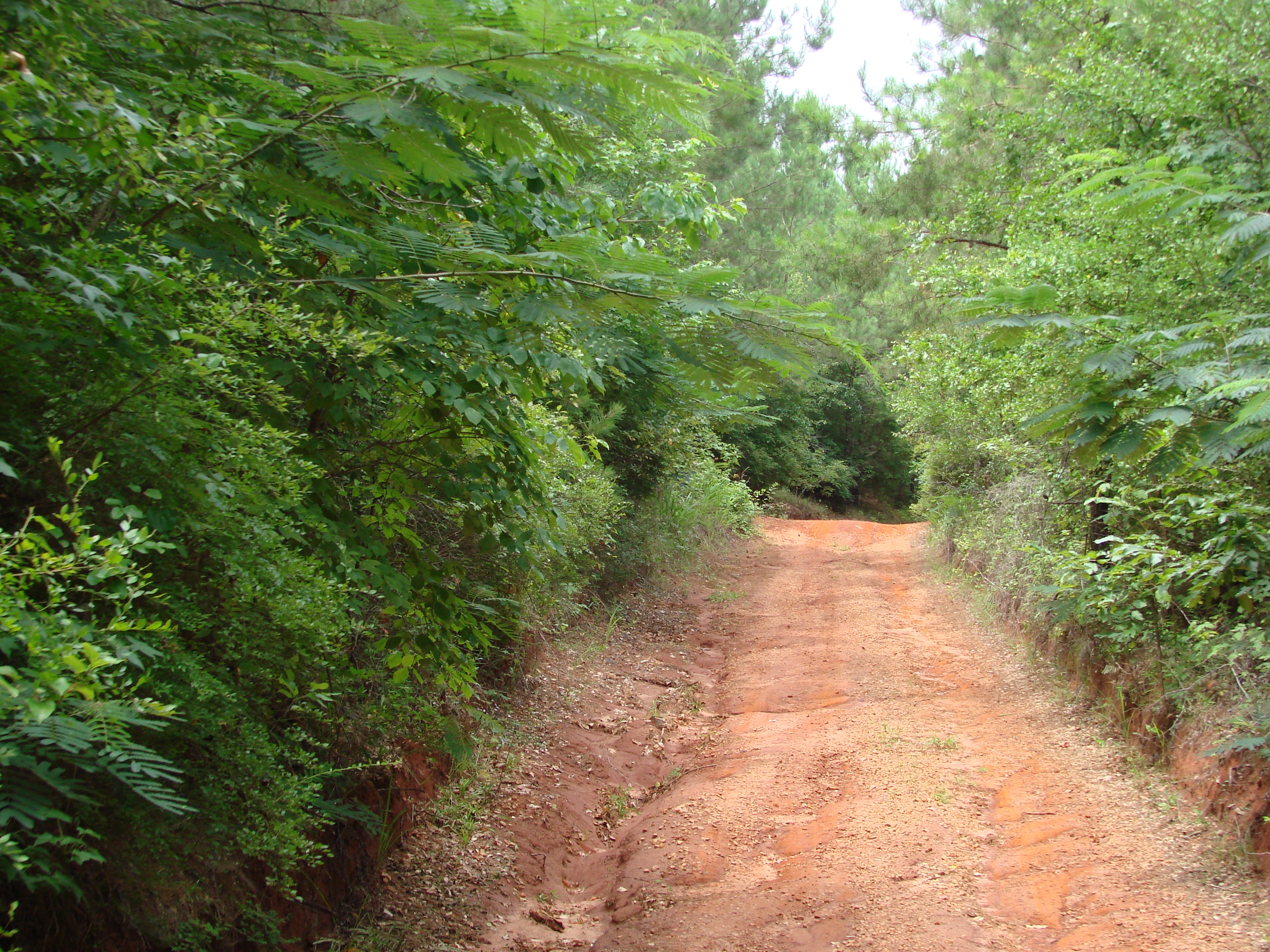

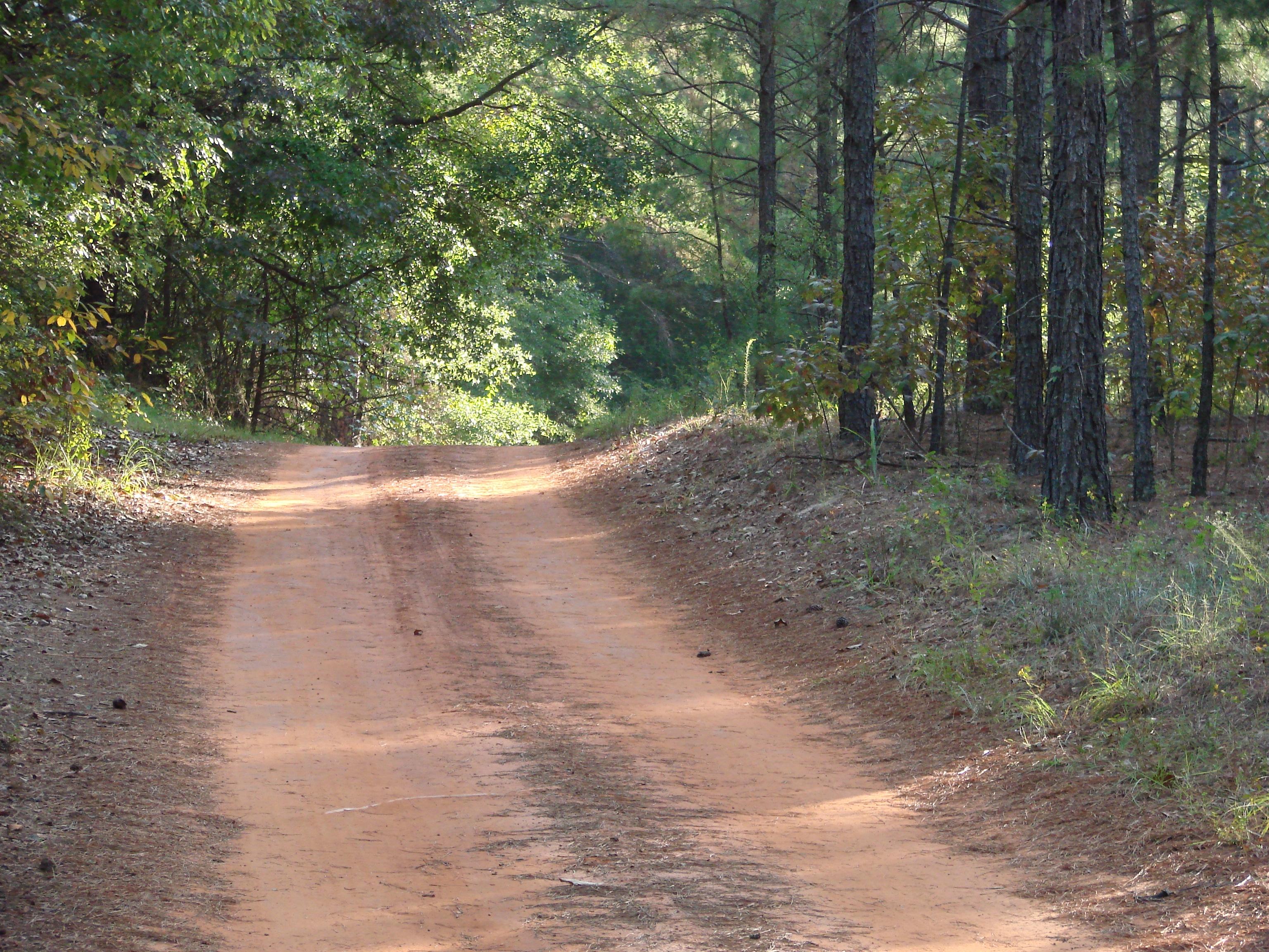

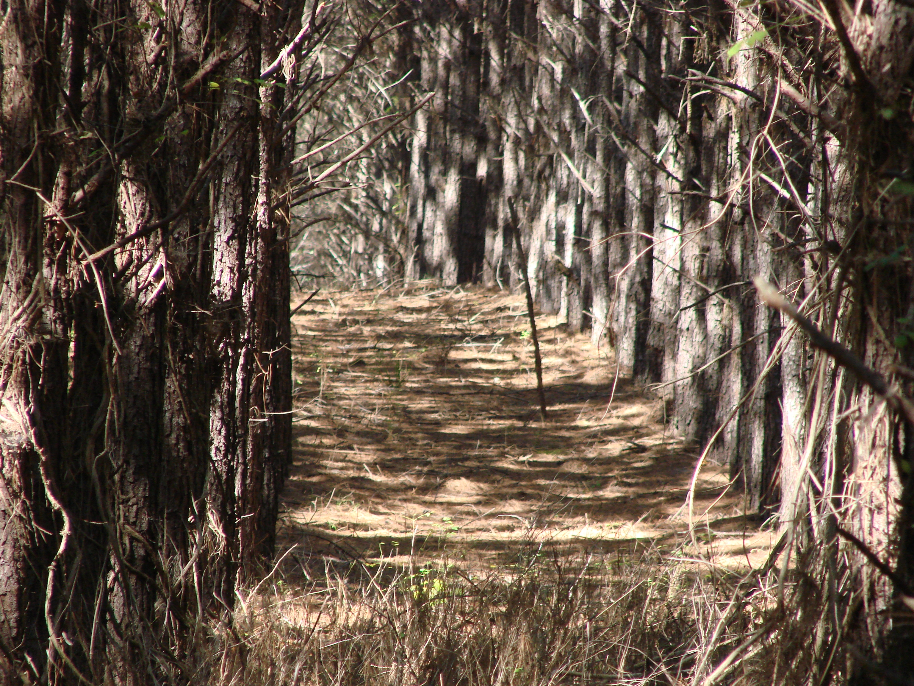

Hello all, I am new to this forum. I manage 4000 acres of timberland in middle Georgia for my family. We have miles of dirt roads that need attention and I need advice on the most versatile piece of machinery to do the forest tasks we have at hand. The machine needs to be able to do road maintenance and create firebreaks for prescribed burns. The third party contractors that we hire use primarily small bulldozers to create fire breaks and replant seedlings. My past experience is primarily with ag tractors so a bulldozer would be a steep learning curve for me. The other problem with a small bulldozer is that it would require an expensive upgrade for a capable trailer and truck to move the dozer for maintenance and repair. I am retired so I have plenty of time. We can hire a bulldozer to do road repairs but that can quickly become cost prohibitive hence my questions here. I have looked at the New Holland Woods Boss but they are $80,000 new and used ones have been beat to hell and back by right of way companies. The dozer could work roads and pull implements to create fire breaks but they are also expensive, ($70-$80K) and would require the truck and trailer upgrades. Are used dozers a good option? Ideas on where to look?

The most dangerous machine in the woods is a farm tractor. Timberland, 4000 acres? Get a cat with a drum, six way blade, and removable brush rake. quit trying to talk yourself out of one.

2) a dozer to create firebreaks. Large enough to push down trees by the root ball. Install a cage around the operators station to attempt to prevent limbs from entering. Also some attachments for breaking up the undergrowth

I agree with hslogger about the dozer with a 6 way blade. Roads need a crown to stay in any good shape. With the dozer you might need a forestry disk for firebreaks. Or...maybe not...the land I used to manage I used the services of the South Carolina Forestry Commission and their dozers. They can cut firebreaks at cost. Once done firebreaks are easy to maintain in the future. A removable rake up front would be needed. Loggers do not have the equipment to fix the roads nor the firebreaks. They tear everything up.
Here's a good start to get a plan:
Redbug's guidance is the most informed to date.
