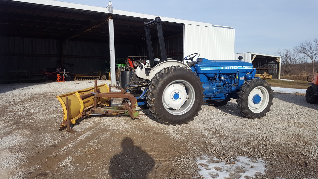

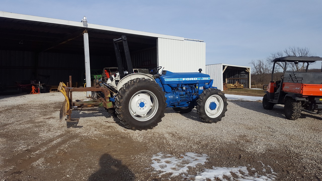

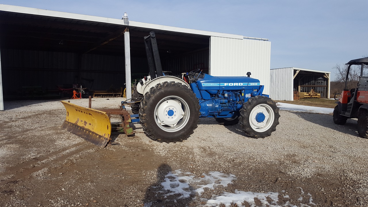

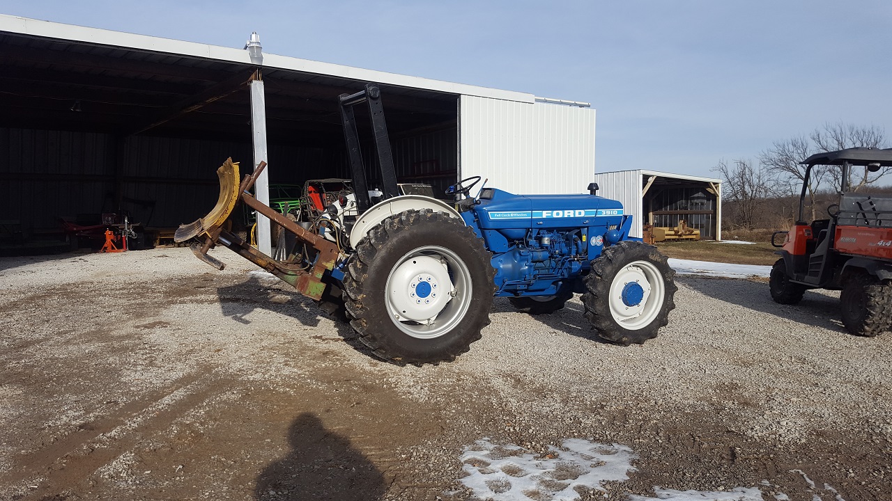

I converted an old Meyer snow plow to SSQA. I did it wrong. I built a rigid vertical pin for the plow to angle on. Used the two cylinders that were on the plow. This requires "float" on the FEL to be used. Too much weight. Requires large shoes. Still when plowing on unfrozen ground the shoes will track the driveway.
In a do over, I'd retain the Meyer system and let the plow hinge and carry it with a chain.
Live and learn.....
/ Best way to float SSQA plow? #5
I also added 3pt tabs so I could use it on my Ford. Ford has two circuits so am able to also use Hyd Top Link. Here's some pics that show the basic design. I might have overkilled the build a bit..... :)

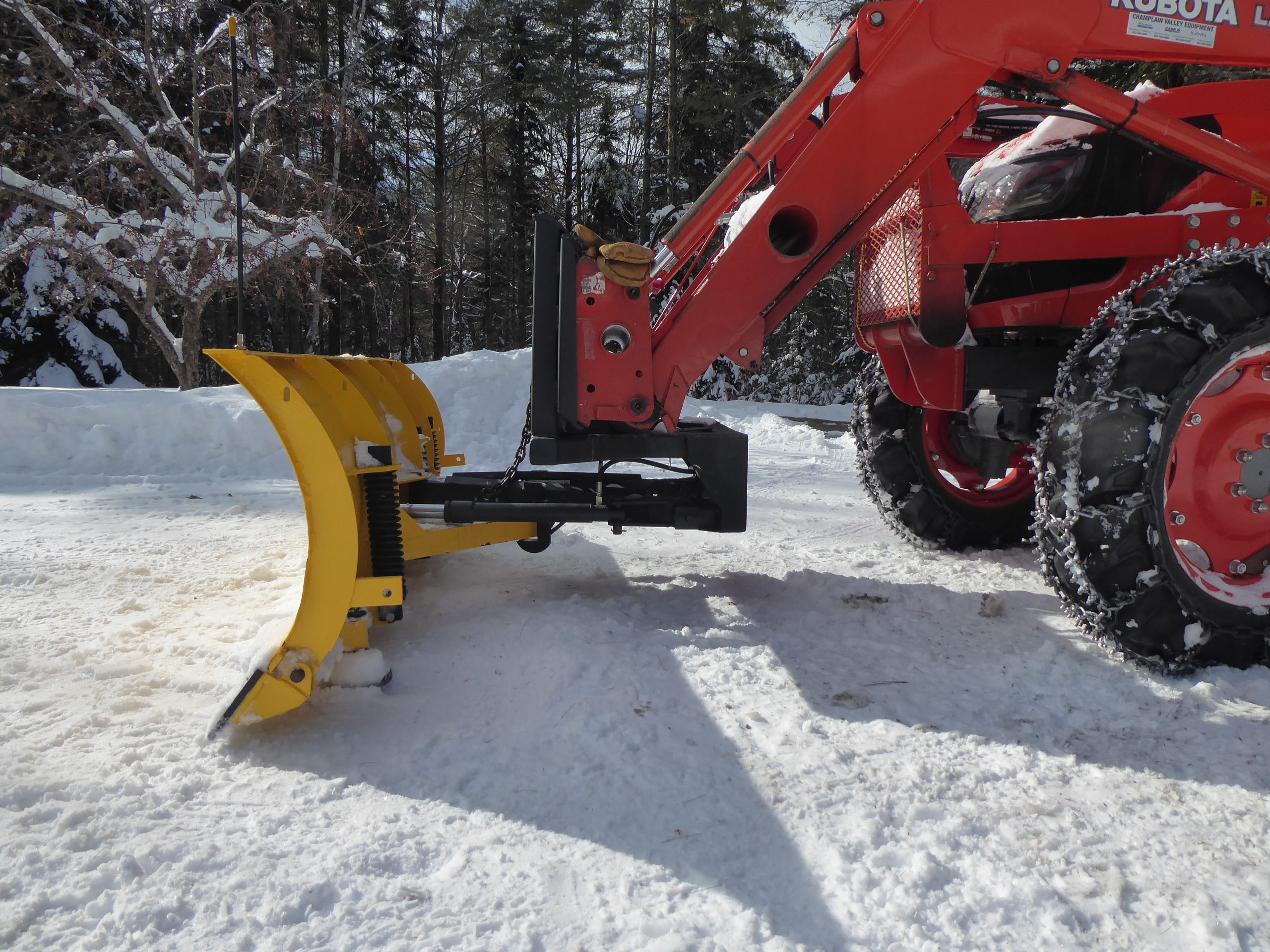

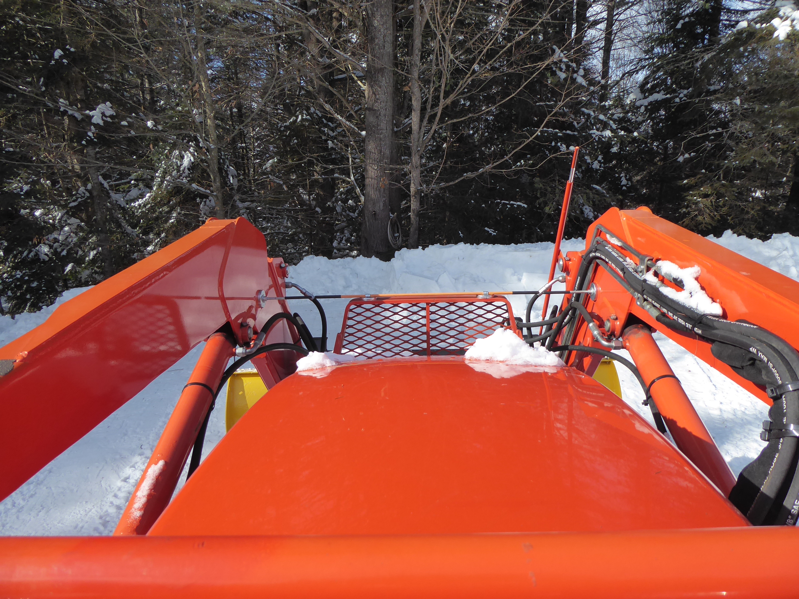

The best mods I've seen retain the Meyer system and let the plow hinge and carry it with a chain, but they have the bottom mounts (that the pins slide through) underslung (below and slightly behind the SSQA mounting plate). That keeps the plow closer to the tractor, and it will float with the chain, or you can lower the loader for down force.
Works for me. As mentioned before, bringing the blade closer to the tractor makes it less of a "rudder" in heavier snow. With the bottom trip edge on the Fisher plow there was an unexpected benefit. That was the ability to keep the mounting structure higher behind the blade. On one build found while doing research the guy had to add a couple skids on the frame to keep it from scraping the driveway because it hung so low.
It helps to have the ability to get the height of the loader arms repeatable where the frame of the plow is level with the surface of the driveway. Doing that keeps the edge of the blade flat on the surface being plowed whether the blade is straight or angled to either side. If the frame isn't level the blade wants to put one end down when angled.

Nice job :thumbsup: I think you will be happy with that. One thing I found out using mine was that it is easy to set the plow frame parallel to the road and at the right height working on the ground but not so easy from the seat. You need it set this way so that the cutting edge stays level when angled and for proper chain slack. I could start out plowing with it set correctly but after using the FEL controls and blade to push up and stack piles of snow it was tough to reset the blade for best performance from the seat because you cant see. With the under slung design the FEL height and SSQA angle effect each other, ie changing the SSQA angle also raises or lowers the height of the push beam and plow pins. To get a consistent setting I used some aluminum tape and a piece of heat shrink to make a line on the bucket level indicator to set the right SSQA plate angle and a couple magnet rods on the loader arms so I could set the FEL height.
gg
/ Best way to float SSQA plow? #20
I need to add that I neglected to say that I stole the use of magnetic markers idea show above from chim. I just adapted his idea to my tractor. Sorry.
