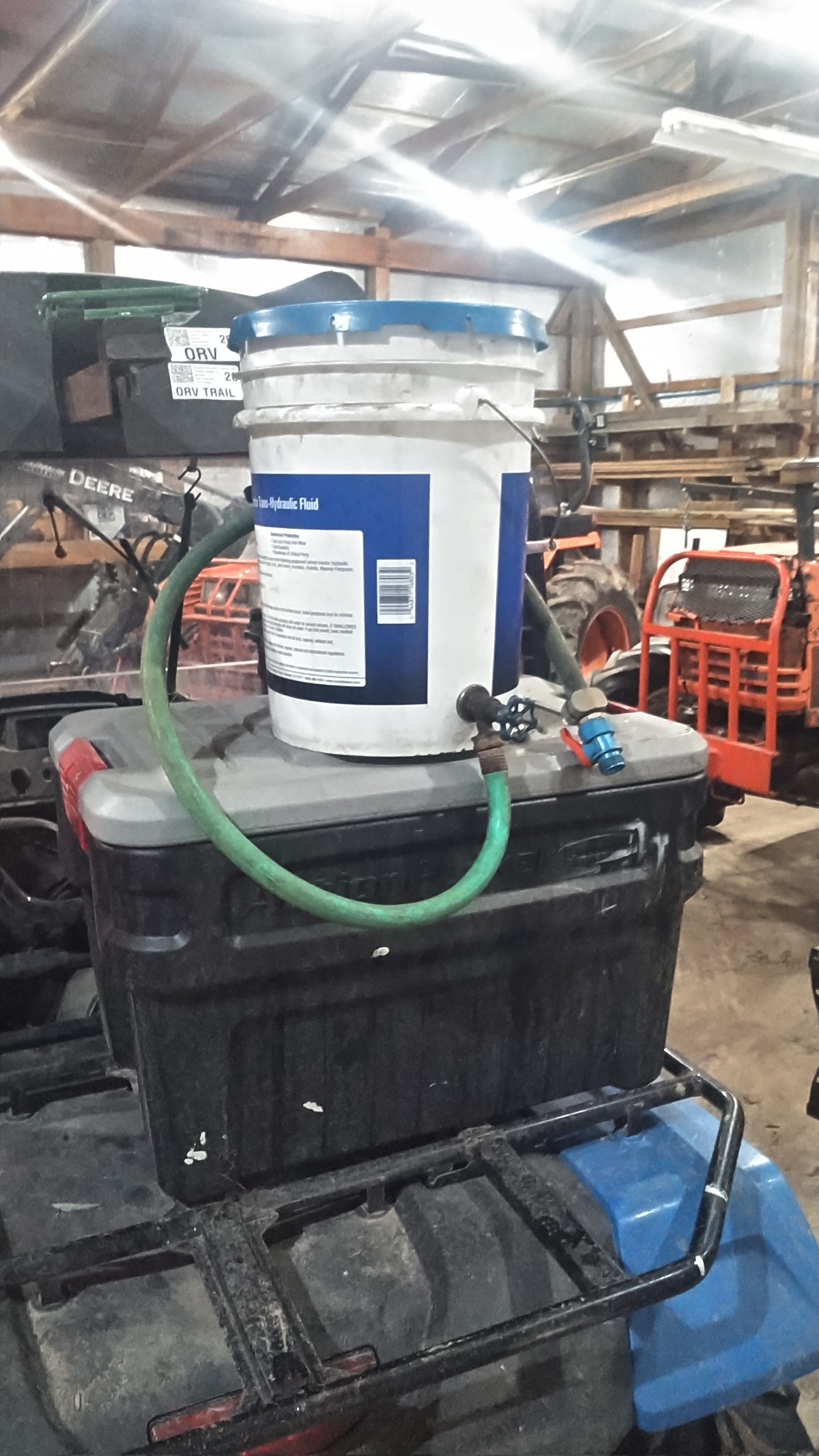

   / Best Way to Get Hydraulic Fluid into Tractor? #39
Made this awhile back with an old gate valve and hose. I used to run antifreeze thru boats to winterize. Easy to dump a five gallon pail into it when empty, plus it was nothing to make.
