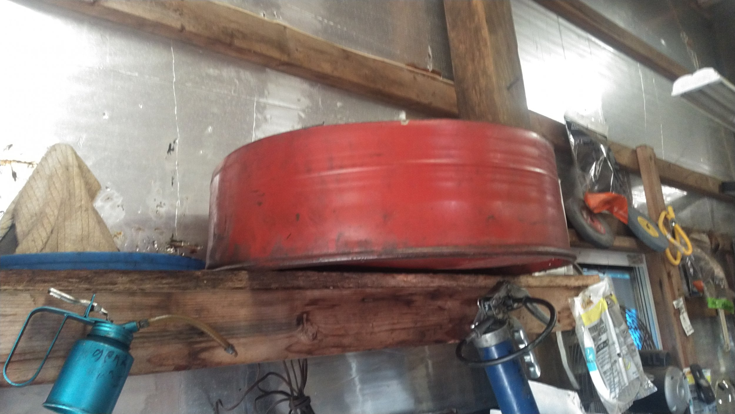

   / Best Way to Get Hydraulic Fluid into Tractor? #46
I cut the bottom section off an old unperforated 55gal drum for catching drain oil. Good idea using a mortar mixing tub though.
