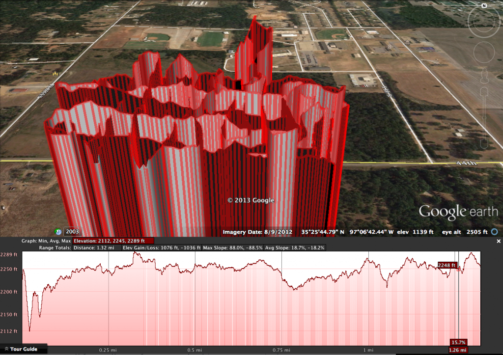

I would not trust an iphone gps for grading. As far as I know (unless it has changed) any consumer grade gps is only considered accurate to 3 meters for coordinates. I doubt altitude is any better.
As mentioned, it would be better to borrow/rent a laser.

I have ruled out the iphone GPS. I walked the land in a grid pattern recording with an iphone GPS app. I then opened it in Google Earth and measured differences in intersecting points to check pass-to-pass accuracy. Many were over 10' off from each other. I would like to have +/- 6" height accuracy in a 20'x20' grid.
I am not going to be grading by these measurements. I only want to make a 3D model for me to mess around with.

Here is a screenshot from Google Earth. For some reason all waypoints were 1100' over actual elevation... so the track appeared to be a skyscraper lol. Hopefully you can see what I mean by the pass-to-pass inaccuracy.
